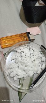

3 medicine boxes produce clean white needles
