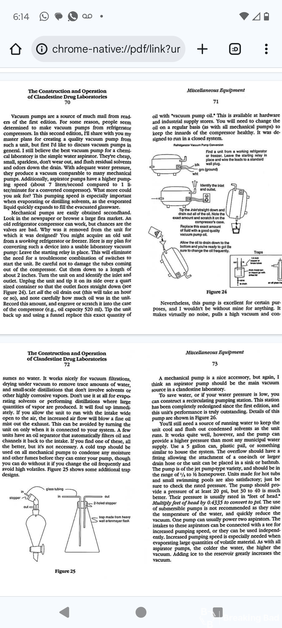

Uncle Fester
Calibrating the Vacuum

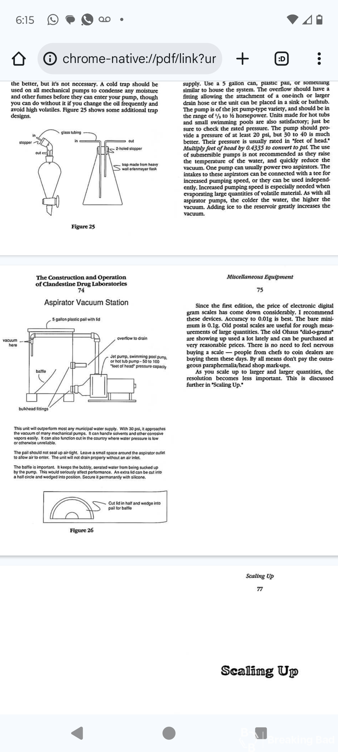

Info about different types of vacuum pumps

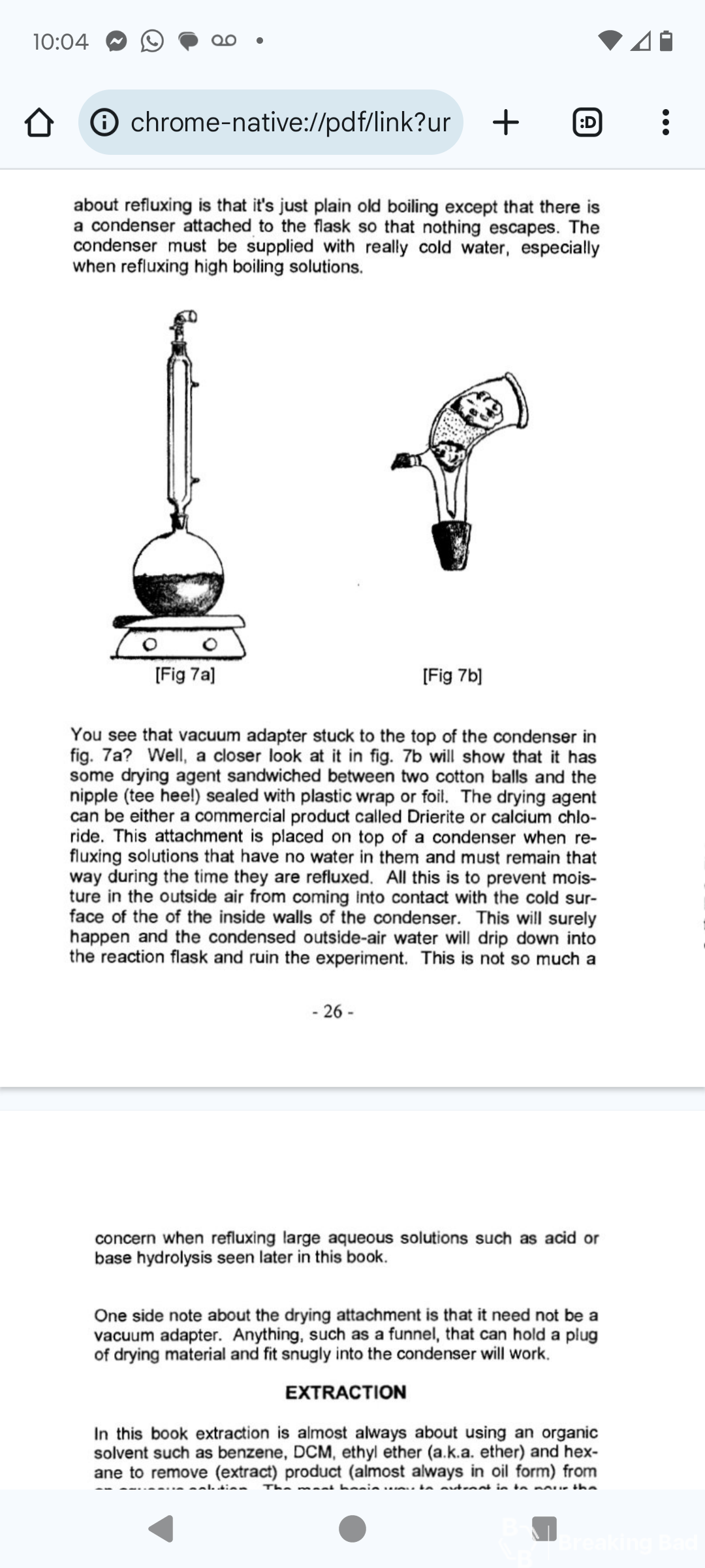

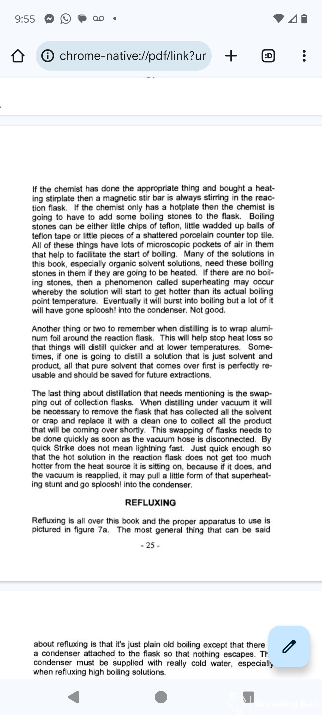

Strikes 2 cents on distillation
GREAT INFORMATION ESPECIALLY FOR PEOPLE GETTING STARTED IN THIS ENTERPRISE
* And an extra additional page about refluxing

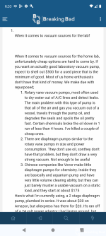

Great info about vacuum pumps
Credit goes to Jack B. Nimble

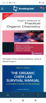

Zubrick on Vacuum Distillation
Vacuum Distillation Notes
