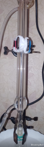

I could ... after a lot of time, I found an opportunity to do it, cheers comrades
Isomerization
Reagents - KBD (0.5 grams), isopropanol (5 ml, 99.97%) ( *1), acetic acid (0.5 ml 70% (in water) ( *2)
I put 500 mg of the KBD into a rounded flask (10 ml), I put 5 ml of isopropanol, I put this flask on an oil bath, heated to 76-78 Celsius ( *3), after five minutes I add 0.5 ml of acetic acid. I insert a reverse refrigerator(I'm not sure the translator understands what this is. I'm translating from russian to english). After 4 hours - the mixture turns yellow a bit, after 10 hours the mixture is yellow - I remove flask from heating.
Selection and cleaning
Reagents - food soda NaHCO3 (1 g), salt (~ 3-4 grams)
The yellow mixture is poured into a chemical cup, and I add 5 ml of water and 1 grams ( *4) of baking soda. We wait for the ending of CO2. I pour the mixture into the test tube, add salt. We wait for alcohol canceling, the upper layer is yellow, a mixture of alcohol, canbinoids and water - decantation. We evaporate the mixture, a few drops of water and brown oil remain. We discard water, leave the oil
Preparation of vape
Reagents: propylene glycol, glycerin (it is useless ... oil not solvent in this (wtf?!))
I dissolve the oil in 5 ml of propylene glycol. After a day I smoke this on a vape with a drip
Smoking
I smoked 1 ml of the prepared solution - the throat is slightly painful, acetic acid (a little bit) is felt. There is psychoactivity - but weak. The appetite has improved, everything seems tasty, slightly drying his eyes and mouth, the perception of time was distorted - in general, sober.
Conclusions
I think 10 hours for isomerization in isopropanol is not enough. I need more. But I can’t follow more than 10 hours in the mixture. I think to try to put for 10 hours, to pause a day, return, start again for 10 hours. Because of my employment and because of problems in my country, I cannot follow this for a long time.
*1 - EtOH with concentration higher 40% impossible to buy in my country
I was surprised by this fact myself, but it is really impossible to buy pure ethyl alcohol in a concentration higher than 40% here... we can find 70% in a pharmacy, but it is a mixture with medical drugs.. We have a strange anti-alcohol policy (vodka, balalaika and brown bear)
*2 - I cant get 100% acetic acid.
No... I can! But I am lazy to do it in my home (AcONa + H2SO4(98%<) => ... + AcOH ~100% )
*3 - the oilbath is heated to 78, but inside the flask it is stable 70. I checked it with a mercury thermometer
*4 - I think that 1 gramm to little... need more to remove AcOH.... Why I didn't use NaOH solution in water - sodium hydroxide somehow gets into the oil anyway. I wouldn't smoke it. Although I smoked with acetic acid and it seemed fine..... I'm pathologically afraid of alkali (yes-yes, says the guy who has a bag of this alkali at home)
What do you think about this experiment?
