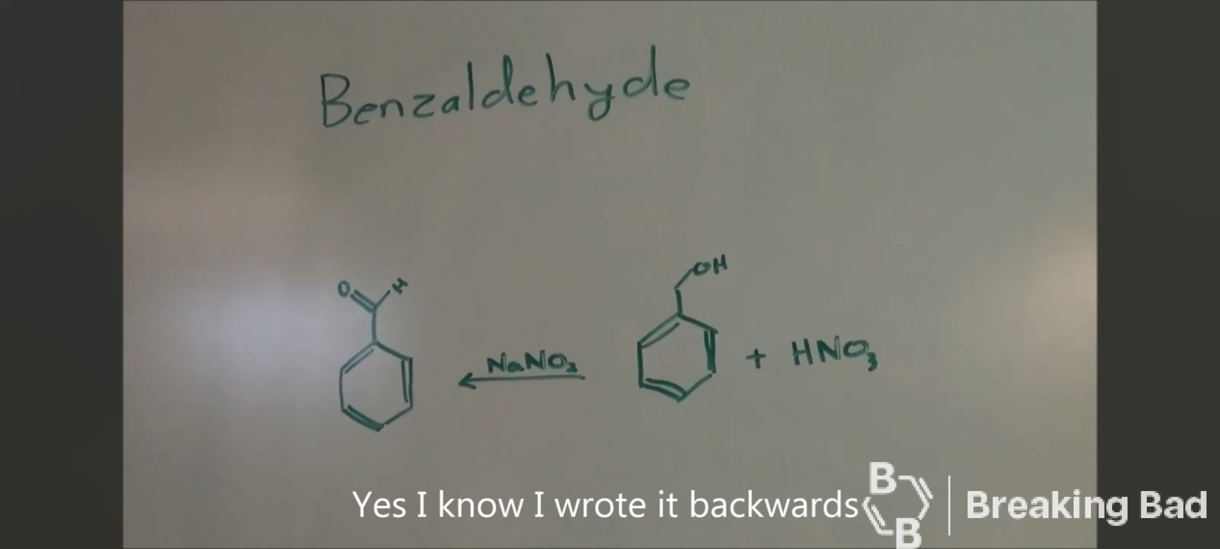

So the ratios are 100 ml D-H20 . Pour in 25 ml of high concentrate %60-75% nitric acid. Then, pour in 2 grams of sodium nitrite (catalyst) dilated with 5 mls D-H20 slowly. DON'T FREAK OUT NOR BREATH THE BROWN NITROUS FUMES COMING OFF ! Add 80 ml of benzyl alcohol. Then, reflux a low 75C-90C for 4 hours.

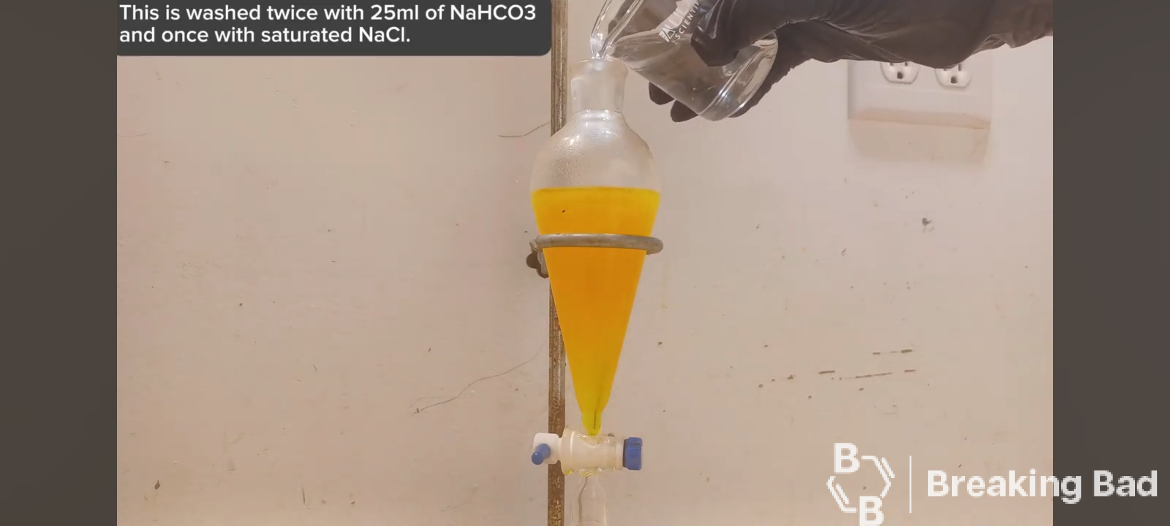

Separate with a separatory funnel . Do a sodium bicarbonate (baking soda OTC) washing 1 - 2 times
*A color change to an orangish color and a change from bottom layer to a top layer may be noted *** KEEP WATCH AND MAKE NOTE OF ANY CHANGES **
Do a table salt brine wash
Do a water wash
Dry with anhydrous Magnesium Sulfate
Filter
