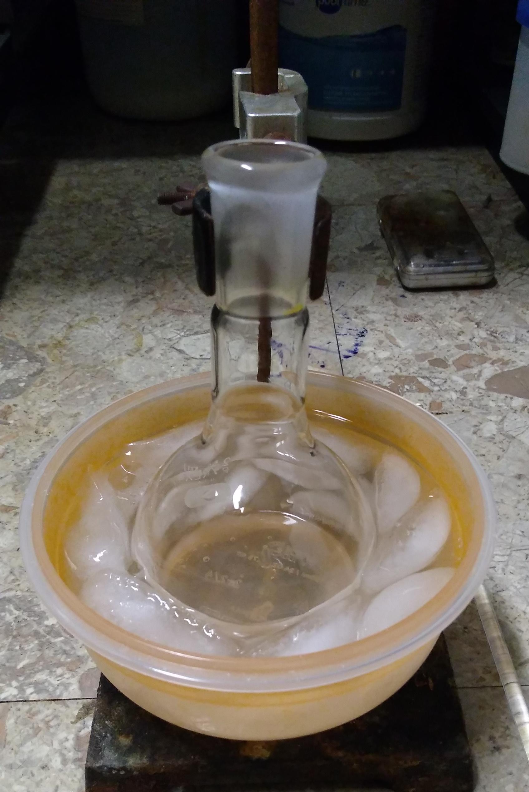

50 g (714 mmol) of 90% nitric acid (density 1.48 g/ml) were placed in a 250 ml round-bottom flask. The nitric acid was cooled in a salted ice bath (-10 °C) and a couple of ml of benzyl alcohol (technical grade or better) were added to the flask using a Pasteur pipette.

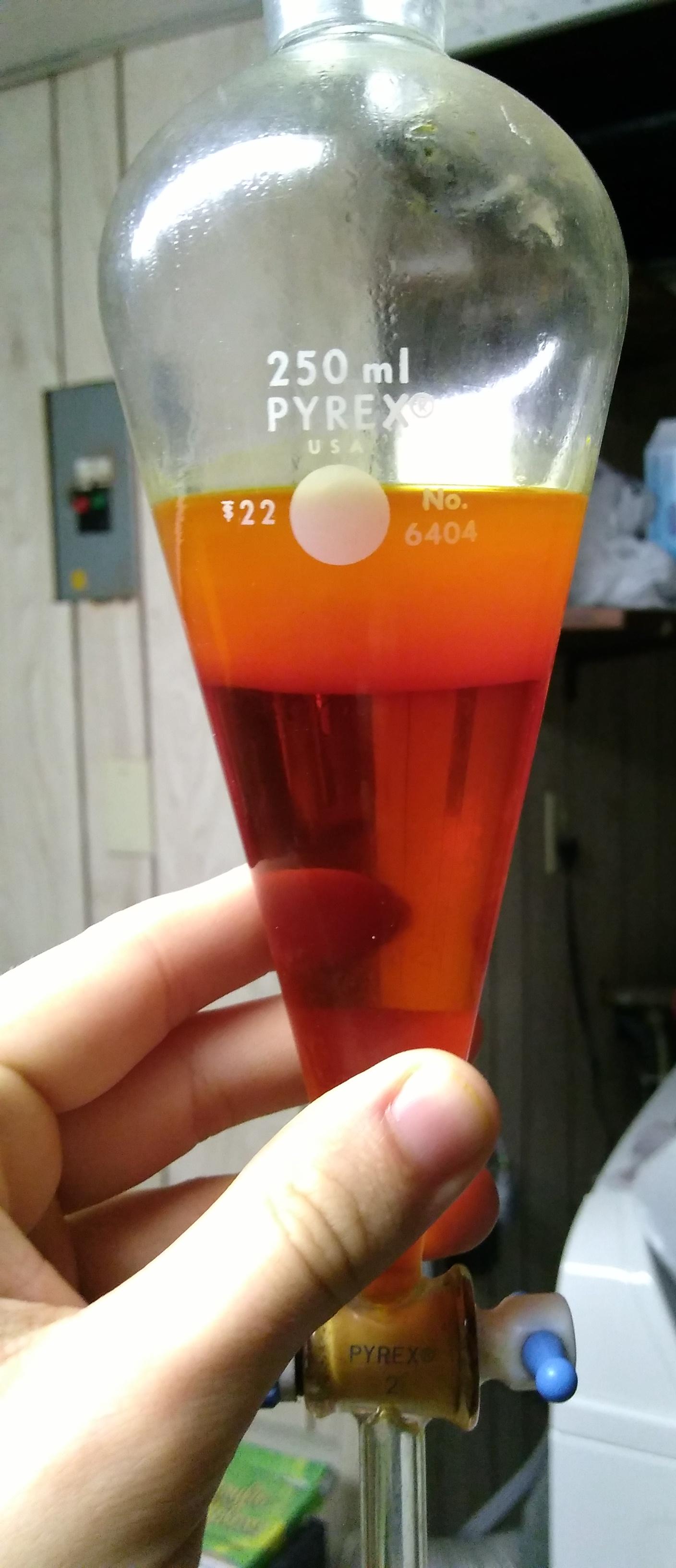

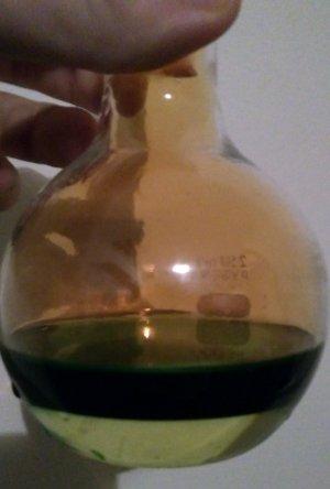

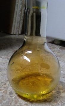

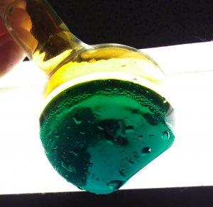

The flask was manually swirled by hand to mix the reagents, and an immediate change in color from pale yellow to a bright yellow-green was noted. As more benzyl alcohol was added, an upper layer separated and the color of this gradually deepened to an intense blue-green. The release of brown nitrogen oxide vapors was also noted. The classic almond extract of aroma was already heavy upon the air between additions by this point.
Upon each further addition of benzyl alcohol and with stirring of the mixture, the color disappeared and became milky yellow, but after being allowed to react, the blue color returned; the color change was used to follow the reaction, with each addition of benzyl alcohol occurring after the upper layer had regained the unusual coloration. With some difficulty, I managed to get enough light passing through the deep green mixture for a picture.
VMUe6Qdgp2
BGgnzOAXwR

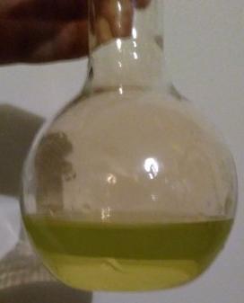

A total of 66 g (610 mmol) of benzyl alcohol were added over the course of about 4 hours. While an ice salt bath was used to regulate temperature at the beginning of the experiment, as the reaction continues, and the concentration of nitric acid falls, the reaction slows significantly and it is sufficient to carry out the last third or so of the reaction at room temperature. For a reason to avoid benzyl alcohol contamination of the synthesis product, addition of benzyl alcohol ceased when the blue-green color didn't return, at least to its full strength, after allowing the reaction mixture to sit for a period of 30 minutes.
AAMFhnzG8u
J8QiyFu2xB

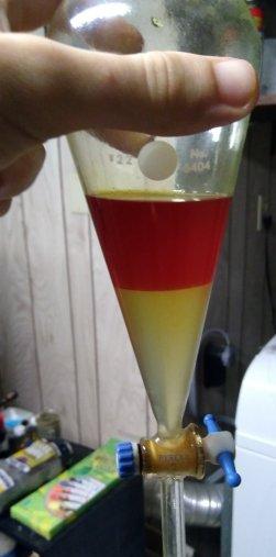

After being left to sit overnight (I recommend you to stir overnight, if it is possible) in an airtight container, the two-layer mixture was placed in a separatory funnel (250 ml) and the lower aqueous layer removed. The top layer was washed twice with saturated sodium bicarbonate solution, followed by distilled water, and finally partially dried with a wash of saturated sodium chloride. The pale green upper layer as well as the aqueous layer became immediately red-orange in color after the sodium bicarbonate solution was added for the first time, though the color of the aqueous layer is noticeably less with each successive wash. The brine wash came out colorless, though the benzaldehyde layer is still strongly colored.
DvB7tkImQc
XTaBL0P7vf

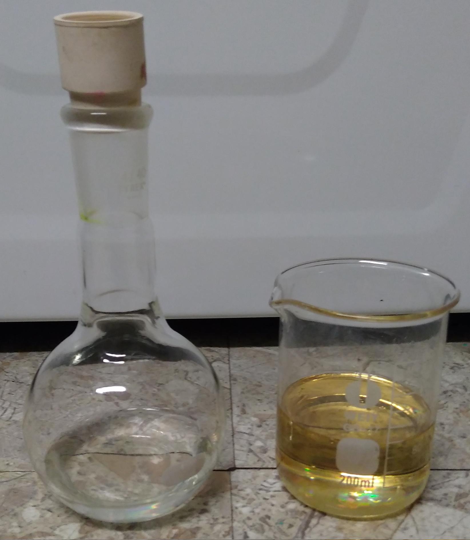

The crude benzaldehyde, a translucent reddish-orange liquid, was placed into a pre-weighed container with a little anhydrous sodium sulfate (NaSO4) and the weight was recorded as 55.3 g. If pure benzaldehyde was assumed, this would correspond to an 85% yield (dirty)! Upon prolonged storage over the sodium sulfate, the color actually lightened to a golden yellow color, though this isn't pictured.
Discussion
GC-MS analysis has shown chromatogram which was contained 3 major peaks. The largest peak, benzaldehyde, was measured at 92% of the peak area, with an additional peak for residual benzyl alcohol making up another 3%. The final yield of this synthesis in pure benzaldehyde came out to about 79%. This synthesis may be scaled up easily. I strongly recommend to use vacuum distillation before utilizing this substance in further syntheses.

I never got that green colour. I don't believe this method is the easiest setup for this synth. See my simplified version.
