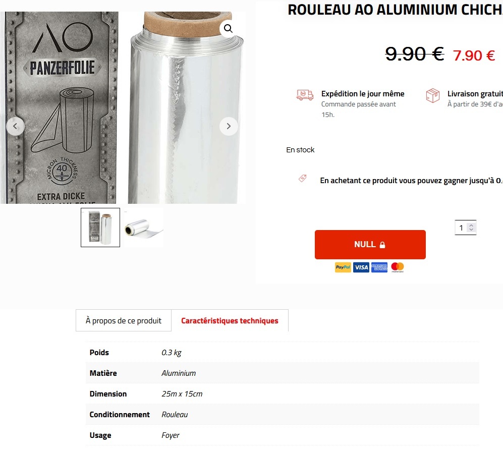

I just discovered aluminum foil for shisha / hookah ...
40µ but I don't know if it's 100% aluminum

I searched for shisha suppliers but I can't find any reliable info. I believe they are alloy mixtures.
but... I found this site, you can choose the size, hardness, etc...
Alloy : EN-AW 1050 A (Al 99,5) i think it's the good one
but it looks expensive to me

soo, like this one is perfect ?
UbCoF5dJiQ
sorry but i still need to be reassured :)
i have ordered HgNO3 but but the package takes a long time... so I'm planning another plan just in case
