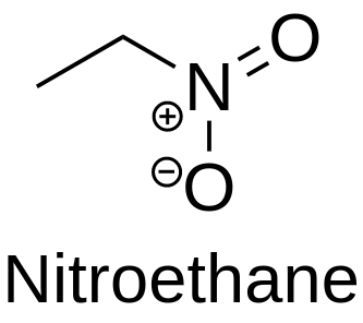

    Nitroethane is an organic compound having the chemical formula C2H5NO2. Similar in many regards to nitromethane, nitroethane is an oily liquid at standard temperature and pressure. Pure nitroethane is colourless, and has a fruity odor. In clandestine synthesis nitroethane is used as precursor for Phenyl-2-nitropropene in Henry reaction.
    Physical properties
    • CAS Number: 79-24-3;
    • Chemical formula: C2H5NO2;
    • Molar mass: 75.067 g/mol;
    • Density: 1.0448 g/cm3 at 25 °C;
    • Melting Point: -89.5 °C;
    • Boiling point: 114 — 115 °C (237 °F; 387 K) ;
    • Appearance: oily liquid;

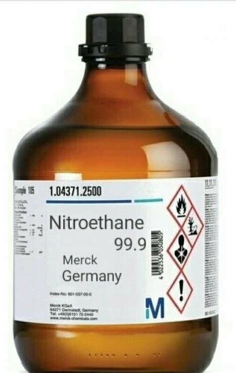

    Certain superglue removers (OTC) contain nitroethane, though the amount is small. Nitroethane is sold by chemical suppliers, however, since it's a drug precursor, it's extremely difficult for the amateur chemist to acquire this compound. In US nitroethane is a DEA List I [1] chemical and individuals cannot purchase this compound. Isn't controlled in European union [2].
    Nitroethane is most commonly used as a solvent for artificial polymers such as styrene, and particularly for dissolving cyanoacrylate adhesives. It has been used as a component in artificial nail remover and in overhead ceiling sealant sprays, although it is not common in such applications. Nitroethane is also used as a fuel additive for increasing the octane rating of gasoline, as a pure fuel in certain drag racing vehicles, and as a propellant. In addition, nitroethane finds use as a reagent in various chemical syntheses, primarily in the production of pharmaceutical compounds.
