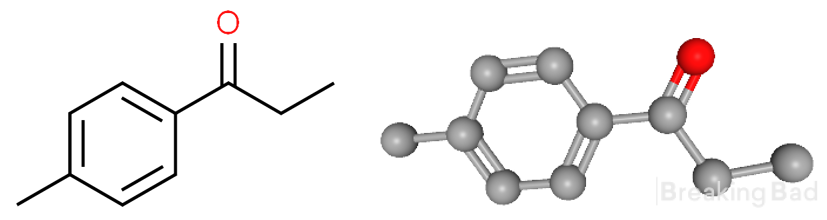

    Structural formula of 4'-methylpropiophenone

    4'-Methylpropiophenone (CAS № 5337-93-9), is an aromatic ketone that is propiophenone bearing a methyl group. Functionally it is similar to propiophenone. The chemical properties of 4'-methylpropiophenone are provided by the benzene ring and carbonyl group. The carbonyl group gives ketonic characteristics to the molecule. The physical properties of 4'-methylpropiophenone include its melting point, boiling point, density, and solubility characteristics.
    4'-Methylpropiophenone is an organic compound with the chemical formula C10H12O and a molecular weight 148.2 g/mol. This is colorless or light-yellow liquid, with a light sweet odor or odorless. Its density is 0.993 g/mL at 25 °C. 4'-Methylpropiophenone have flash point 108°C, and boiling point 238-239 °C. Melting point of 4'-methylpropiophenone is 7°C. Soluble in organic solvents such as chloroform and hexane, slightly soluble in water (0.332 mg/ml).

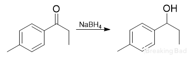

    Reduction reactions enable the conversion of the carbonyl group in 4'-methylpropiophenone to yield secondary alcohols, expanding its synthetic versatility. Common reducing agents include sodium borohydride (NaBH4).
    Example: Reduction of 4'-Methylpropiophenone with NaBH4 yields 1-(4-methylphenyl)-1-propanol, a valuable intermediate in pharmaceutical synthesis.
    Synthesis of 1-(4-methylphenyl)-1-propanol from 4'-methylpropiophenone

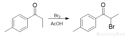

    Halogenation is a common reaction used with this compound. The synthesis of 2-bromo-4'-methylpropiophenone is easily achieved by simply brominating 4'-methylpropiophenone with an equivalent amount of bromine, similar to the synthesis of bromo propiophenone. 4'-Methylpropiophenone is dissolved in glacial acetic acid and bromine is added to form an oil fraction of 2-bromo-4'-methylpropiophenone.
    Example: Halogenation of 4'-methylpropiophenone with bromine yields 2-bromo-4'-methylpropiophenone, an intermediate in the synthesis of 4-methylmethcathinone (mephedrone).
    2-Bromo-4'-methylpropiophenone synthesis from 4'-methylpropiophenone
    The chemical activity of 4'-methylpropiophenone includes a spectrum of transformations, each of which offers unique opportunities for the synthesis of valuable intermediates and target molecules. Using these chemical reactions and examples, researchers can explore the applications of 4'-methylpropiophenone in pharmaceuticals, synthetic chemistry, and industrial processes.
    Synthesis of 2-bromo-4'-methylpropiophenone from 4'-methylpropiophenone
