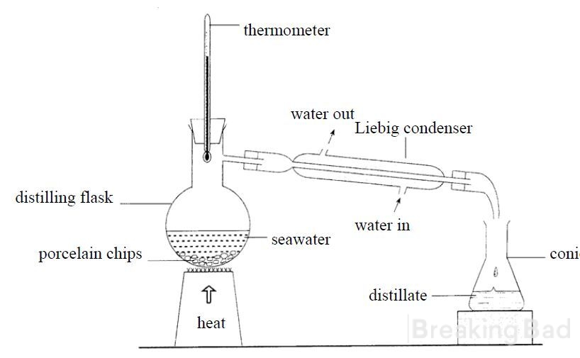

  • Concurrent condensers: These condensers receive the vapor through one inlet and discharge the liquid through another outlet, as commonly used in simple distillation setups. They are typically installed in a vertical or tilted orientation, with the vapor input located at the top and the liquid output at the bottom.
ZMHIhUR63G
Scheme of concurrent Liebig reflux condenser

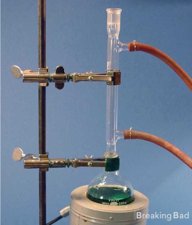

  • Countercurrent condensers: These condensers are designed to direct the liquid back towards the vapor source, as required in reflux and fractional distillation processes. They are usually mounted vertically above the vapor source, which enters from the bottom. In both cases, the condensed liquid is allowed to flow back to the source under the force of gravity.

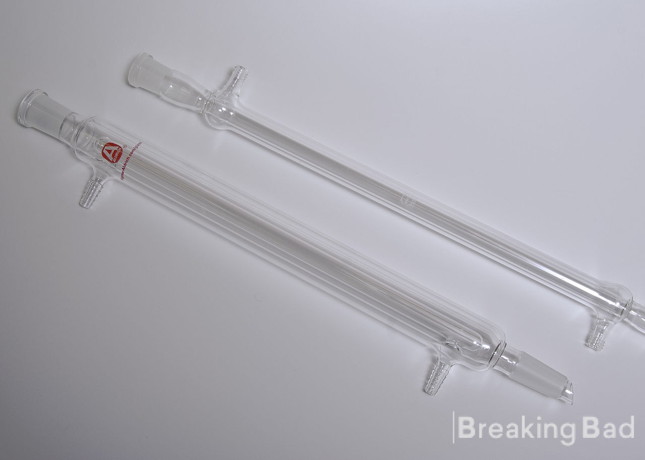

Note: The Liebig condenser, named after Justus von Liebig, is a straightforward design that utilizes a circulating coolant. It offers simplicity in construction and affordability. Liebig refined an earlier design by Weigel and Göttling and popularized it in the field. The condenser comprises two concentric straight glass tubes, with the inner tube being longer and extending beyond both ends. The outer tube is sealed at the ends (typically using a blown glass ring seal), creating a water jacket. It is equipped with side ports near the ends to facilitate the inflow and outflow of cooling fluid. The ends of the inner tube, through which the vapor and condensed liquid pass, remain open.
In comparison to a basic air-cooled tube, the Liebig condenser demonstrates superior efficiency in removing the heat generated during condensation and maintaining a consistently low temperature on its inner surface.

Condensers widely used in clandestine laboratories in numerous syntheses such as Methamphetamine synthesis from P2P via Aluminum amalgam, Methamphetamine synthesis from P2P by NaBH4 reduction. Medium-Scale, Amphetamine synthesis from P2NP via Al/Hg (video), Complete MDMA synthesis from Sassafras oil with Al/Hg, 1-Phenyl-2-nitropropene (P2NP) video synthesis from benzaldehyde and nitroethane and many other in order to condensate solvent vapours into a reaction vessel. A reflux condenser is installed onto a reaction vessel and cold water source is connected to the bottom inlet tap via silicone (or rubber) hose. Outlet hose is attached to the top outlet tap.
OYLfSvj4yt
You can use a bucket with ice and water with aquarium pump for this purpose. In case of a large scale synthesis or a necessity of more efficient cooling source, you can use laboratory chiller. Chillers are machines that remove heat from a liquid via a vapor-compression or absorption refrigeration cycle. This liquid can then be circulated through a heat exchanger like reflux condenser to cool down solvent vapours.

Tüm saygımla, bir Liebig veya West kondansatörü bir reflü kondansatörü için mükemmel olmaktan uzaktır, özellikle üstte bir nozul veya başka bir kısıtlama olmadan çıplak çıplak olduğunda bir baca görevi görür, zaten küçük bir deliği olan bir mantar çok yardımcı olacaktır. Reflü için bir Friedrichs veya Intensiv kondansatörü istiyorsunuz, örneğin soğutma suyunun bir spiralin içinden geçtiği bir kondansatör (Intensive'in ek bir su soğutma ceketi vardır).

yeah dimroth condenser is the best for reflux
