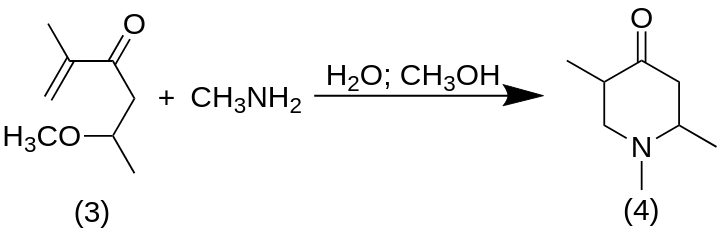

The silylation of (1) by a mixture of trimethylchlorosilane and NaI in the presence of Et3N in MeCN leads to the formation of 2-trimethylsilyloxy-3-methyl-1,3-butadiene (2) in an 82.3% yield. By carrying out the reaction in a MeCN solution with addition of NaI, it is possible to increase considerably the yield of the desired silyloxy-diene (2) in comparison with. We found that the addition of acetaldehyde acetals to (2) in the presence of ZnCl2 as catalyst proceeds under the conditions of a 1,2-dienic system with the formation of 5-alkoxy-2-methyl-1-hexene-3-ones (3) in a yield of 60-68%. The latter, when reacted with MeNH2 in an aqueous-alcoholic medium, readily convert into ketone (4). It was noted that a methoxy derivative (3) reacts readily with MeNH2., forming piperidone (4) in a 72-80% yield. A new improved three-step path of synthesis of (4) starting from methyl isopropenyl ketone with an overall yield at the 3rd stage of 40-44% was developed.

1,2,5-Trimethyi-4-piperidone (4)
A mixture of 3.4 g (0.024 mole) of (3), 5 ml of a 20% aqueous solution of MeNH2 (0.032 mole) and 3.5 mL of MeOH was heated in a sealed ampule (or tightly closed flask) at 60°С in water bath for 4 h. The mixture was then cooled, acidified with 18% HCl to an acid reaction, MeOH was evaporated off under a slight vacuum, and the reaction mixture was extracted with ether to remove neutral products. The mixture was then cooled and treated with a solid alkali (NaOH/KOH), and extracted thoroughly with ether. The ether extract was dried over MgSO4. After distillation, 2.4 g (71.2 %) of (4) was obtained, bp 82 С (10 mm Hg).
