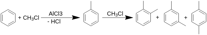

1. Firstly, we are assembling the installation for toluene synthesis. First step is assembling the device for hydrochloric acid gas synthesis. A two-neck round bottom flask connected with a drip funnel with sulfuric acid (H2SO4) (control the amount of gaseous hydrogen chloride). Place sodium chloride (NaCl) on the bottom of the flask and place this flask on a heating mantle. We connect the outlet from the flask through a calcium chloride tube and through a glass tube we introduce it to the bottom of the second two-necked round bottom flask.
C63eLRwhxf

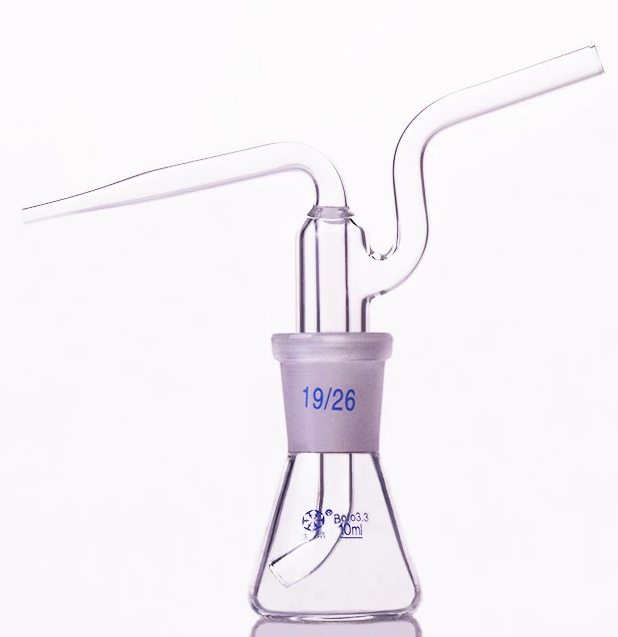

2. Place the second flask in the heating mantle and pour methanol (CH3OH) (dried with magnesium or copper sulfate) into the flask. Add some anhydrous zinc chloride (ZnCl2). We connect a reflux condenser to the second neck of this flask and connect its outlet with a flush flask filled with concentrated sulfuric acid.
ILSzyF4hrR
3. Connect the outlet from the wash bottle to a calcium chloride tube, and then connect it to a glass tube touching the bottom of the third two-necked flask.
4. Pour 500 ml of benzene into the third flask, add 92 g of anhydrous aluminum chloride (AlCl3) and close the throat with a reflux condenser, the outlet of which is connected to a water-jet pump.
5. We turn on the apparatus by turning on the heating of benzene and methanol. As soon as the methanol starts to boil, open the drip funnel with sulfuric acid and start generating hydrogen chloride gas. Hydrogen chloride dried through calcium chloride tube, getting into boiling methanol in the presence of ZnCl2 catalyst forms monochloromethane gas (CH3Cl). Dried monochloromethane gas enters the flask with benzene and forms toluene by the Friedel-Crafts alkylation mechanism in the presence of AlCl3 catalyst.
19eiKCtx2X
6. The reaction must be controlled in time 6-8 h, since the yield of products from a certain moment begins to sharply shift towards xylenes (dimethylbenzenes).
MJiD8pQlBg

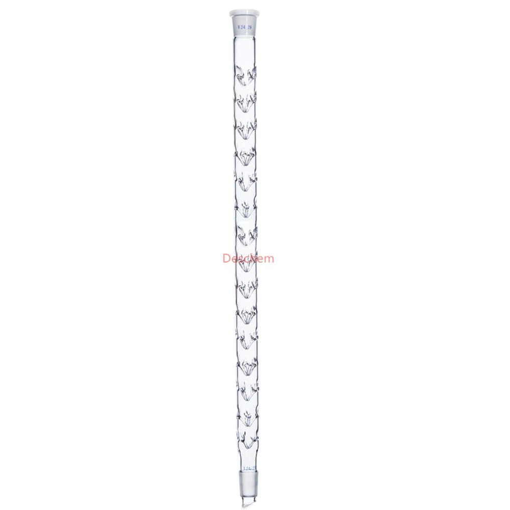

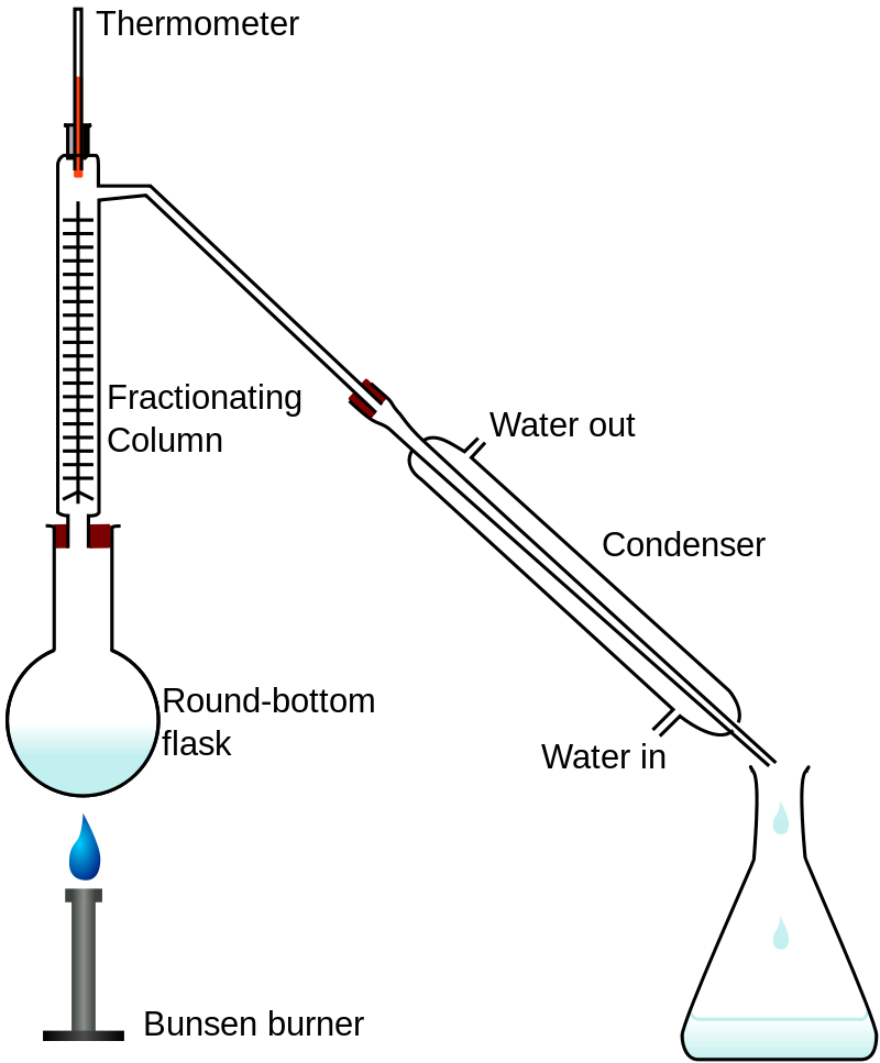

7. After reaction termination, the mixture of benzene, toluene and xylenes must be distilled with a vigreux column. The system is rather complex - polyazeotropic, which makes it quite difficult to obtain pure substances by multiple distillations with high vigreux column.
