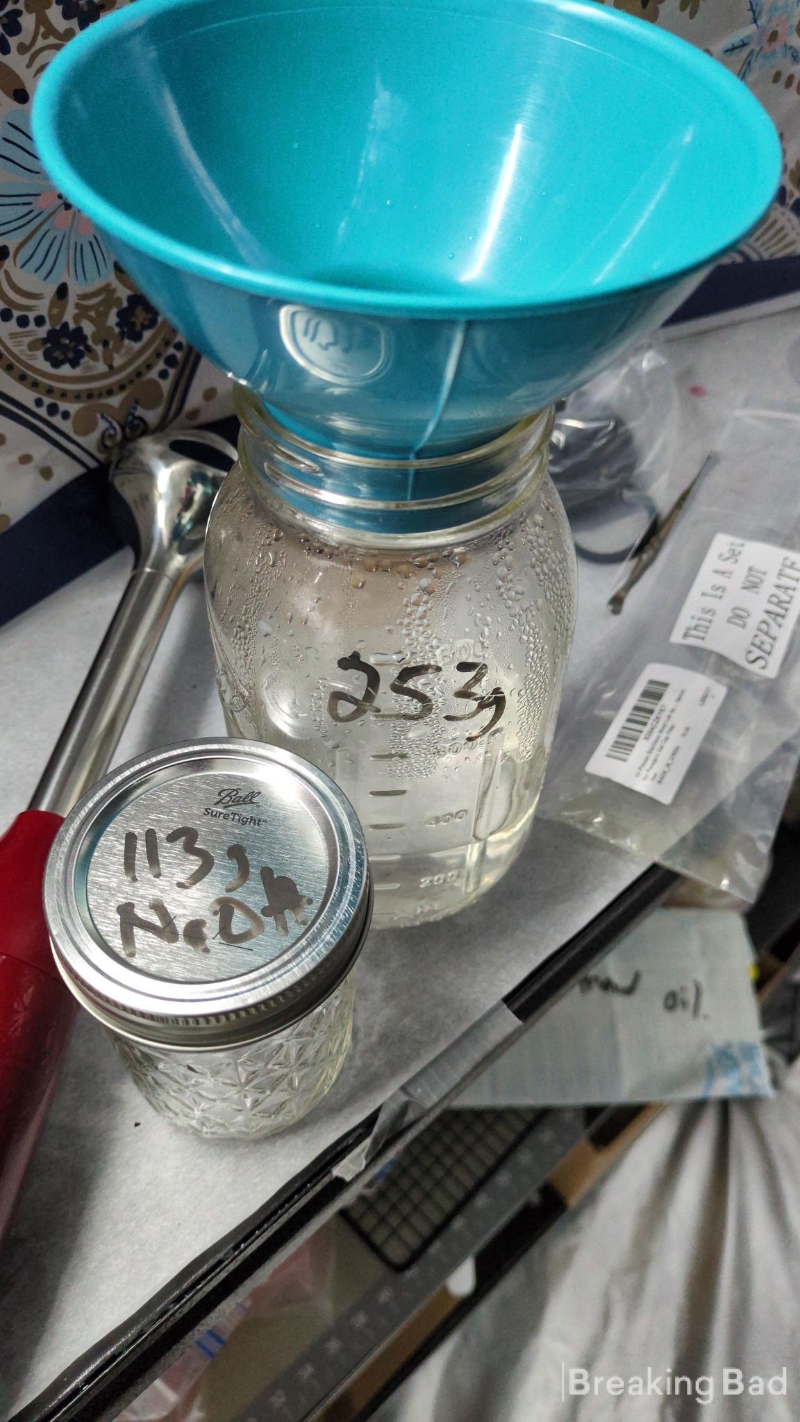

We are using 113g of NaOH in 253g H2O.
We are using almond oil, 896g. So..

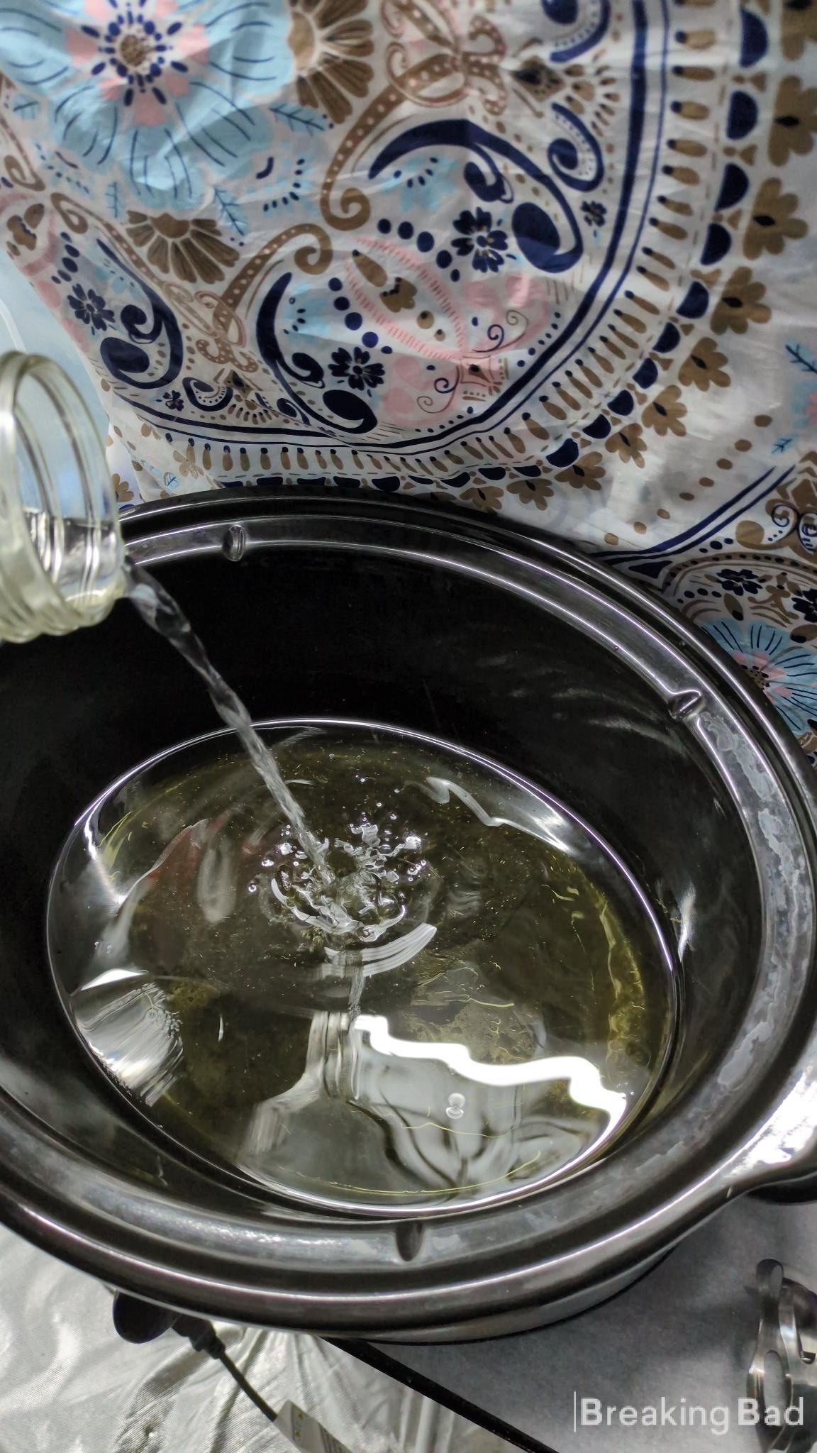

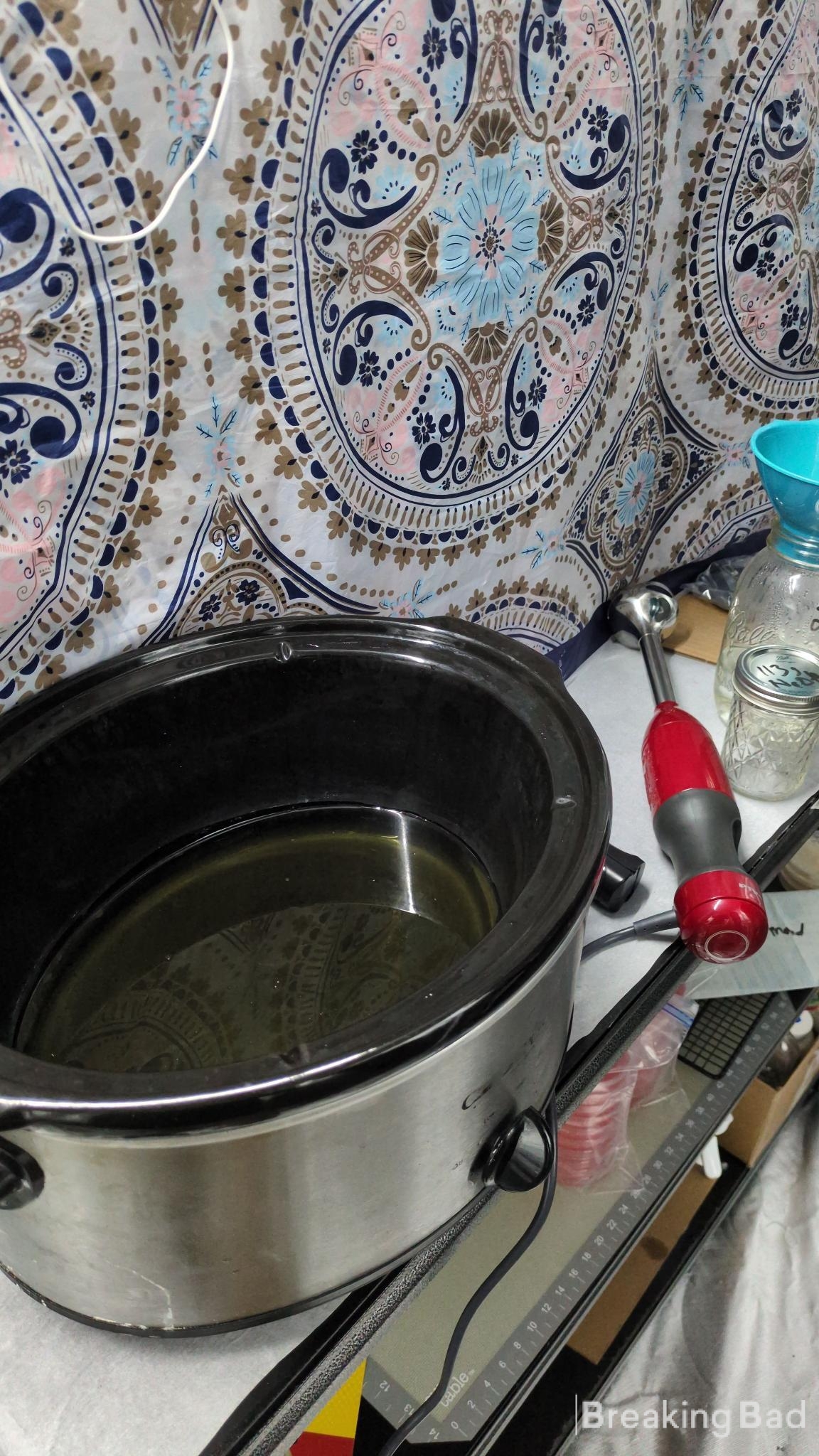

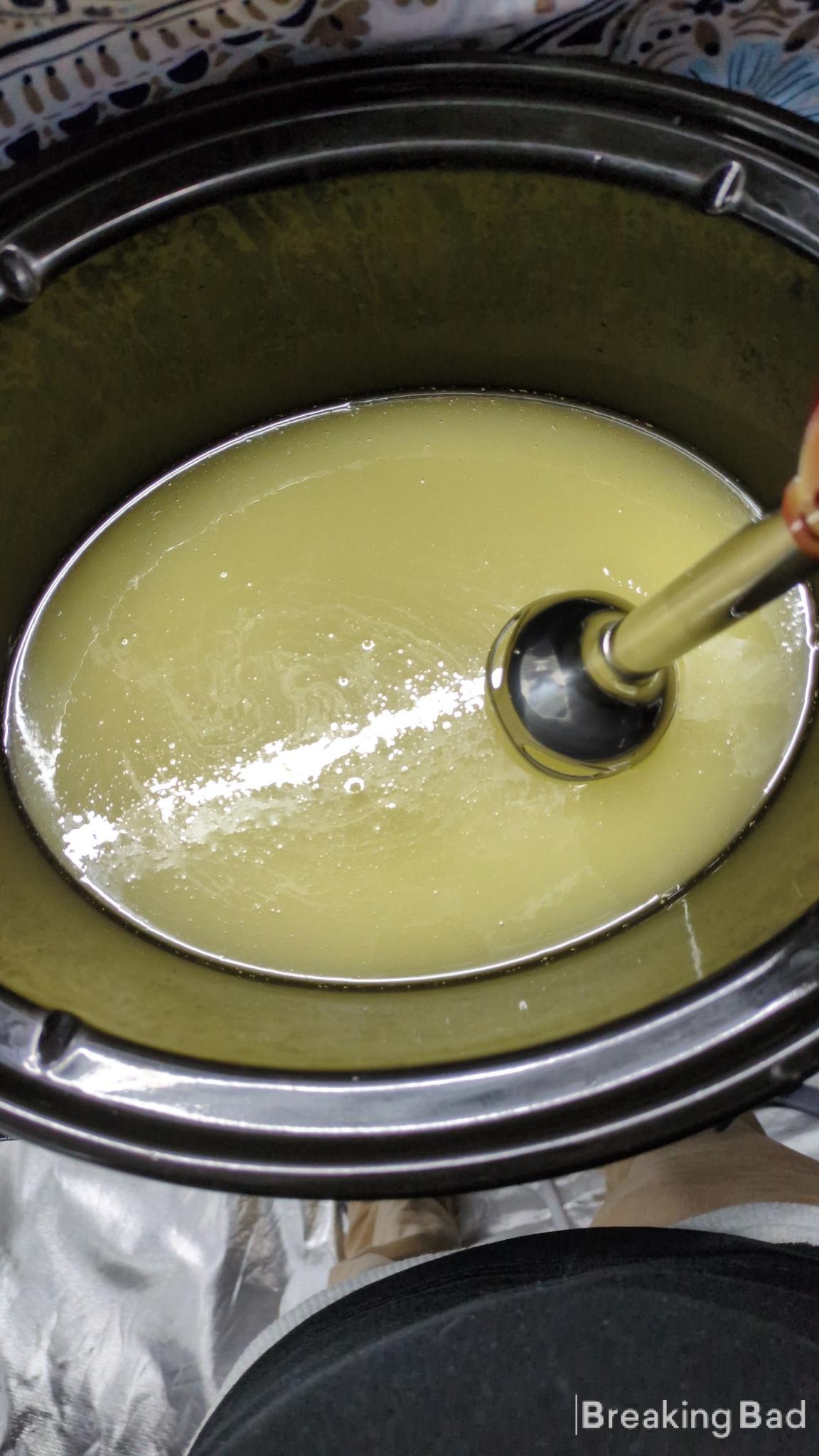

A one neck ceramic oval flask, aka a crock pot, was charged with 896g almond oil and placed on low, and allowed to warm up.
When the oil warmed up (on low on crock pot settings) and the NaOH solution cooled down, we did a couple dabs, and got back to the experiment.
When they were close to the same temp, 122f the solutions were mixed together in the oval flask
Using the overhead handheld mechanical stirrer, aka emulsion blender, the two solutions were mixed in short rapid bursts, until it becomes creamy, and go a little while longer until you are sure it is mixed.

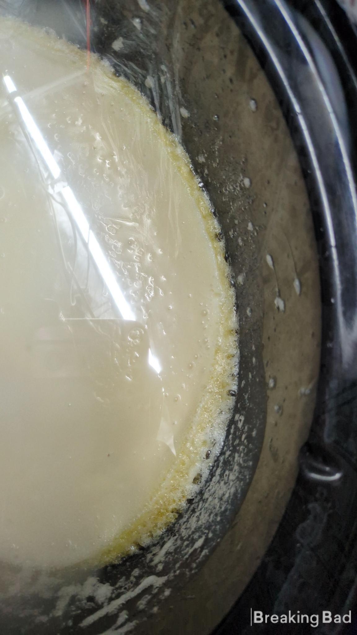

After this, put saran wrap on that muthafucka so no water evaporates, and allow the reaction to take place.

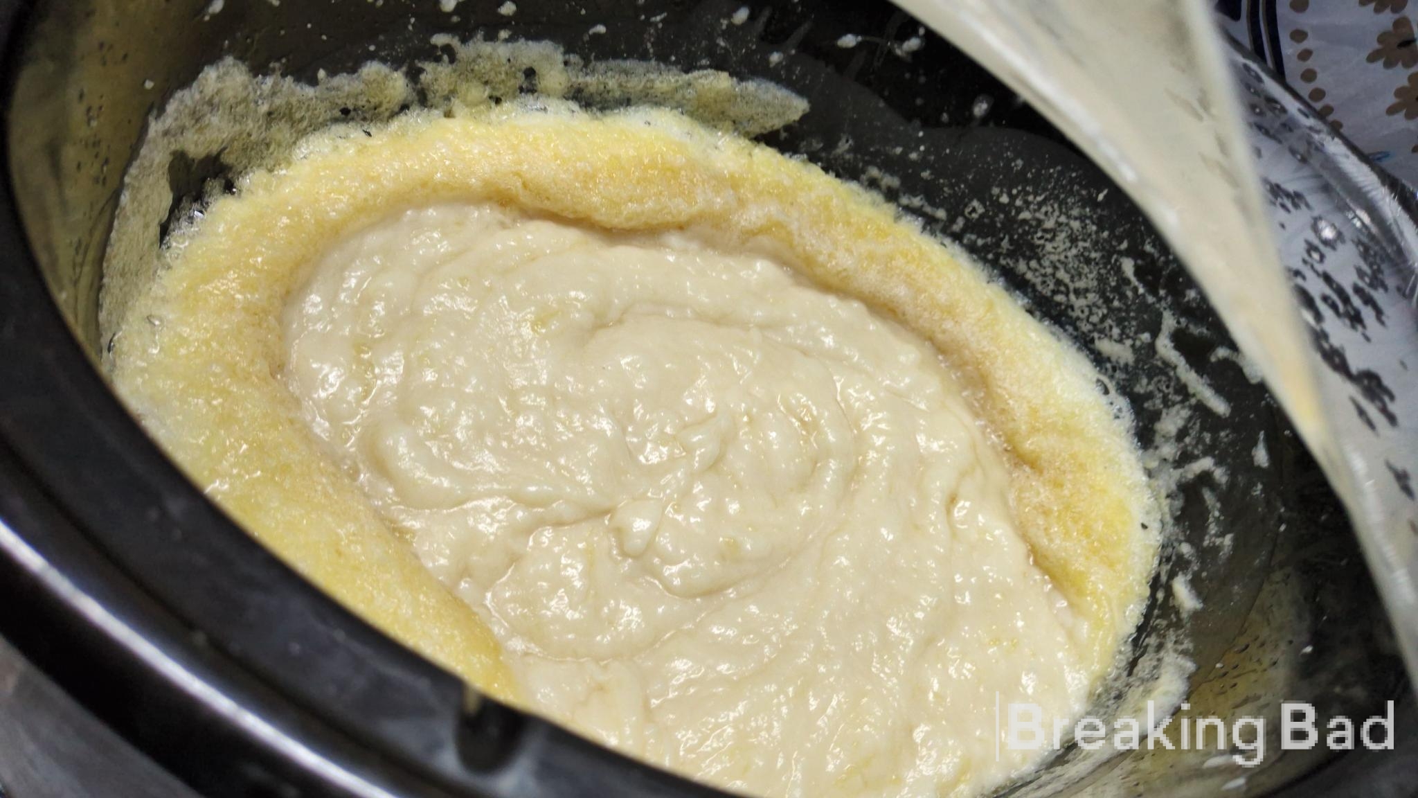

See how it looks creamy, but opaque? As the reaction takes place, it gets around the side looking more translucent.

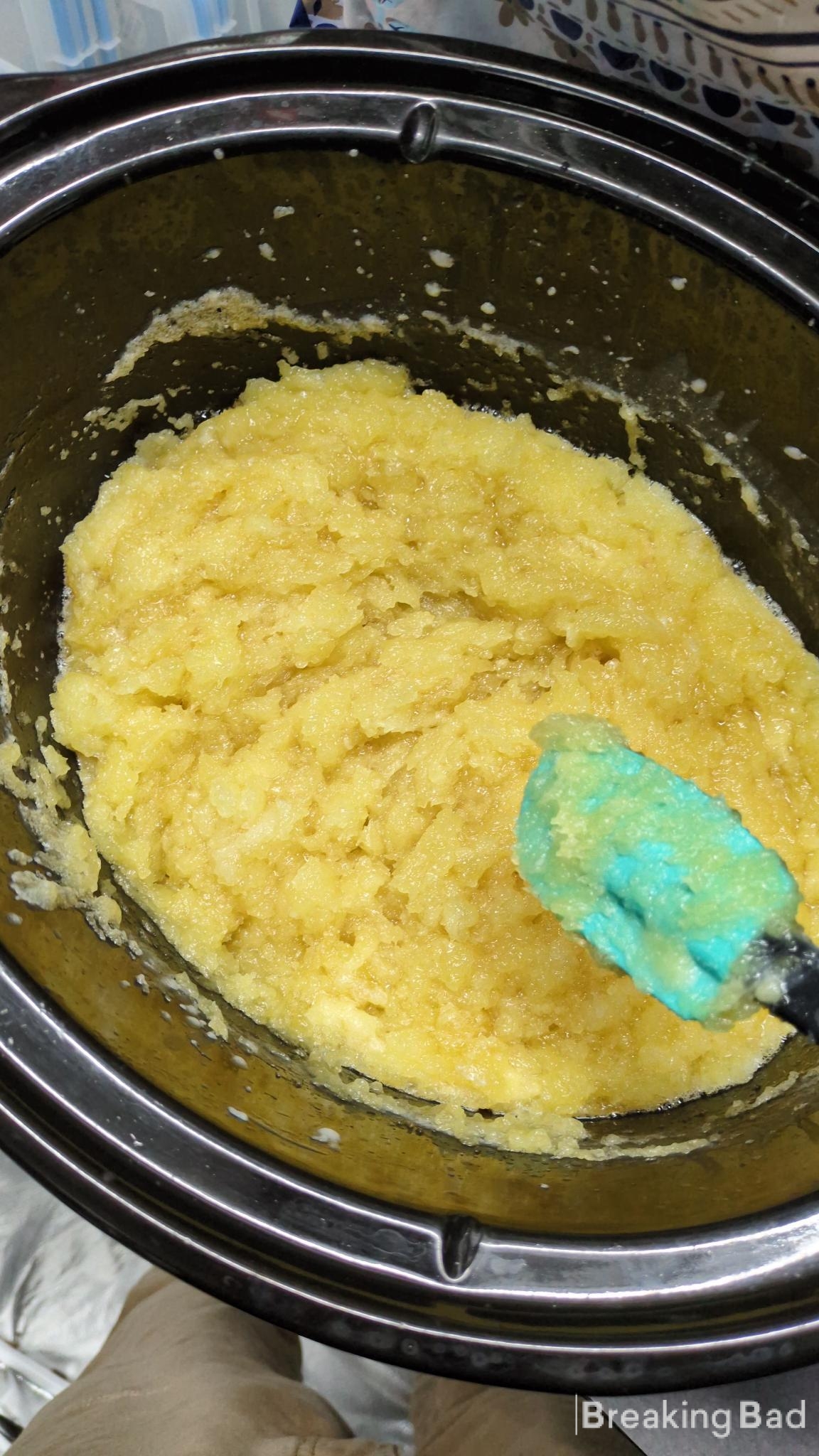

After 50 min, and about 160-180 (different places different temps using infrared thermometer) it was stirred.
It was mixed and 10 min later it was 80% finished. It was stirred again and heat turned off. In no time after the last stir the reaction was complete, temp 190-210f. Totally gelled.

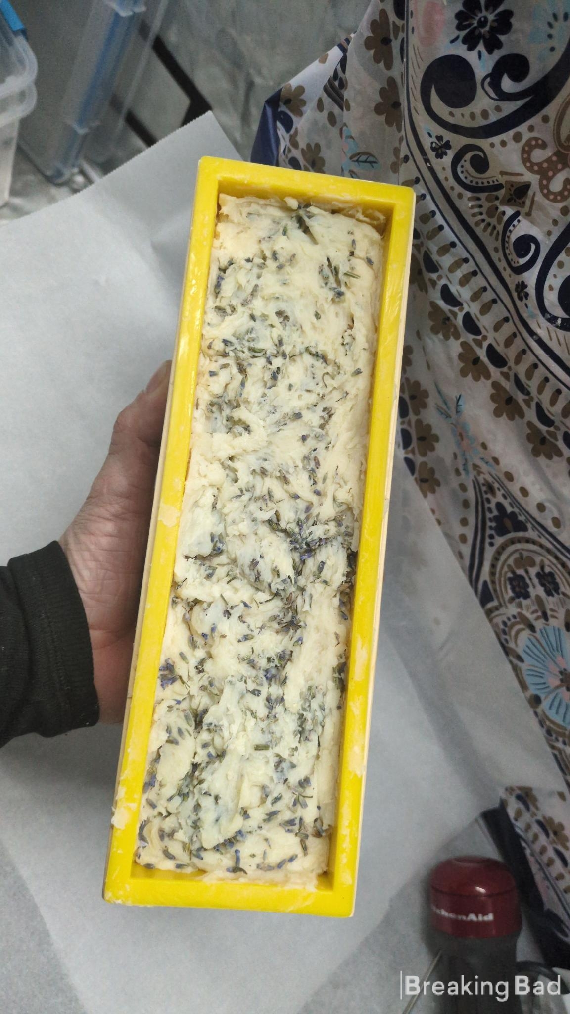

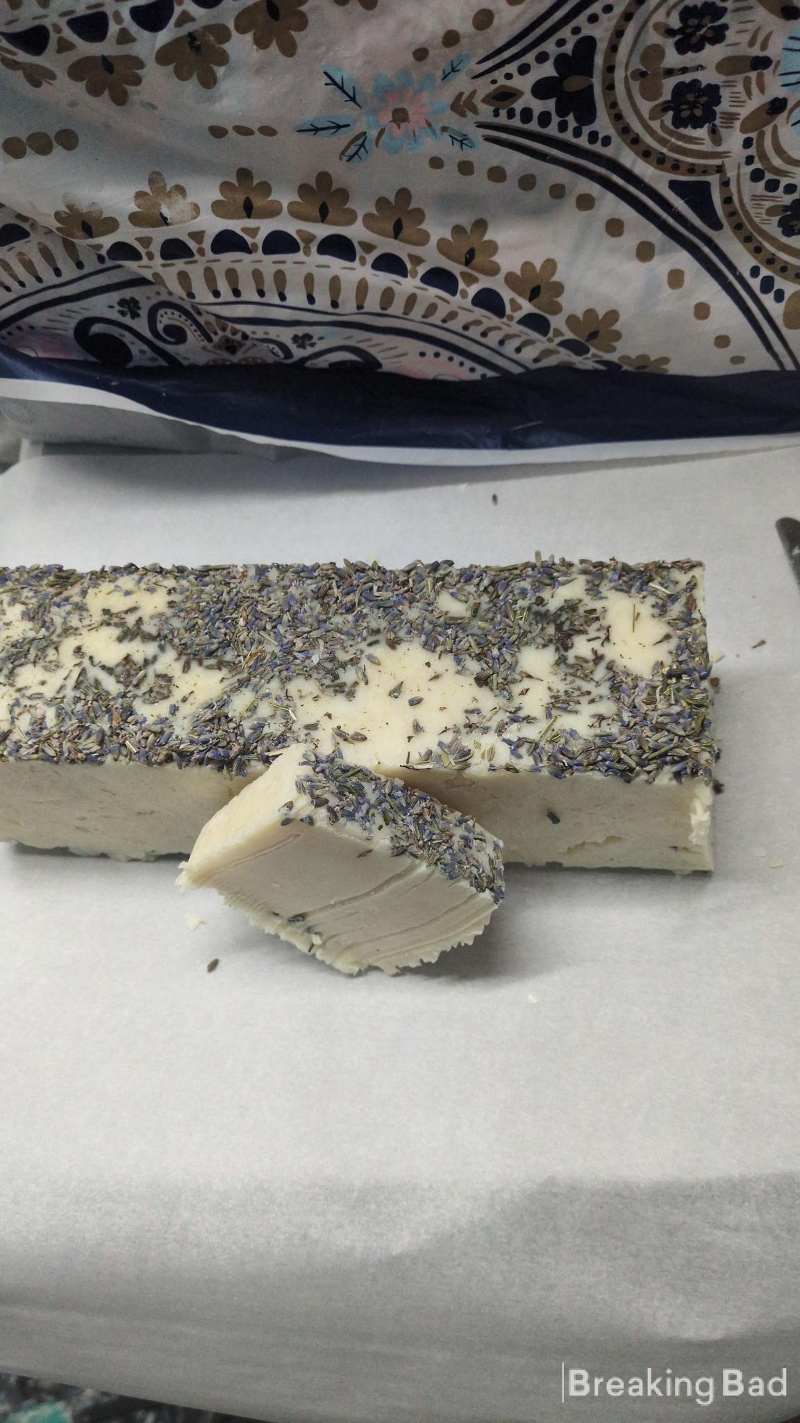

Poured dried lavender flowers on the bottom of the mold and poured the soap mix into the mold and used lavender flowers on top...let it sit for 24h...I think it looks best on the bottom, what do you think?
This is called hot process soapmaking. Look it up .
The heat from the crockpot speeds the reaction up, and after 24h it should be ready.
