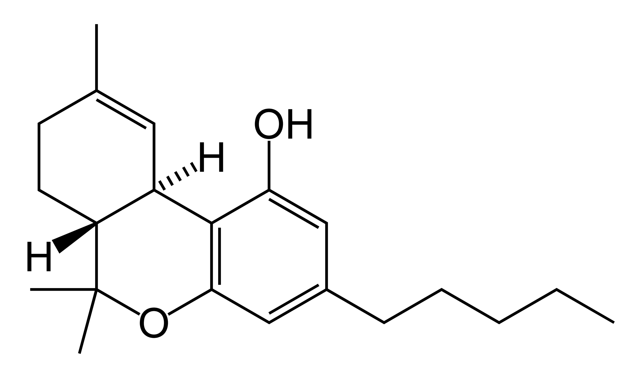

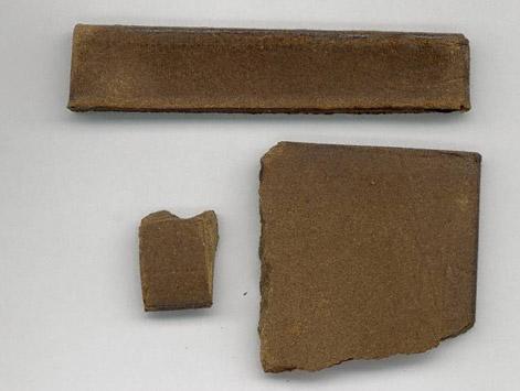

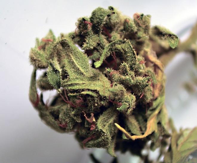

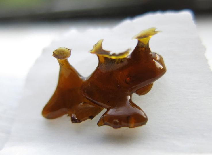

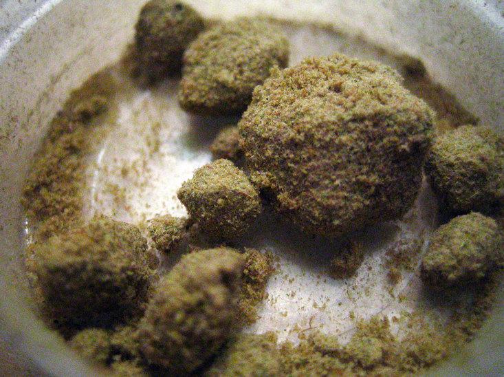

Cannabis (also known as marijuana, weed, pot, grass, hemp, and many others) is a preparation of the cannabis plant that produces psychoactive effects when consumed (via smoking, vaporizing, or ingestion). The principal psychoactive constituent of cannabis is tetrahydrocannabinol (THC), which makes up one of 483 known compounds in the plant, including at least 84 other cannabinoids such as cannabidiol (CBD), cannabinol (CBN), tetrahydrocannabivarin (THCV), and cannabigerol (CBG). At least three species are recognized: Cannabis sativa, Cannabis indica, and Cannabis ruderalis.
Cannabis is consumed in many ways, all of which involve heating to decarboxylate THCA in the plant into THC.
- Smoking, which typically involves burning and inhaling vaporized cannabinoids ("smoke") from small pipes, bongs (portable versions of hookahs with a water chamber), paper-wrapped joints or tobacco-leaf-wrapped blunts, and other items.

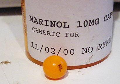

- Capsules, typically containing cannabis oil, and other dietary supplement products, of which some 220 were approved in Canada in 2018.
