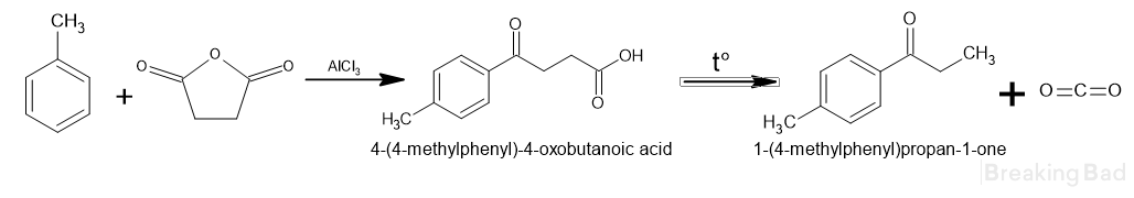

Hello fellow chemistry enthusiasts,
I have personally not looked to much in the preparation of 4-Methylpropiophenone.
I have thought of a synthesis of it using succinic anhydrid on toluene using a simple Friedel–Crafts reaction with Aluminum Chloride as a catalyst, yielding 4-(4-methylphenyl)-4-oxobutanoic acid which is then decarboxylated to 4-Methylpropiophenone. The precursors seem to be widely available and relatively cheap.
If someone knows more about potential yields, or mistakes I made please let me know, because I might try it out myself.

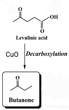

I've never tried it myself, but I just looked and the tolyloxobutanoic acid is available from a well-known chemical vendor for $150 for 100g. No idea about yield following CuO but on the surface it certainly sounds like it beats a propionyl chloride and methyl propiophenone synth. Might have to give it a shot one of these days.

Usually it's toluene and propoinyl chloride with aluminum chloride Friedel-kraft.
Please, use the search engine
2,072
1,542
This patent lays out a lot of substituted propriophenone synthesis
The_Real_DEA_42069
Jun 8, 2024
My comments are, of course, speculative retrosynthesis — I would always recommend first the given default procedure of synthesizing the substituted propiophenone via AlCl3 F-K with toluene and propionyl chloride or the anhydride if one isn't absolutely clear on what's being discussed in theoretical alternative routes
