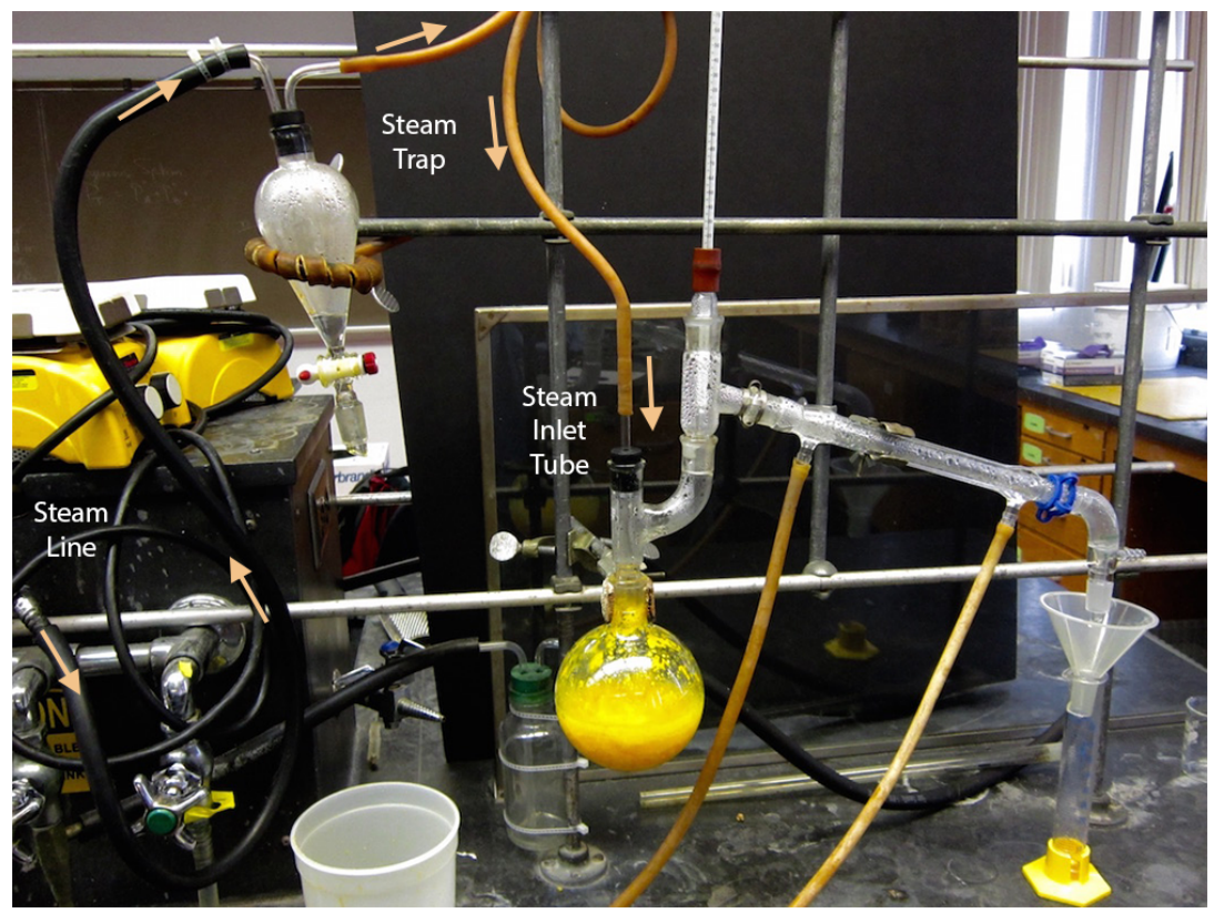

A steam distillation apparatus is shown in Fig.2 that uses boiling water in the distilling flask. An apparatus using a steam line is shown in Fig.3. It is assumed that readers have previously performed a simple distillation, so in this section are described differences between simple and steam distillations.
O9DBeh7VyT
FKw27By5no
Prepare the Setup:
1. Place the plant material to be extracted into a large round bottomed flask with a 24/40 joint (wide mouth), no more than half full. A large amount of material is often necessary as the bulk of plants is cellulose, not oil. Use of a 14/20 flask (more narrow mouth) would make it difficult to remove the plant materials after distillation.
2. Use an extension clamp to secure the large flask to the ring stand or latticework. If desired, further secure the setup with a platform (e.g. ring clamp and wire mesh as in Fig.2).
3. Add water to the distilling flask to just cover the plant material.
4. Always use a Claisen adapter in the setup, as plant materials commonly foam with heating and there is often a great amount of turbulence in the distilling flask (see splashing in the flask in Fig.3).
5. Two variations of steam distillation are regularly used: one where steam is directly generated by heating water in the distilling flask with a Bunsen burner (Fig.2), and another where steam is indirectly generated by a steam line in the building (Fig.3). Although burners are not commonly used with the distillation of organic compounds, they are relatively safe in steam distillations because: a) the majority of the vapor produced by the solution is typically water rather than organic compounds, so the vapor is not particularly flammable, b) The distillate may be somewhat flammable, but is a distance away from the heat source.
6. To the top of the Claisen adapter, connect one of the following, depending on the variation of distillation used:
a) If water will be heated in the distilling flask along with a burner: Attach a stopper to close the system (indicated by the arrow in Fig.4) if the quantity of water will be sufficient for the distillation. Attach a 125ml separatory funnel (which must have a ground glass joint below the stopcock) if it is anticipated that water will need to be replenished during the distillation. Clamp and partially fill this separatory funnel with water (Fig.2).
b) If a steam line will be used: Insert a steam inlet tube, and position it, so the outlet is just raised above the bottom of the flask. Connect this tube to a separatory funnel trap attached to the steam line (Fig.3).
PveXRxiJOp
7. The receiving flask can be a graduated cylinder, Erlenmeyer flask, or round bottomed flask.
H3yNgWdERI
a) Waving the burner to heat the distilling flask (with mint), b) Draining the water from the steam trap after opening the steam line, c) Steam bubbling through the distilling flask (with orange peels).

a) If using a Bunsen burner, initially heat the flask at a rapid rate (it takes a lot of energy to boil water), but once the solution is boiling or foaming, turn down the burner and/or wave the burner to moderate the distillation rate (Fig.5 a).
b) If using a steam line, open the stopcock in the separatory funnel steam trap. Turn on the steam, and allow the water in the steam line to drain through the funnel and into a container (Fig.5 b). Close the stopcock when it appears that most of what is coming out of the steam line is steam and not water. Adjust the steam rate so that the steam bubbles vigorously through the liquid in the distilling flask (Fig.5 c).

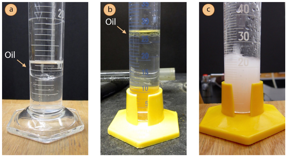

a+b) Distillate with organic oil atop water (orange oil in both), c) Milky distillate (clove oil)
9. Collect distillate at a rate of 1 drop every second. The distillate will contain both water and oil, and may look one of two ways.
a) A second layer may form, or the distillate may appear to have oily droplets clinging to the sides of the flask. This happens when the oil is very nonpolar (e.g. Fig.6 a+b show the distillate of orange oil, which is almost entirely composed of hydrocarbons).
b) The distillate may also appear cloudy or "milky" (Fig.6 c shows the cloudy distillate of clove oil). A cloudy mixture forms when tiny insoluble particles are dispersed throughout the suspension. This tends to happen when the oil is water-insoluble but contains some polar functional groups (e.g. large compounds with a few alcohol or ether functional groups).
