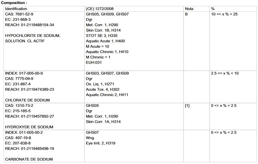

Hello;
I am currently preparing my notes for future synthesis and I have a question about the choroform synthesis
I have this product:
VpT8G3xHcr
it says 13% so I'm doing my calculations... (if i was good)
right?
but then I see in the datasheet these details:
K8ZybS2VLR
and so I'm confused... should I base it on 13%? 10%? 12.5%? according to these details...
so as not to have an excess of acetone
3,148
3,620

You have to count this as smallest possible amount 10%. Excess of Cl2 doesn't spoil your reaction.

The MDS will never give you an exact concentration, especially not with sodium hypochlorite solutions that tend to decompose with time.
You need to determine the concentration of hypochlorite through measuring the amount of chlorine gas produced by a known amount of the solution.
You do this by adding dilute hydrogen peroxide dropwise to a small, exactly measured amount of the hypochlorite solution in a 2-or 3-neck RBF. Say 5 or 10 ml. This produces oxygen gas. The gas is led by a tube into an upside down measuring cylinder filled with water. Hydrogen peroxide is dripped till no more bubbling occurs, and the volume of the gas can be measured by how much water it has pushed out. Since every mole of sodium hypochlorite reacts with H2O2 to produce an equal amount moles of oxygen gas, the concentration can be calculated from these data:
