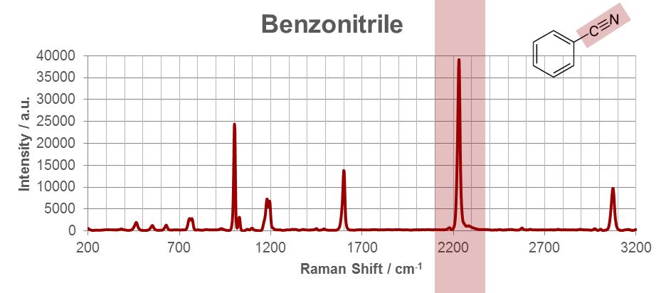

The vibrations of certain distinct subunits of a molecule, called its functional groups, will appear in a Raman spectrum at characteristic Raman shifts. Such a shift is similar for all molecules containing the same functional group. These signals are particularly useful when monitoring reactions which involve these functional groups (oxidation, polymerization, etc.), since they provide a direct measure of the progress during the reaction.
Raman strum of benzonitrile and the stretching vibration of the cyano-group (CN) of benzonitrile at 2229.4 cm-1 (red).​
DrPXlIATfe
Using these characteristic shifts makes it possible to relate the spectrum of an unknown compound to a class of substances, for example the stretching vibration of the carbonyl group in an aldehyde is always in the range of 1730 cm–1 to 1700 cm–1. The image above demonstrates the Raman spectrum of benzonitrile containing the stretching vibration of the cyano-group (CN) of benzonitrile at a characteristic value of 2229.4 cm-1.​

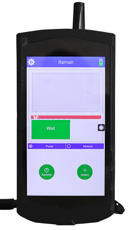

Handheld Raman spectrometers are used to provide direct sampling of loose solid or liquid material or to conduct sampling on a containerized sample. These devices are rugged, field-portable units that are designed to provide responders with the ability to analyze unknown powders and liquids without destroying the sample.​
Method opportunities​
First, you can check conformity of your substances with the spectrometer database. Consumers can manually produce a database with different drugs and substances with different concentration or buy database and install in the own device. According to the database, concentrations of interesting substances could be measured.
There are pictures of a typical spectrometer device, a vial for test samples and a cuvette. Attach the cuvette with inserted vial with a sample and close cuvette. It is important for providing analysis without light pollution.​
