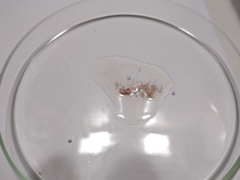

1. In case of total amphetamine substitution for caffeine, the result would be as in the photo:

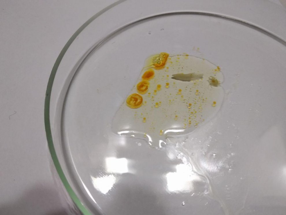

2. In case of mixing of amphetamine with caffeine (in this case the composition is 70% of amphetamine and 30% of caffeine) the result would be as in the photo:

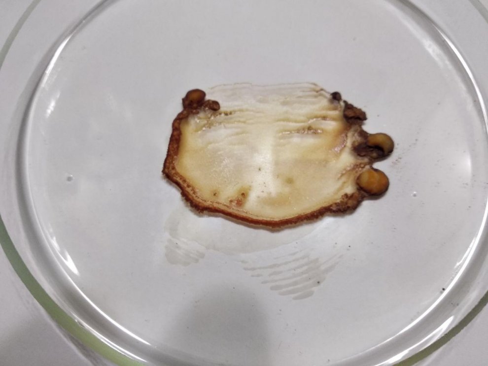

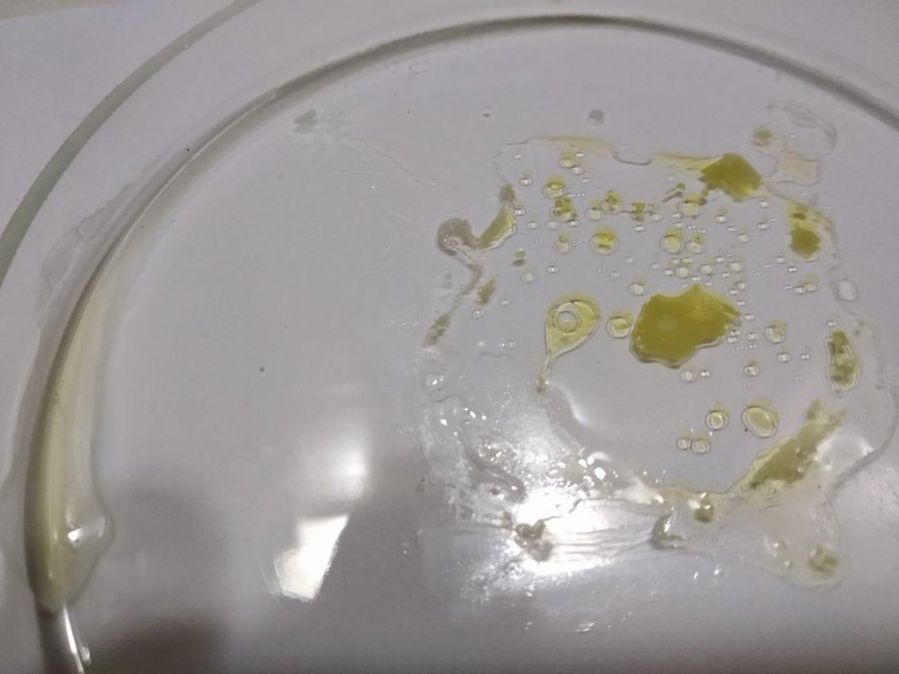

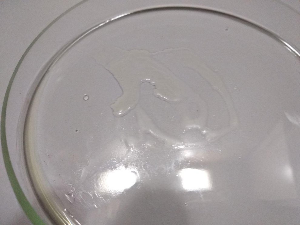

3. In case of pure amphetamine sample, the result would be as in the photo:

As higher concentration of the substance in the sample, as brighter the yellow color. The oil stain is occurred while adding ammonia solution to amphetamine. The red-brown color of dry residue is occurred while adding the ammonia solution to caffeine.
