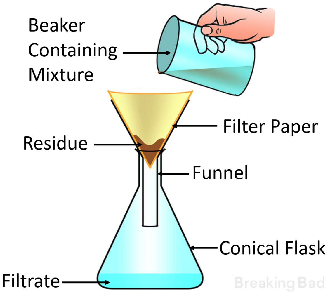

Gravity Filtration
Filtration is a widely utilized physical process that separates solid particles from fluids within a mixture by using a specialized filter medium. This medium consists of a porous structure that permits the passage of the liquid or gas while retaining solid matter. Particles that are too large to pass through the filter are referred to as retained solids, while the filtered liquid that moves through is known as the filtrate. In some cases, the retained solids accumulate on the filter surface, forming a residue layer called a filter cake. Over time, excessive buildup can lead to clogging of the filter, a phenomenon known as blinding, which restricts fluid flow.
X2rK5iWbjk
The effectiveness of filtration is influenced by factors such as pore size, filter thickness, and biological activity. Although filtration naturally occurs in various geological and biological systems, it is also extensively applied in industrial and laboratory settings. In everyday life, the process is often referred to as "straining," such as when using a colander to drain water from pasta.
Px1Ok2iBrC
Gravity Filtration Procedures
When separating solid-liquid mixtures, particularly those with extremely fine particles that remain suspended in solution, conventional methods like decantation become ineffective. In such cases, gravity filtration is employed as an alternative. This technique is especially beneficial when the goal is to retain the liquid phase while removing unwanted solid particles.

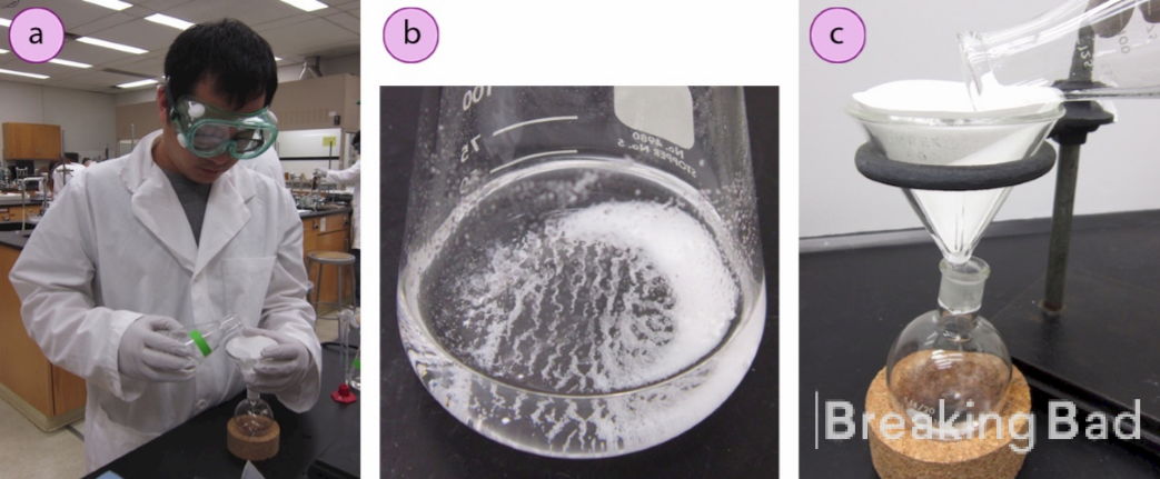

In the field of chemistry, recrystallization serves as a widely utilized method for purifying chemical compounds. This technique involves dissolving both the target substance and its impurities in a carefully chosen solvent. Depending on solubility differences, either the desired compound or the unwanted substances can be separated, leaving the purified material behind. The name "recrystallization" originates from the formation of crystals that emerge as the compound solidifies from the solution. Additionally, the term can also describe the natural process where larger ice crystals develop by consuming smaller ones.
HKlZNOWyGC
Recrystallization Before, During, and After Procedure
The effectiveness of this purification method relies on the principle that most solids exhibit increased solubility at higher temperatures. As temperature rises, a greater quantity of solute can dissolve in the solvent, facilitating the separation process.
To perform recrystallization, an impure substance is dissolved in a solvent at an elevated temperature, ensuring that both the impurities and the compound remain in solution. As the solution cools, the solubility of both the impurities and the target compound decreases. Because the primary substance is present in a greater concentration, it crystallizes out first in a purer form, while the impurities remain in the liquid phase. The purified crystals are then separated through filtration. This process can be repeated multiple times to further enhance purity. Additionally, solubility curves are often used to predict and optimize the recrystallization process.

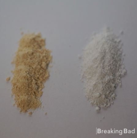

There is a special case of extraction, named acid-base extraction. This method is widely used for salt form of drugs purification. Some drugs can be alkalinized with getting free base form of active drug and then extracted by a solvent. This solvent then acidified again and crystallized
Yi3rBMcJXL
Amphetamine sulphate before and after acid-base extraction
A washing of a final product on the Buchner funnel is also an individual case of extraction. A solid target product is washed by a solvent, which is don't dissolve or very slightly dissolve target substance while dissolve side products. This is extraction of side products and precursors from the final product by a cold solvent. This method is not very effective in case of serious pollutions in a target product. In this case, it's worth to use recrystallization.

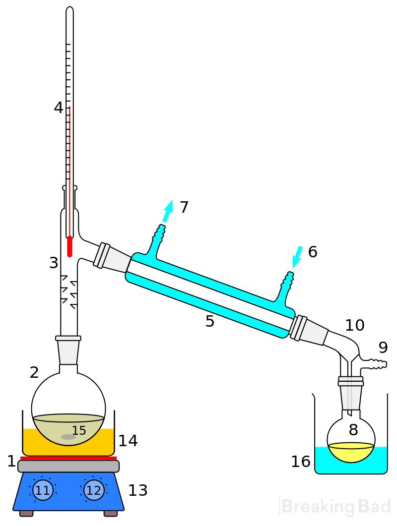

Distillation is a process that involves the evaporation of a liquid followed by cooling and condensation of the resulting vapor. Primarily used for the separation and purification of multi-component mixtures, distillation is one of several phase transformation and mass transfer techniques, alongside crystallization, sublimation, and liquid-liquid extraction.
There are two primary types of distillation: one where vapor condenses into a liquid, resulting in a distillate with an averaged composition due to mixing, and another where vapor condenses into a solid phase, leading to a differentiated concentration of components within the condensate. Depending on the objective, distillation yields either a purified distillate, a residue, or both. The key components of a distillation setup include a heated vessel (boiling flask) to contain the liquid mixture, a cooling system (condenser) to facilitate vapor condensation, and a heated vapor pathway connecting these components.
Types of Distillation
Simple distillation involves the partial evaporation of a liquid mixture, with continuous condensation of the produced vapors. The collected condensed liquid is referred to as the distillate, while the remaining unevaporated portion is known as the residue. This method is ideal for separating substances with significantly different boiling points.
JhSOQUx2vR
Simple Distillation Apparatus Scheme

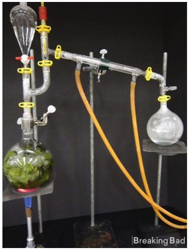

Steam distillation is a refinement method similar to simple distillation, with the key distinction being the use of steam or water in the distillation flask alongside the substance to be purified. The experimental setup remains largely the same, with variations in how the steam is introduced—either indirectly through a built-in steam supply or directly by heating water in the flask.
Download Video
Applications:
This technique is widely utilized for extracting natural compounds from plant materials. It serves as the primary industrial method for obtaining essential oils used in perfumes, cosmetics, and hygiene products. Due to its efficiency in isolating bioactive substances, steam distillation is commonly employed in pharmaceutical and botanical extractions. For example, it is frequently used to derive psychoactive compounds from plants such as those in Ayahuasca preparations and cannabis extraction processes.

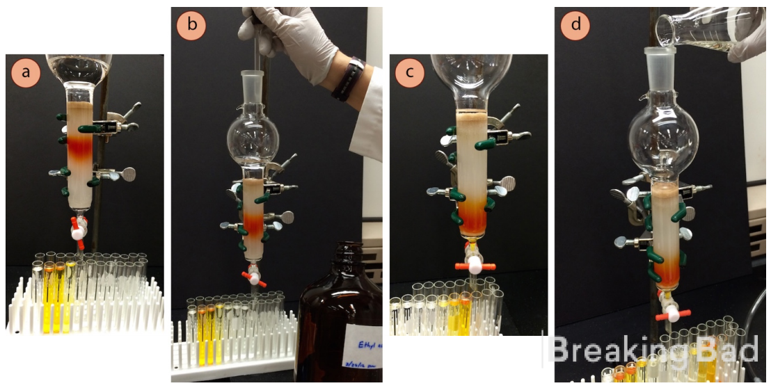

Column (Flash) Chromatography
Column chromatography is an advanced purification technique that builds upon the principles of thin-layer chromatography (TLC). It is assumed that the reader has prior laboratory experience and familiarity with TLC methods. Instead of applying a sample to a thin layer of silica or alumina, the substance is introduced into a cylindrical column packed with an adsorbent material. A solvent is then continuously applied under pressure, allowing the individual components to separate and exit the column at different rates.
RiTCb2RYL4
Column Chromatography Manipulations
Unlike TLC, which primarily provides analytical insights, column chromatography enables both separation and collection of purified substances into distinct containers. This makes it a valuable technique for isolating chemical compounds and removing impurities from mixtures. Often referred to as "flash chromatography," this method is widely utilized in research laboratories and is frequently mentioned in scientific publications and procedural sections of journal articles.
DAtljWaFyr
Column Chromatography Operation Scheme

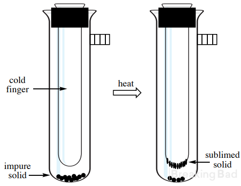

Certain compounds have the ability to undergo sublimation, a phase transition where a solid transforms directly into a gas without passing through the liquid phase. A well-known example is solid carbon dioxide (dry ice), which sublimates easily at atmospheric pressure. Instead of melting, dry ice appears to "vanish" as it directly converts into carbon dioxide gas. Sublimation is similar to boiling in that it occurs when a substance's vapor pressure equals the external pressure, usually atmospheric pressure. However, unlike boiling, which involves a liquid, sublimation pertains to solids.
KHu7lQJEaV
Procedure of Purification by Sublimation
Most solids do not possess significant vapor pressure at standard temperatures, making sublimation a relatively rare phenomenon. Substances that can sublimate generally have weak intermolecular forces in their solid form, often displaying symmetrical or spherical molecular structures. Some examples of compounds that undergo sublimation include DMT, magnesium 4-hydroxybutyrate, and TMA.
