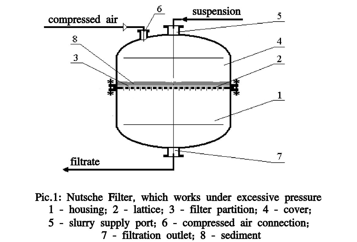

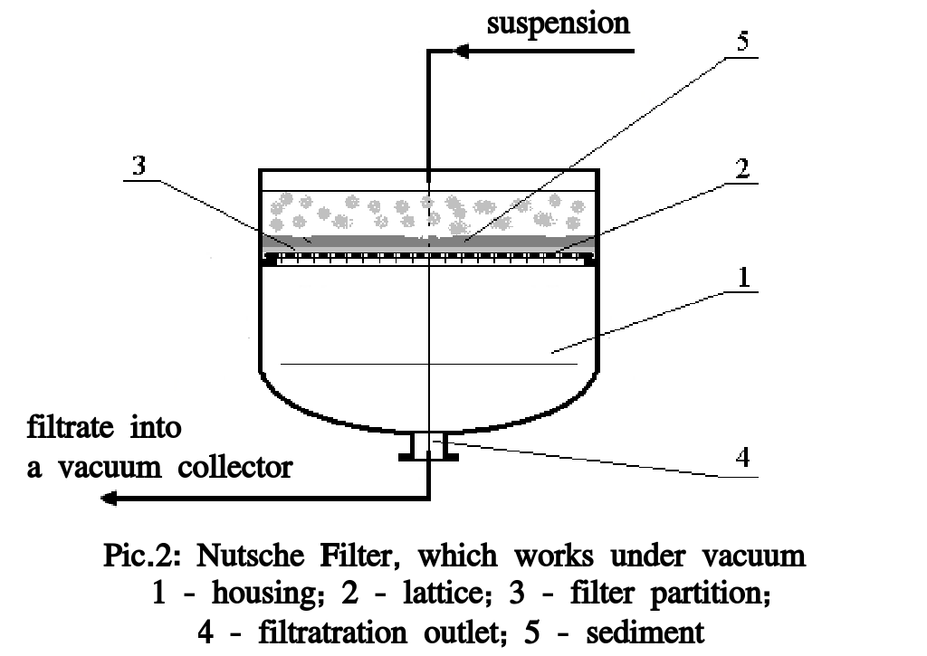

The filter housing 1 (see Fig.1 and Fig.2) is made in the form of a cylindrical vertical container, open at the top (vacuum) or sealed (druk filter), with a false bottom-grid 2, on which a filter partition 3 (usually fabric) is placed on top. For vacuum filters, the cavity under the partition is connected to the vacuum pump through an intermediate container - a filtrate collector. Suspension in suction filters is fed into the cavity above the filter partition. The Druk filter is a Nutsche filter operating under excess pressure. In Druk filters, excess pressure above the filter partition is created by pumping the suspension with a pump or by pumping compressed gas with a compressor into the cavity above the filter partition. The sediment accumulates on the partition to a certain level (thickness), after which the supply of the suspension is stopped. The sediment is washed as necessary, blown, and then unloaded manually. After the filter partition is regenerated (or replaced), the cycle is repeated.
Vacuum suction filters are usually used at significant concentrations of the solid phase in the initial suspension. Druk filters are used to separate fine suspensions with low solids' concentration. To facilitate the unloading of the sediment, the bodies of the Druk filters are made detachable. If unloading is necessary, to release the quick-release connection of the body section, the lower section with a grate is lowered and rotated by about 180 degrees (to facilitate unloading). The advantages of suction filters are their simplicity and high-quality sediment washing. The main disadvantage of these filters is their low specific performance.

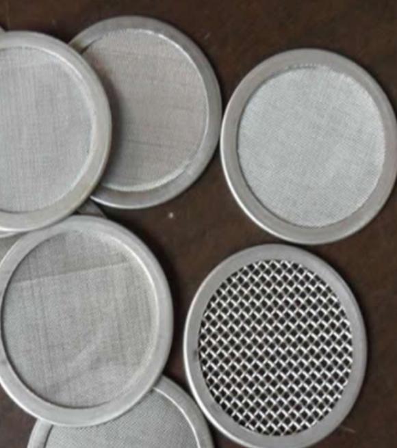

The walls of the filter are made of special glass (borosilicate), and the filter is made of various porous materials. It can be: fluoroplastic, glass, stainless steel, filter cloth. A standard Nutsche always consists of the following elements: a housing with a so-called false bottom, where a filter partition is fixed. Key elements are usually made corrosion resistant. The listed elements and the stirrer are quite easy to additionally cover with plastic, enamel. You can also use rubber. This is what distinguishes Nutsche from other types of filtering devices.

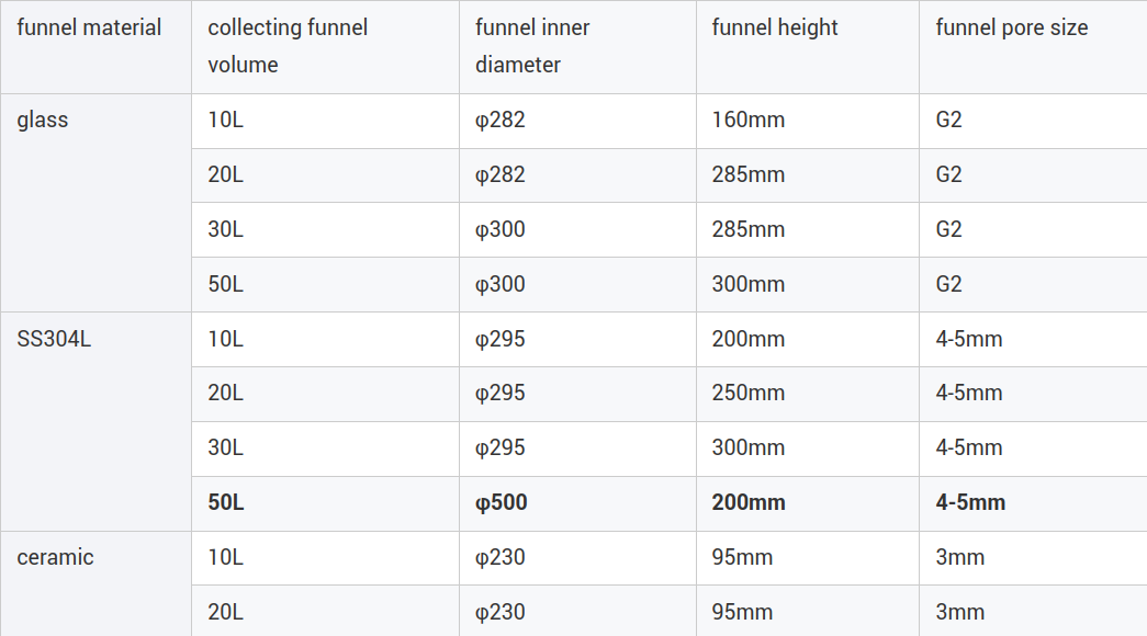

Choosing the right Nutsche filter for your needs starts with choosing a manufacturer, budget, and time to buy. Next, you should select the appropriate Nutsche filter size based on the amount of reaction mass per load that you will need to filter.

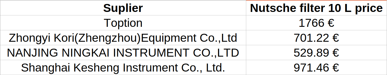

There are many companies, which produce and sell this laboratory equipment. Your choice depends on your budget. Here represented only Chinese suppliers and, hence, prices quite low. European and US manufacturers don't publicate equipment prices on their websites. However, their prices will be higher. Valid prices for 02.2022.
Zhongyi Kori(Zhengzhou)Equipment Co.,Ltd - https://www.korireactor.com
NANJING NINGKAI INSTRUMENT CO.,LTD - https://www.pharmasources.com
Shanghai Kesheng Instrument Co., Ltd. - https://shkesheng.en.alibaba.com
