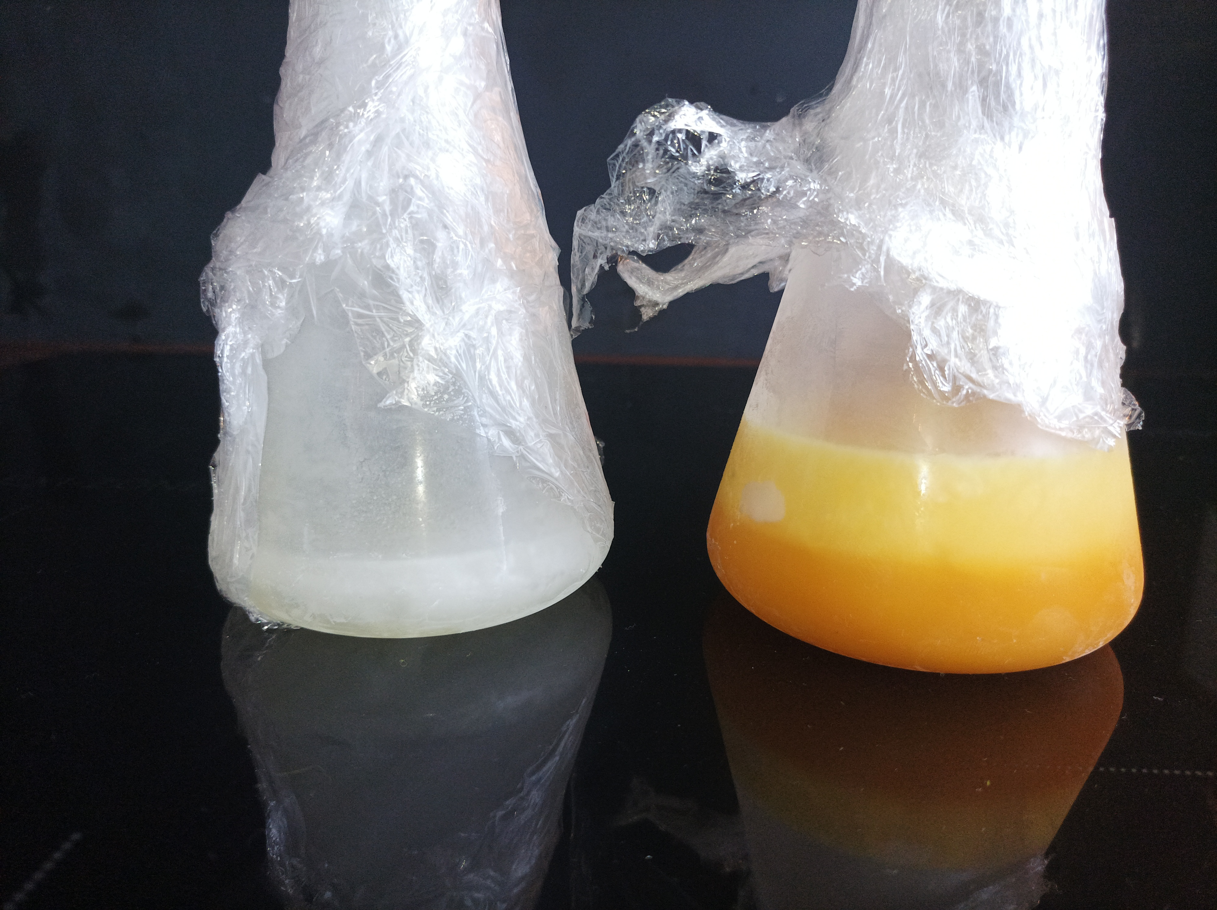

after, i have separate the 2 layers, and put 50ml of isopropanol in the orange one
2mLO8UsRqP
and i put it in the freezer... (actually 11h)
ZBhfKOpuwx
to be continued...
Mclssmxxl
Mar 28, 2022
74
Flask on the right looks good to me, filter it and do recrystalization maybe?

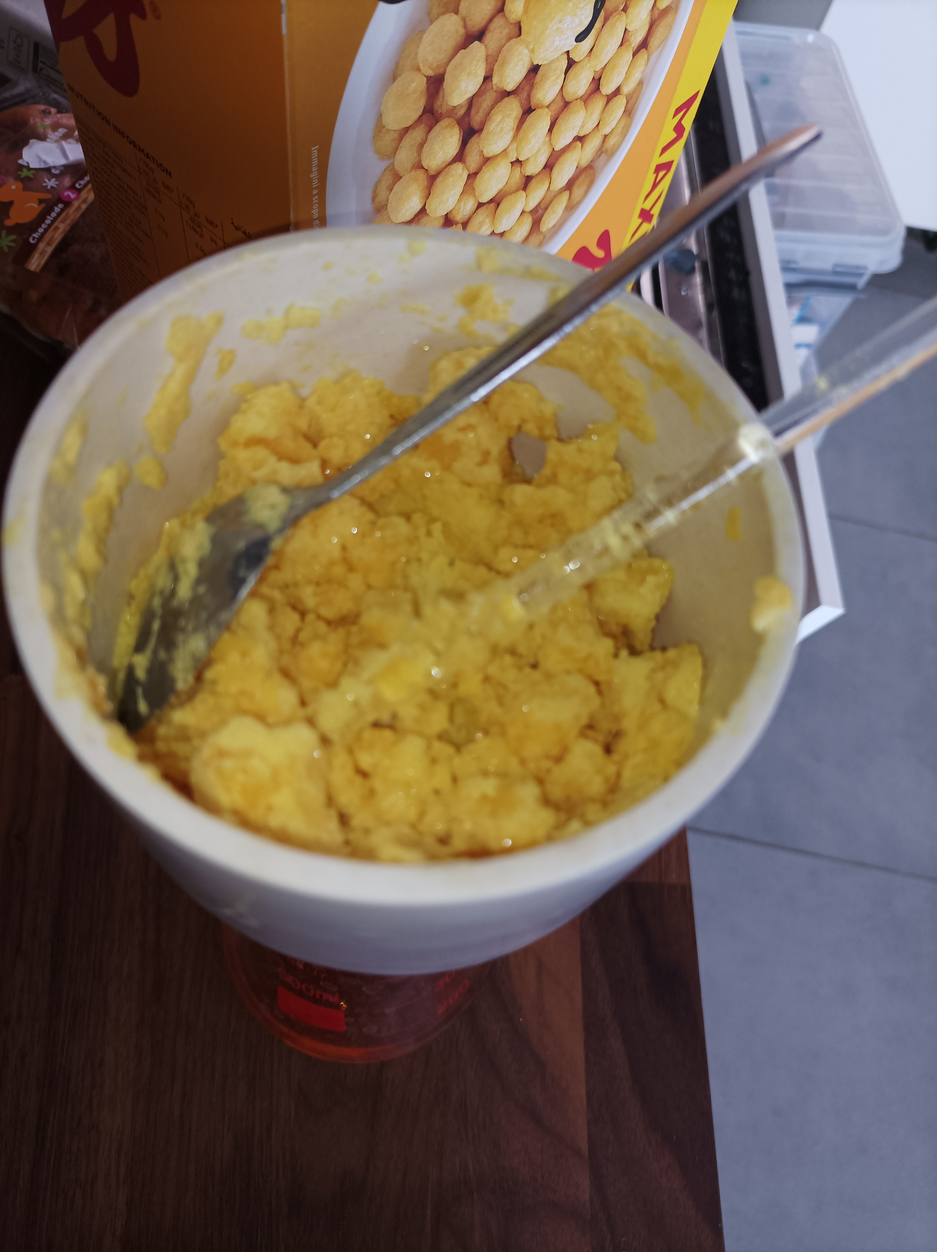

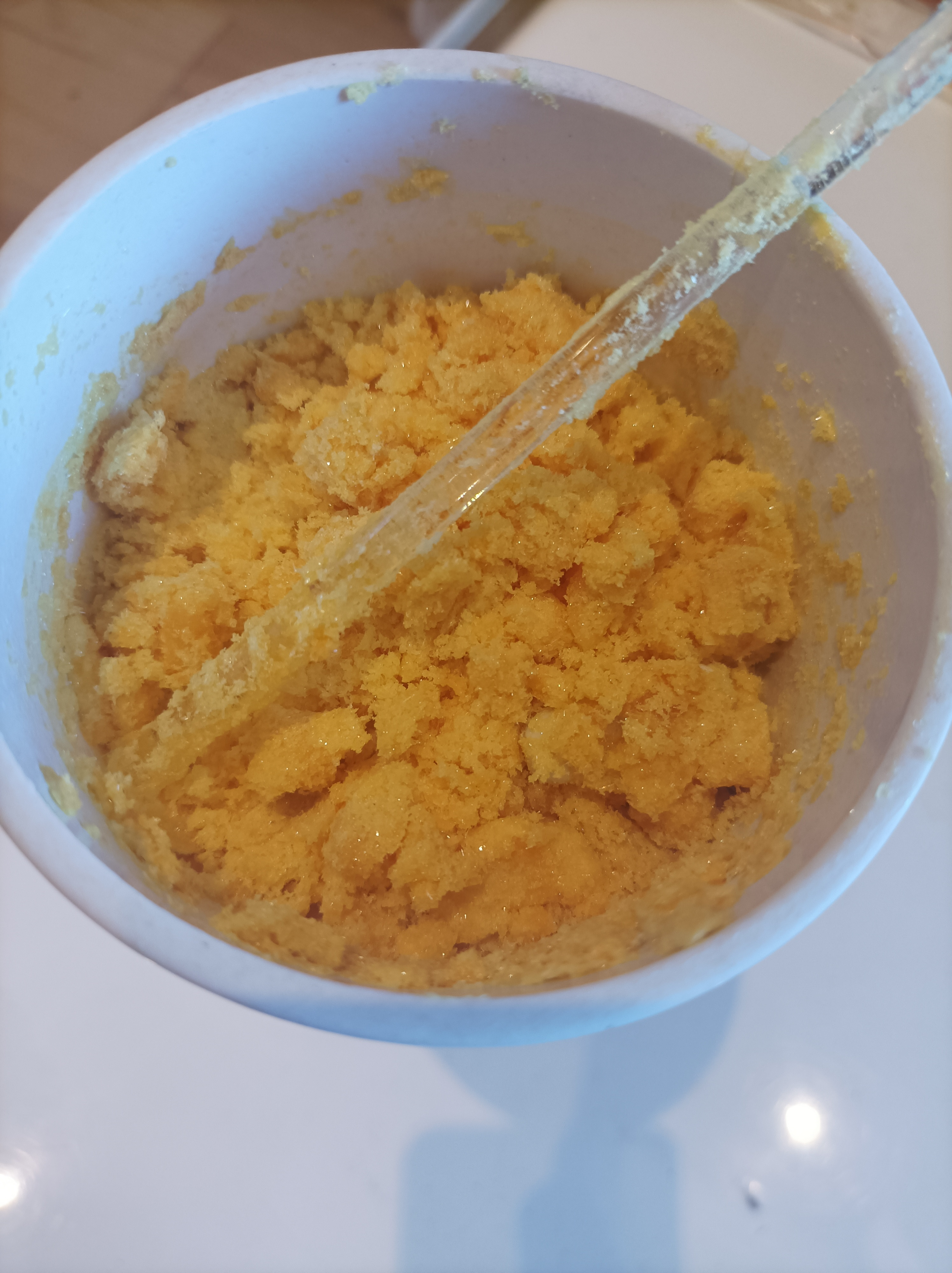

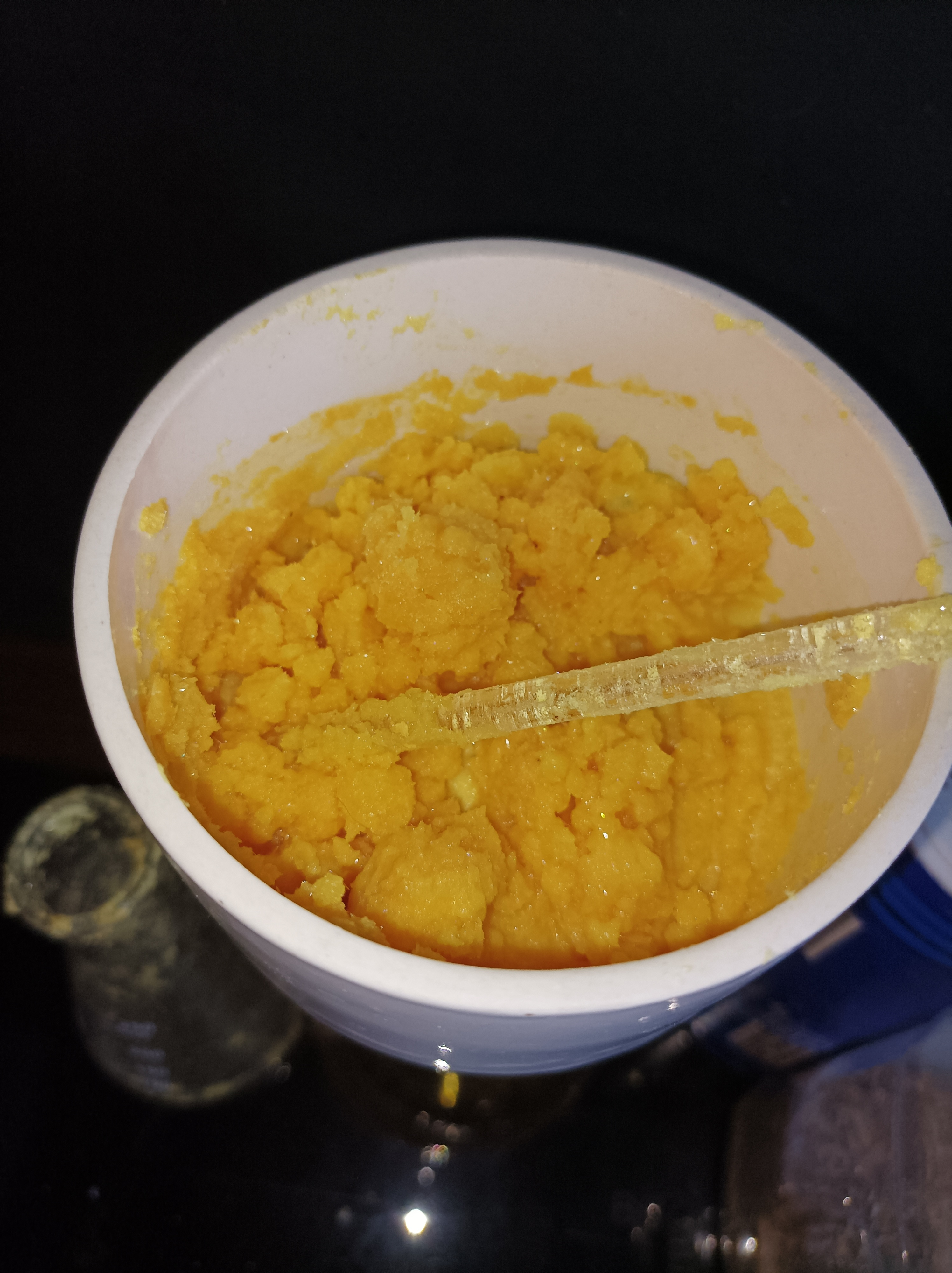

So.... i have filter the yellow flask and junk the white one.
FM1A4t3s7o
4fUu9vxCBr
0BQvfhbCn4
PuJUjVea12
JB4sOySQvh
DEQ5BlAVN7
it really takes a very long time to air dry. I'm waiting for it to be 100% dry to weigh.
any tips for a fast drying with no vaccum pump ? :p
edit : and do you think i need to recrystalize them?

Don’t dry it yet, dissolve in hot (60-70 max) isopropanol, as little as possible.After all is dissolved let it sit at room temp preferably in dark for 24. Purity of substrate is pretty important, plus u get some nice looking crystals.Good job btw, looks like the real deal, just a bit crude.Also try to get your hands on a dean stark, theoretically I think yield is better the more water you remove.
3,160
3,632
How did you make filtration without vacuum pump? Via gravity filtration? You can use Water jet pump, it's extremely simple to use and quite cheap.
P.S. Good job (y)

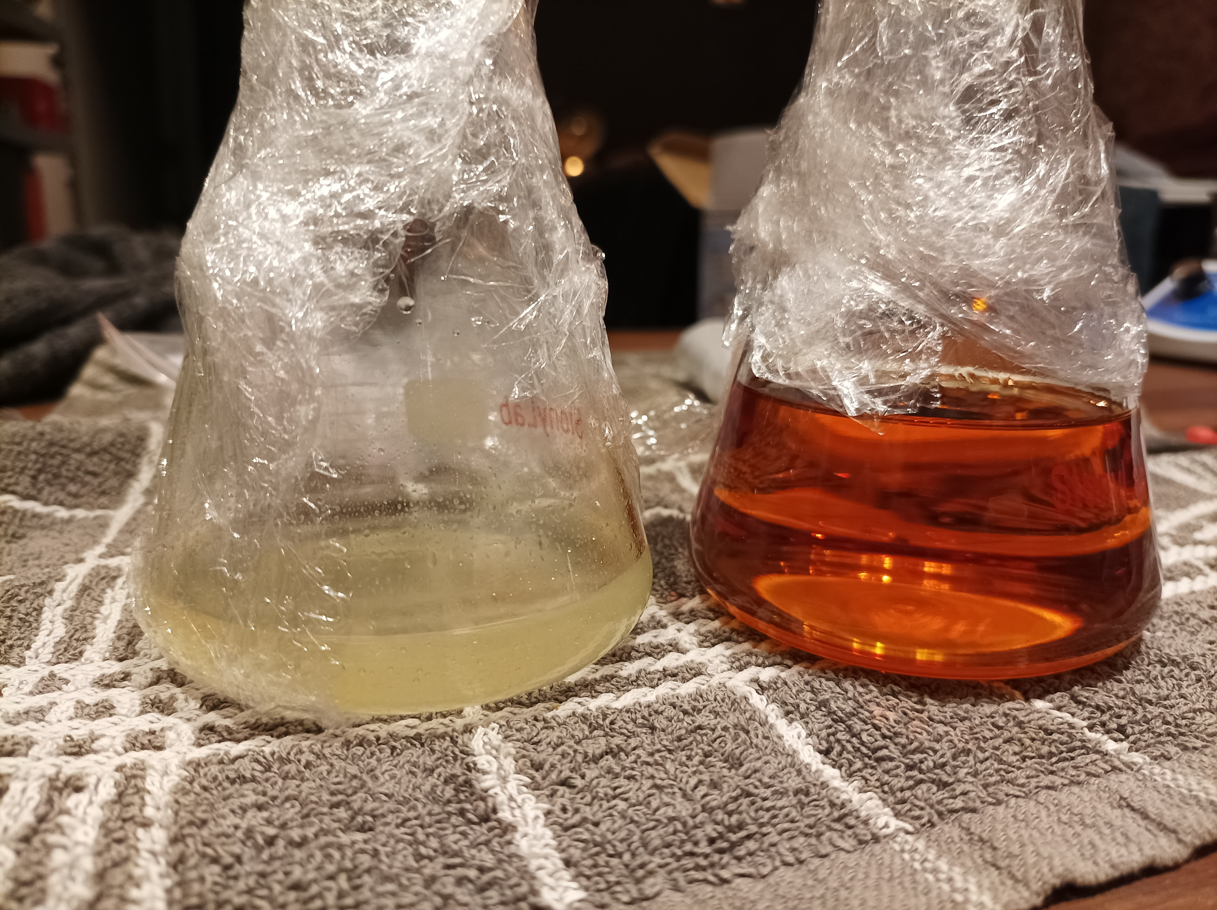

Ok thanks, this is the actual result
AdonZYRDhv
G97Syz0uR6
Sooo , i let dry all; keep all and it's my final p2np ?
or i need to purify another time?
sorry for a lot of noob questions :), the second try will be more professional haha
Mclssmxxl
Mar 28, 2022
74
I think maybe you still have a lot of impurities because of how red your isopropanol got, I would do another, but it’s your call.It’s probably gonna yield something atleast if you wanna go at it.

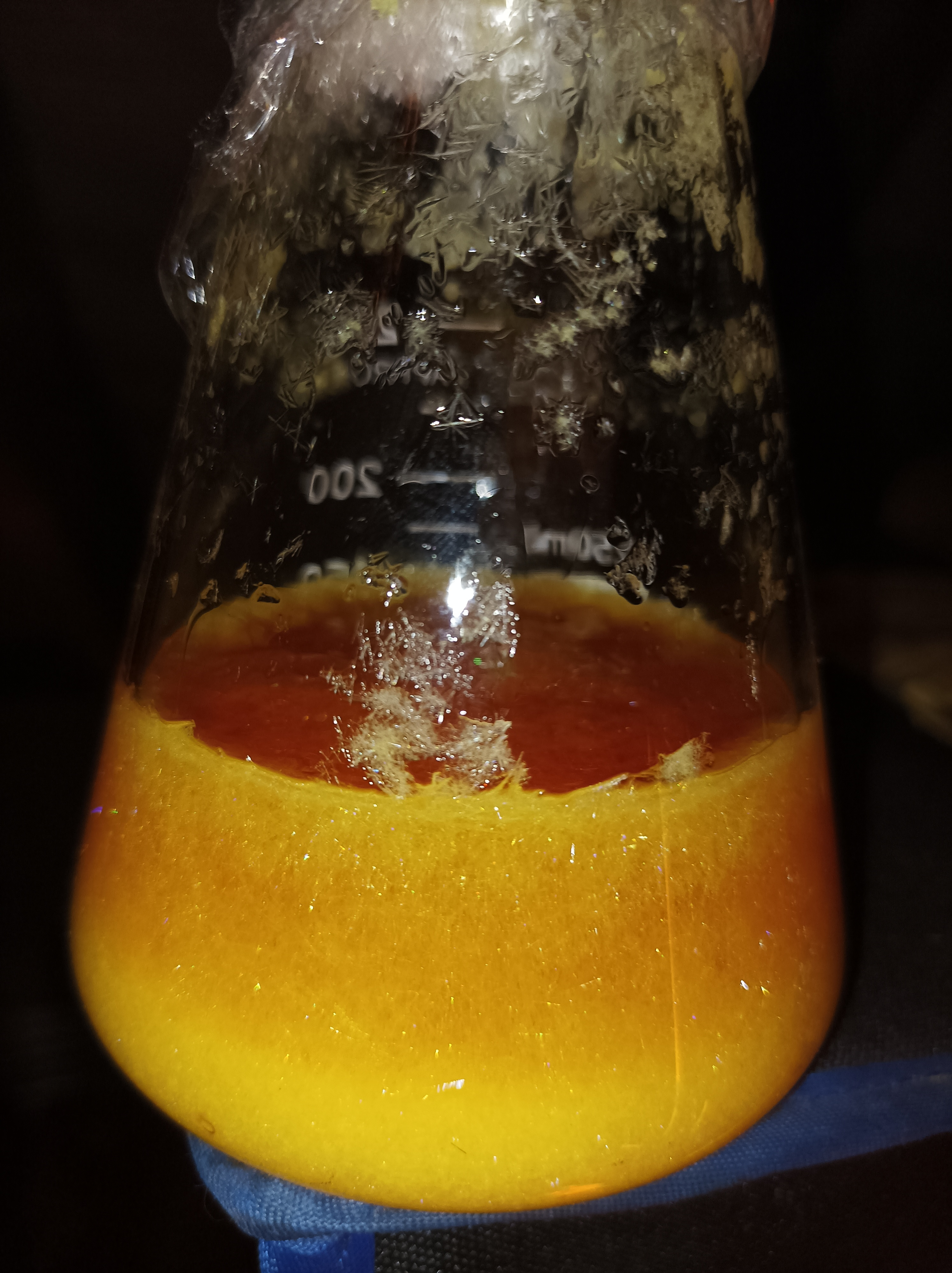

So I mixed all my product in 100ml of isopropanol at 60-70°C for 30-40 min. at rest I got 2 layers (no picture), a translucent orange and an opaque yellow.
now i'm waiting...
but after only one hour, I have the impression that the crystals are already forming.
I have the impression that it expands, inflates
MShaU5PC3x
I have to leave the flask open for evaporation for 24 hours or not?
before filtering...
