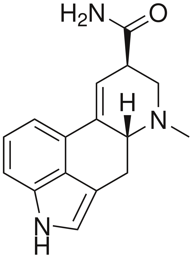

The seeds of many species of morning glory contain ergoline alkaloids such as the psychedelic Ergonovine and Ergine (LSA, d-lysergic acid amide). Seeds of Ipomoea tricolor and Turbina corymbosa (syn. R. corymbosa) are used as psychedelics. The seeds of morning glory can produce a similar effect to LSD when taken in large doses, often numbering into the hundreds. Though the chemical LSA is not legal in some countries, the seeds are found in many gardening stores; however, some claim the seeds from commercial sources can sometimes be coated in some kind of pesticide or methylmercury (although the latter is illegal in the UK and the US).

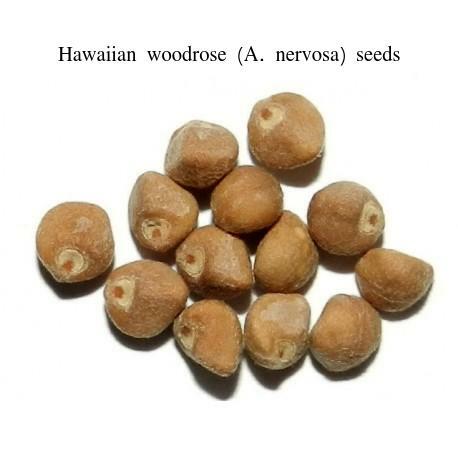

  • 150 grams of Morning Glory seeds or baby Hawaiian woodrose (A. nervosa) seeds;

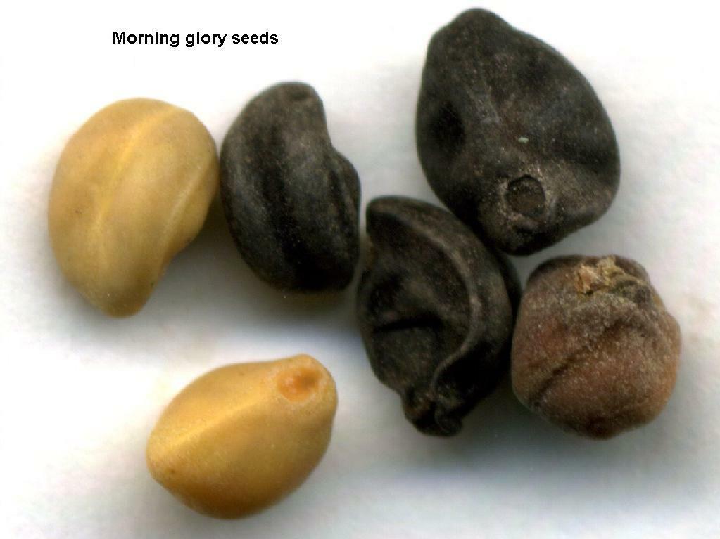

1) Grind up 150 grams of Morning Glory seeds or baby Hawaiian woodrose (A. nervosa) seeds.

My friend also read in the AC that Morning Glory seeds are often treated with pesticides that destroy the naturally occurring Ergot alkaloids. My friend purchased Pearly Gate Morning Glory seeds and planted them in his garden. When the plants began to produce seeds, my friend began gathering them and removing the loose outer shell. He eventually gathered *30 grams* of shelled seeds according to the directions.

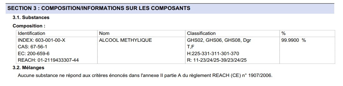

this methanol is ok ? (in my area they sell it as methanol)
85i0Tzh1gU
full french info in the pdf
  • FQgc9lwtAG.pdf
ACAB
Mar 27, 2022
287
167
Always look for the CAS Number
CAS 67-56-1 is Methanol, right.
