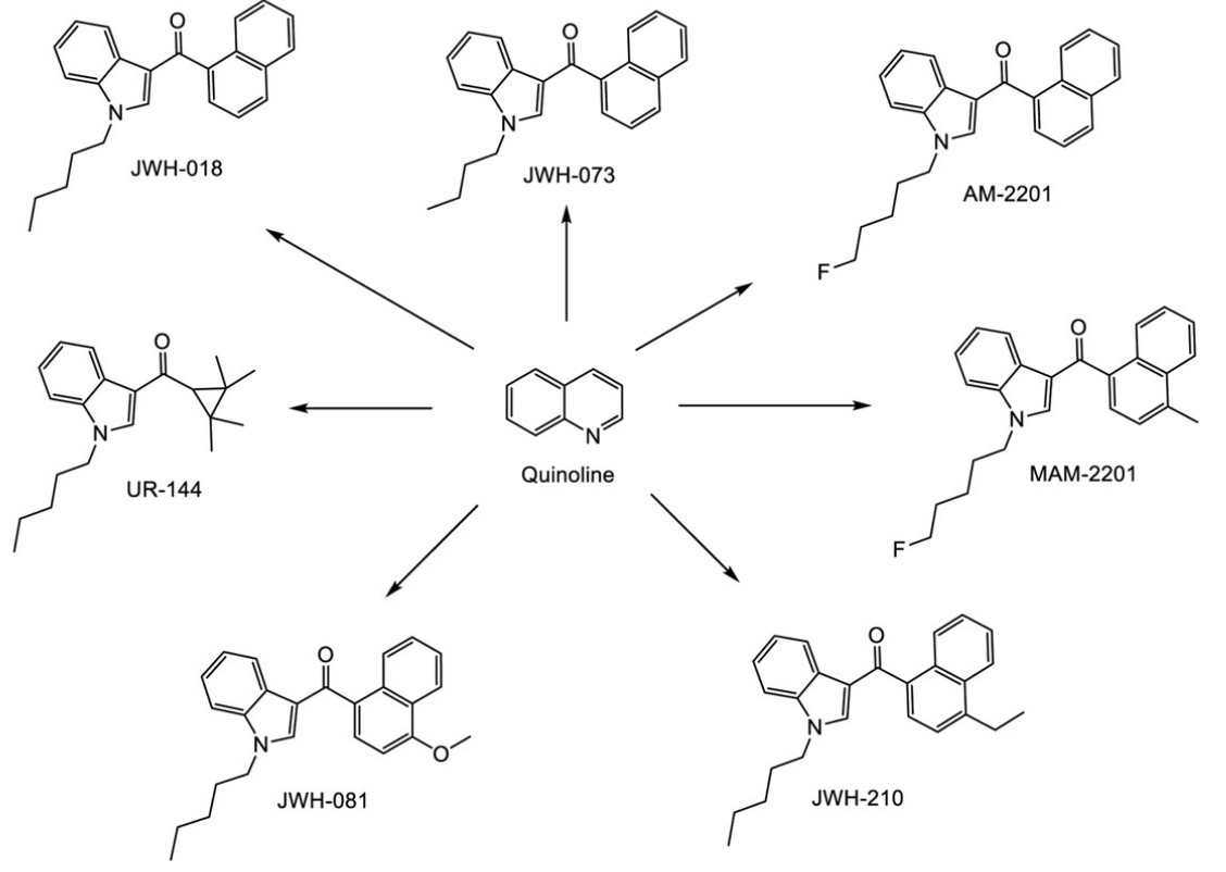

Figure 1 further illustrates examples of three common breakdown tendencies across the pyrolysis of synthetic cannabinoids. The first is a break on either side of the central carbonyl group, commonly present in synthetic cannabinoids. This breakdown trend produces pyrolytics such as indole or naphthalene products. The second trend, predictable due to the weak C–N bond, is the loss of the substituent group bonded to the nitrogen of the indole or indazole ring structures. An example of this in Figure 1 is 3-naphthoylindole. The majority of synthetic cannabinoids have either an indole or indazole ring structure, and with the pyrolytic ring size increase, they convert to a quinoline or cinnoline ring structure, respectively. These breakdown or conversion trends can be used for a prediction model for the thermal degradation of the continually evolving generations of synthetic cannabinoids. The detection of these products could not be used to indicate the use of synthetic cannabinoids in general or possibly limit the search to a structural class such as naphthoylindoles, indazoles or tetramethylcyclopropyls. Figure 2 shows an example breakdown of the different parent synthetic cannabinoids that produced the pyrolytic, quinoline. It can be noted that each parent compound includes an indole group, and this type of trend could be exploited to limit a search to those with an indole moiety if quinoline was detected during analysis if additional information points toward synthetic cannabinoid use.
Fig. 2 Chart displaying each parent synthetic cannabinoid that produced quinoline.
