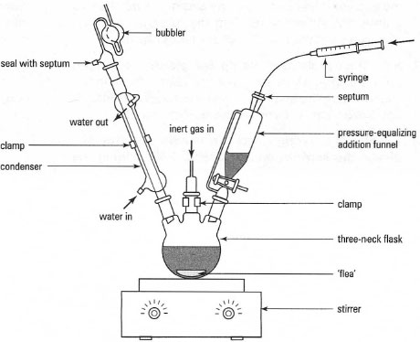

Experimental Set-Ups.
Reactions are set up in the same way as non-air-sensitive reactions, but with either a three-necked flask or Schlenk flask instead of the traditional round-bottomed flask. Schlenk flasks have a tap to connect the apparatus to the inert gas line and control the access to inert gas, while a three-necked flask requires an additional adaptor for this purpose. The simplest way to set up a reaction is to assemble all the glassware first and then apply to evacuate and refill cycle to ensure an inert atmosphere before adding the reagents. However, it is possible to fill each piece with equipment separately and assemble the kit with a positive flow of inert gas coming from each piece of glassware, i.e., there is sufficient gas flow into the apparatus that a steady stream is emitted when a stopper is removed, for example. This is more time-consuming, but can be a useful technique if you need to add or remove a piece of glassware midway through an experiment (see below). Typical reactions set-ups are shown in Fig.2.
Another difference compared with air-stable chemistry is that all the ground-glass joints must be greased to ensure an airtight seal and prevent contamination by O2, for example. In organic chemistry labs, it is often recommended to leave joints ungreased, as grease can enter the reaction mixture and contaminate the reaction and spectra. For similar reasons, joints should not be over-greased when doing air-sensitive chemistry. A fine layer of grease applied evenly is better than a thick layer that seeps out of the top and bottom of the joint. To get a thin layer, apply two stripes of grease, on opposite sides of the male joint of any glassware, insert into the neck or female joint and rotate the two parts gently to evenly distribute the grease (Fig.3). There should be a clear, continuous film between the surfaces of the joint.
Occasionally, it will be necessary to add or remove a piece of glassware, such as an addition funnel, during the course of the reaction. To add a piece of glassware, ensure that it is clean and dry of any cleaning solvent or water and all joints are greased. Attach it to the inert gas line and fill it. Ensure there are two positive flows of inert gas, i.e., the gas is flowing out of the vessel: one flow coming from the reaction vessel and the other from the glassware to be attached. Once there is a steady stream of inert gas flowing from each part of the apparatus, the stopper from the reaction vessel can be removed, and the glassware added in its place. To remove glassware during a reaction, simply ensure there is a positive flow of inert gas coming from the reaction vessel before removing the glassware and replacing it with a stopper or cap.

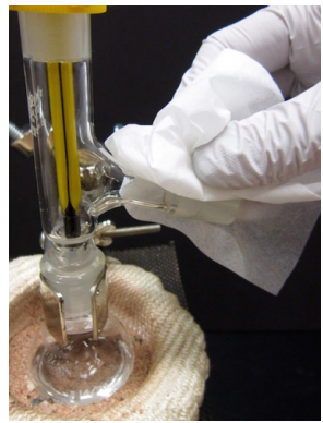

Greasing Joints.
Ground glass joints are manufactured to fit quite well with one another, and yet they are not perfectly airtight. In some situations (e.g. when using reduced pressure inside an apparatus or inert atmosphere), grease must be applied to each joint to ensure a good seal. Grease is also used whenever the joint may be in contact with a highly basic solution, as basic solutions can form sodium silicates and etch glass.
Grease can be applied with a syringe full of grease (Fig.4 a), wood splint, or toothpick. Grease should be lightly applied in portions around the male joint, closer to the glass end than the end which will be in contact with reagents (Fig.4 a). If grease is allowed near the end which will contact the reagents, there is a possibility the reagent will dissolve the grease and become contaminated. The female joint should then be connected, and the joints twisted to spread the grease in a thin layer. The joint should become transparent all the way around the joint, but to a depth of only one-third to one-half of the joint (Fig.4 b). If the entire joint becomes transparent or if grease is seen spilling out of the joint, too much grease has been using (Fig.4 c). Excess grease should be wiped off with a KimWipe (one is used in Fig. 5).
To clean grease from a joint after a process is complete, wipe of the majority of the grease using a paper towel or KimWipe. Then wet a KimWipe with some hydrocarbon solvent and rub the moistened KimWipe onto the joint to dissolve the grease (Fig. 5). Hydrocarbon solvents (e.g. hexanes) work much better than acetone to dissolve residual grease.

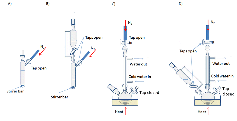

A) Solid Addition Tube
A solid addition tube is a simple piece of glassware similar to a test tube but with a bend in it and with a ground-glass joint suitable for placing inside the neck of a reaction vessel (Fig. 13). Some have a Schlenk or Young's tap to allow control of the internal atmosphere and gas flow. The air-sensitive compound is placed in the tube in a glovebox (see above) and the tube is sealed with a cap or stopper depending on the type of joint (Fig. 6, A). Once outside the glovebox, the tube is attached to the inert gas line using the standard procedure. The cap is the removed under a positive flow of inert gas and the tube is inserted into the neck of the flask also under a positive flow of inert gas (Fig. 6, B). The tube can then be rotated or gently tapped to encourage the solid to fall into the reaction vessel. If you are using a solid addition tube without a tap, a secondary stream of inert gas can be introduced using the set-up shown in Fig. 6, C. This provides an inert-gas blanket during the opening and attaching of the tube to the flask. This technique is also useful if you need to open an ampule of air-sensitive solid.
B) Adding an Air-Sensitive Solid as a Solution.
Perhaps the simplest and most effective way of adding an air-sensitive solid is to weigh it into a separate, clean, dry Schlenk flask under an inert atmosphere and dissolve it in a suitable solvent. The resulting solution can then be added to the reaction mixture via a cannula (see below).

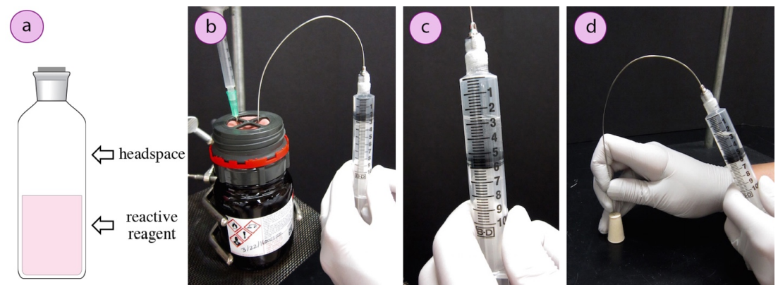

Withdraw the reagent.
15. A balloon of inert gas must be inserted into the reagent bottle in order to equalize pressures during withdrawal of liquid. A platform (e.g. ring clamp/wire mesh) should also be used beneath the reagent bottle if positioned above the bench, to provide support in case the bottle slips from the grasp of the clamp.16. Insert the needle of the flushed syringe into the septum of the air-sensitive reagent, and into the liquid (Fig.11 a).
17. Slowly withdraw some liquid into the syringe. If the plunger is pulled back too quickly, the low-pressure inside the syringe may cause air to seep through the joint between the needle and syringe (through or around the Teflon tape or Parafilm).
18. Inevitably, a bubble will form in the syringe. Keeping the syringe upside down and vertical (Fig.11 b), push on the plunger to force the gas pocket back into the bottle.
19. Slowly withdraw liquid to 1-2 ml greater than the desired volume (Fig.11 c), then keeping the syringe vertical, expunge liquid back to the desired volume (Fig.11 d shows 2.0 ml of liquid). Withdrawing greater than the desired volume at first allows you to be confident that no gas bubbles are in the needle, and that you have measured an accurate volume.
20. The needle should be full of the air-sensitive reagent at this point, and if it were removed from the bottle, the reagent would come into contact with the atmosphere at the needle tip. This can have disastrous consequences if the reagent is quite reactive (smoking or potentially fire). Safety note: It is therefore essential that a "buffer" of inert gas (Fig.13) is placed between the air-sensitive reagent and the atmosphere before removing the needle.
21. To create the "inert gas buffer":
a. Place the needle into the headspace of the reagent bottle (Fig.12 a+b).
b. Keeping the syringe upside down and vertical, gently pull back on the plunger until a bubble is seen in the barrel (approximately 20% of the syringe capacity, Fig.12 c). Immediately insert the syringe into the reaction flask septum if nearby, or into a rubber stopper if the flask is a distance away (Fig.12 d).

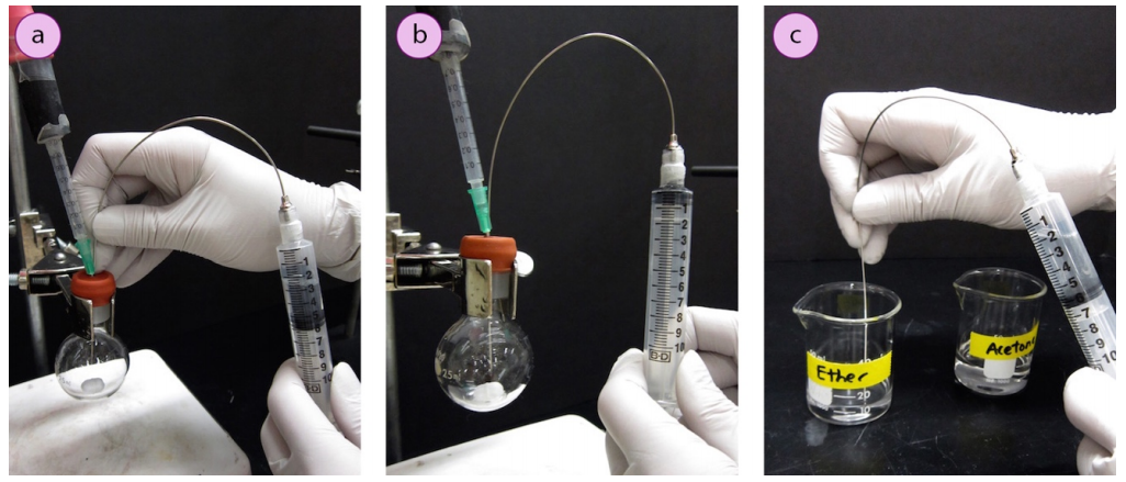

Clean the needle and syringe.
25. The syringe and needle should be cleaned as soon as possible, as over time deposits may form in the needle, creating a plug. To clean the syringe and needle:
a. Withdraw into the syringe a few ml of clean solvent similar to the solvent used in the air-sensitive solution (Fig.14 c). For example, the pictures in this section show transfer of a BH3 reagent dissolved in THF. An ideal rinse solvent would then be THF. As THF was not available, diethyl ether was a good substituted as the two solvents are structurally similar (they are both ethers).
b. Expunge the solvent into a waste beaker. Repeat with another solvent rinse, being sure to rinse the entire area in the syringe where the reagent touched.
c. Rinse the syringe once with water to dissolve and remove any inorganic salts.
d. Further, rinse the syringe and needle twice with a few ml of acetone.
e. Remove the needle from the syringe and retain for future use. The plastic syringe should not be reused, but instead thrown away: solvent present in many air-sensitive solutions degrade the rubber plunger on the syringe, causing them to swell and be ineffective after one use.

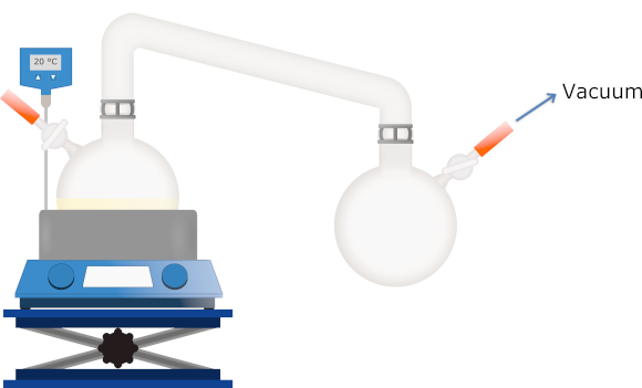

Dynamic air-free distillation
Dynamic air-free vacuum distillations are routinely employed to purify high-boiling liquids (>150 °C), air sensitive substances and some low-melting solids. This method is well suited for commercially available reagents or compounds prepared on a large scale in the laboratory in which the (often known) impurities are non-volatile and so remain behind after distillation.
Fig.18
Step-By-Step Procedures
Step 1: The impure material is transferred to a suitable Schlenk flask equipped with a magnetic stir bar. For commercially available reagents to be purified in bulk, this can be added to a Schlenk flask (that has already been cycled onto the inert gas line) under a flow of inert gas. For “in-house” prepared compounds, the crude material will typically remain in the Schlenk flask after removing the solvent and volatiles in vacuo.
Step 2: A Schlenk flask, distillation bridge and Schlenk cap are greased, assembled and cycled onto the inert gas line. Note: The style of distillation bridge (single-piece) illustrated is designed specifically to purify high-boiling liquids under high-vacuum. This differs from a typical distillation setup with a distillation head, thermometer adapter, and water-cooled condenser.
Step 3: Once the receiving Schlenk flask and distillation bridge has been cycled onto the line and back-filled with inert gas, it is connected to the Schlenk flask containing the crude material. This may require a brief helping hand to remove clips and stoppers. Ensure that inert gas is flowing into both flasks during this process to minimise exposure to atmospheric air and moisture.
Step 4: The stopcocks on both Schlenk flasks are closed and the distillation flask is lowered into a suitable heating mantle or oil bath. With stirring, the stopcock on the receiving Schlenk flask is slowly and carefully opened to vacuum. This serves to degas the crude material and remove any residual solvent or volatile impurities. Note: The bulk material should be sufficiently high-boiling so that it does not evaporate at ambient temperatures whilst under vacuum. An external liquid nitrogen trap can be used between the receiving flask and inert gas line to condense any volatile compounds.
Step 5: Once a good vacuum (i.e. low pressure) has been established within the distillation setup, and the crude material is fully degassed, the temperature on the heating mantle can slowly be increased. Since the crude material does not evaporate at ambient temperature, an ice bath is generally sufficient to cool the receiving flask and condense the distillate, however a dewar of liquid nitrogen can also be used. During the distillation, it may be necessary to insulate the flask and part of the bridge with aluminium foil, or to briefly heat the glassware with a heat-gun.
Step 6: Once the distillation is complete, the stopcock is closed on the receiving flask. The heating mantle is lowered to allow the distillation flask to cool to ambient temperature, and the cooling bath is removed from the receiving flask to allow it to thaw or warm to ambient temperature.
Step 7: When the distillation apparatus is at room temperature, the system is slowly backfilled with inert gas. If an external trap was used, it is necessary to disconnect this first and cycle the receiving flask back onto the inert gas line.
Step 8: Under a flow of inert gas, the distillation bridge can be removed from the receiving flask and replaced with a clean, greased ground-glass stopper. The purified material can now be transferred to a suitable ampoule for storage via cannula transfer, or used directly for further manipulations.
