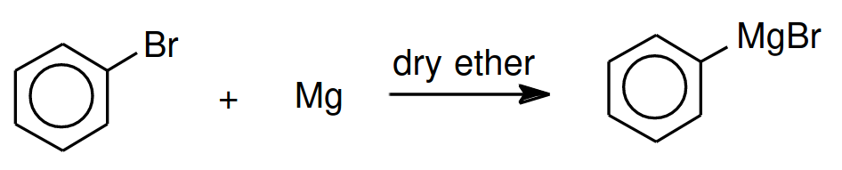

A Grignard reagent has a formula RMgX where X is a halogen, and R is an alkyl or aryl (based on a benzene ring) group. For the purposes of this topic, we shall take R to be an alkyl group (e.g., BuMgBr). Grignard reagents are made by adding the halogenoalkane to small bits of magnesium in a flask containing diethyl ether. The flask is fitted with a reflux condenser, and the mixture is warmed over a water bath for 20 - 30 minutes.
Everything must be perfectly dry because Grignard reagents react with water (see below). Any reactions using the Grignard reagent are carried out with the mixture produced from this reaction. You can't separate it out in any way.

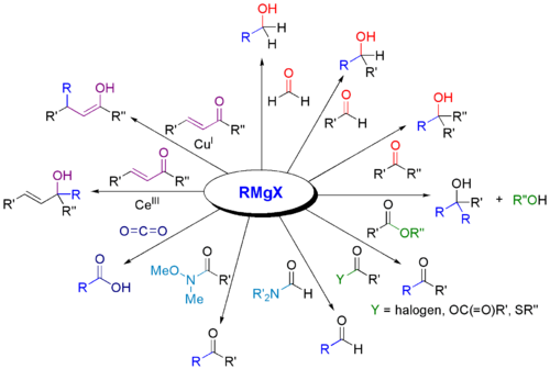

General Reaction between Grignards and carbonyls.
The reactions between the various sorts of carbonyl compounds and Grignard reagents can look quite complicated, but in fact they all react in the same way - all that changes are the groups attached to the carbon-oxygen double bond. It is much easier to understand what is going on by looking closely at the general case (using "R" groups rather than specific groups) - and then slotting in the various real groups as and when you need to.
The reactions are essentially identical to the reaction with carbon dioxide - all that differs is the nature of the organic product. In the first stage, the Grignard reagent adds across the carbon-oxygen double bond:
Dilute acid is then added to this to hydrolyse it. (I am using the normally accepted equation, ignoring the fact that the Mg(OH)Br will react further with the acid).
An alcohol is formed. One of the key uses of Grignard reagents is the ability to make complicated alcohols easily. What sort of alcohol you get depends on the carbonyl compound you started with - in other words, what R and R' are.
Grignard reagents are widely used for the synthesis of various classes of organic compounds. Some examples are presented below.Why do Grignard reagents react with carbonyls?

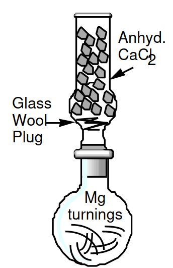

The Grignard reagent is prepared by first fitting a dry 250 ml round-bottom flask with a CaCl2 drying tube. The magnesium to be used (2 g = 0.082 moles of magnesium turnings) is placed in the flask, the calcium chloride tube is attached directly, and the flask is heated thoroughly with a large heating mantel and rheostat. Adjust the controller for a large heating mantel to setting ‘6’ and heat the flask until it is too hot to touch with your finger. The flask on cooling pools dry air through the calcium chloride. Remove the heating mantel and cool to room temperature (the flask should feel just slightly warm to your hand, or cooler) before proceeding. Remove the calcium chloride drying tube and pour into the 250 round bottom flask 15 ml of absolute ether and 9 ml (13.5 g = 0.086 moles) of bromobenzene. Replace the CaCl2 drying tube. If there is no immediate sign of reaction, initiate the reaction by crushing some of the magnesium turnings. This is done by inserting a dry stirring rod with a flattened end and carefully crushing a piece of magnesium firmly against the bottom of the flask under the surface of the liquid, giving a twisting motion to the rod. When this is done properly, the liquid becomes slightly cloudy, and rapid bubbling commences at the surface of the compressed metal. At this point add 25 ml more of absolute ether and attach a reflux condenser to the flask and the CaCl2 tube to the top of the reflux condenser as shown in the picture.
Don't start running water through the condenser until ether vapors have wet the joint at the top of the condenser. When necessary, cool the flask by touching the bottom of the flask with an ice-bath to slow the reaction, but don't use it unless it is necessary. It is necessary only if ether vapors are exiting the top of the drying tube. If you do have to cool the reaction, be careful not to slow the reaction down too much, or it may stop and not start again when the ice is removed. Swirl the flask vigorously every sixty seconds. Once the reaction begins, spontaneous boiling in the diluted mixture may be slow or become slow. If so, add a few additional mls of bromobenzene to the flask. The reaction is complete when the ether quits bubbling and only a few small remnants of metal remain. Mark the ether level in the flask. During the reaction, check to see that the volume of ether has not decreased. If it has, add more dry ether. Since the solution of the Grignard reagent deteriorates on standing, the next step should be started at once.

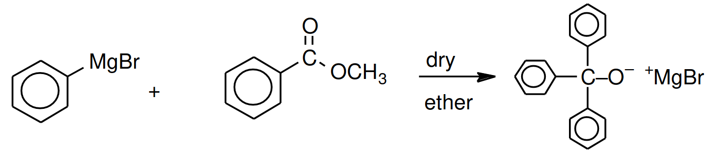

Condensation of the Grignard Reagent with Methyl Benzoate.
Mix 5 g (0.037 mole; 1.09 g/ml) of methyl benzoate and 15 ml of absolute ether in a separatory funnel, cool the flask containing the Grignard reagent solution briefly in an ice bath. Remove the drying tube, and insert a Claisen adapter and a separatory funnel into the top of the condenser, as shown at right. Run in the methyl benzoate solution dropwise, over a ten-minute period, with only such cooling as is required to control the exothermic reaction. The product salt separates as a white solid during this step. Swirl the flask at regular intervals until the reaction has subsided, and the flask is at room temperature. Go directly to the next step.

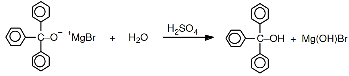

Pour the reaction mixture carefully into a 250 ml Erlenmeyer flask containing 50 ml of 10% sulfuric acid and about 25 g of ice. Use a few mls of ordinary (non-anhydrous) ether and a few mls of the 10% sulfuric acid to rinse the reaction flask. Add these washings to the Erlenmeyer flask. Swirl well to promote hydrolysis of the addition compound; basic magnesium salts are converted into water-soluble neutral salts, and triphenylcarbinol is distributed into the ether layer. An additional amount of ether (ordinary) may be required if your original ether layer has become too low through evaporation. You may stop at this point if there is not enough time to complete the next part. Store the labeled Erlenmeyer in the hood with a lightly fitted cork(not rubber) stopper. The stopper should be loose enough that any gas pressure from evolving hydrogen gas will be released.

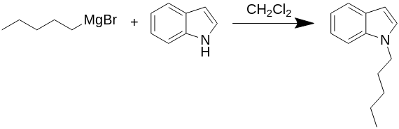

The Grignard reagent is used in the synthesis of several surfactants. For example, in the synthesis of synthetic cannabinoids for the attachment of an alkyl group to the indole nitrogen atom (see JWH-018 Synthesis example). The reaction proceeds rather quickly under mild conditions and does not require heating.

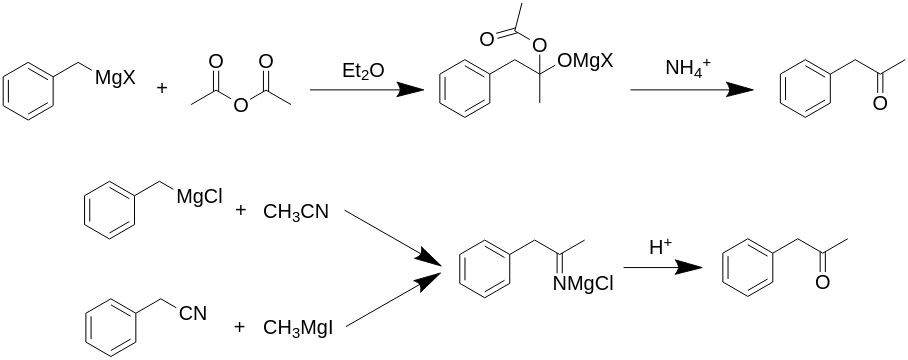

The nucleophilic addition of the Grignard reagent allows for some non-specific and stereospecific reaction to produce amphetamine and its precursor such as phenyl-2-propanone (P2P).

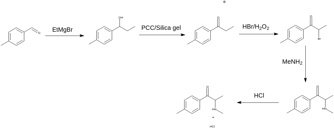

Another method of application of Grignard reagent is use in route to mephedrone (4-MMC) synthesis using 4-methylbenzaldehyde as the starting material.

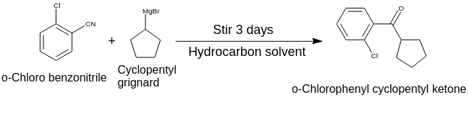

In addition to previous variety of applications, this popular approach is utilized in Ketamine synthesis step of (o-chlorophenyl)-cyclopentyl ketone manufacturing.
