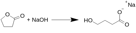

Transformation Gamma-Butyrolactone to Sodium Gamma-Hydroxy Butyrate (Na-GHB).
The reaction proceeds equimolarly (the same number of each molecule reacts), and there are no byproducts produced in this reaction, such as hydrogen gas, water, or anything else as proposed in several other texts. All published preparations of GHB, or more correctly Na-GHB, refluxes butyrolactone with sodium hydroxide in various solvents, usually in aqueous alcohol, but this is not necessary.
