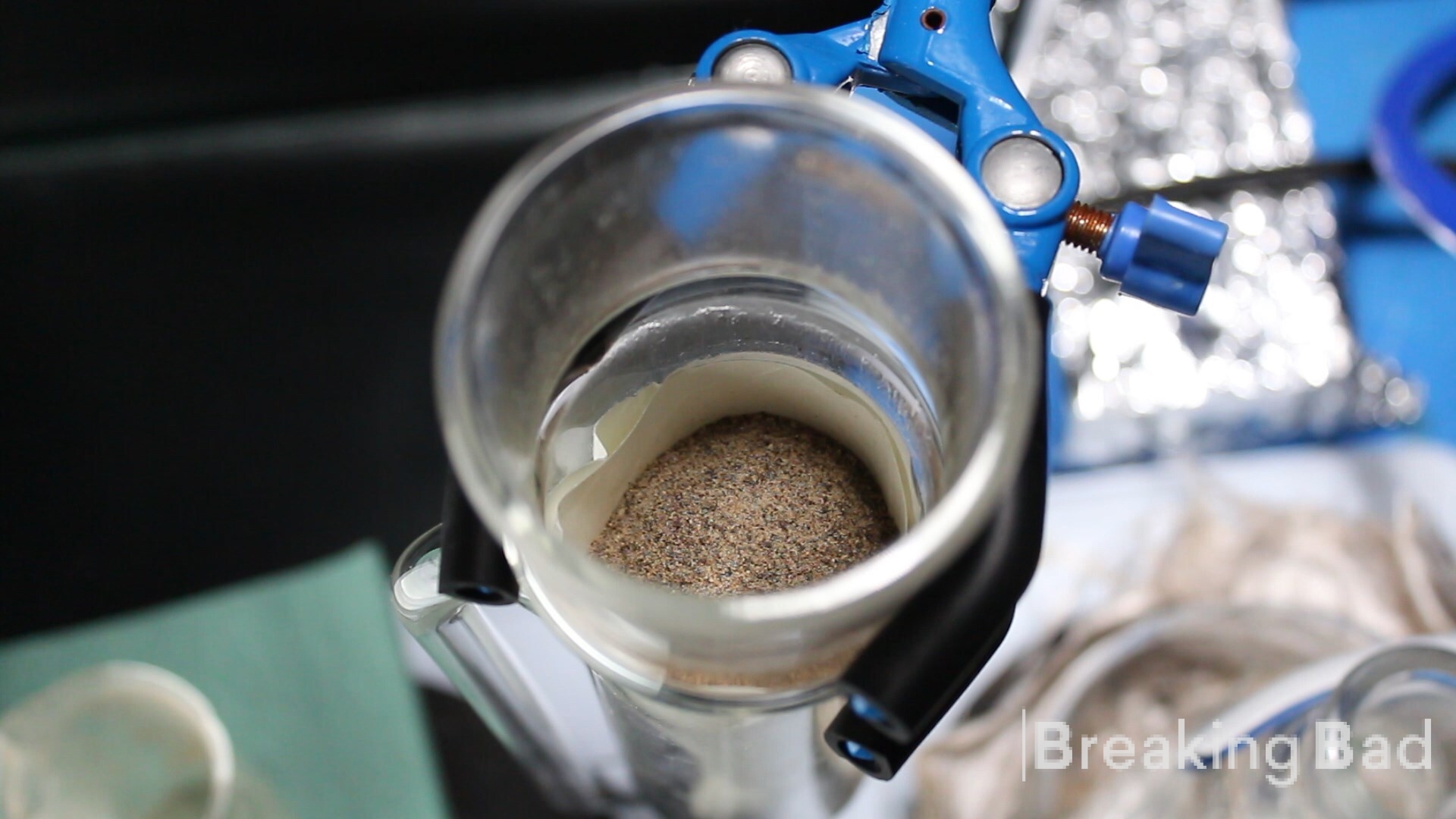

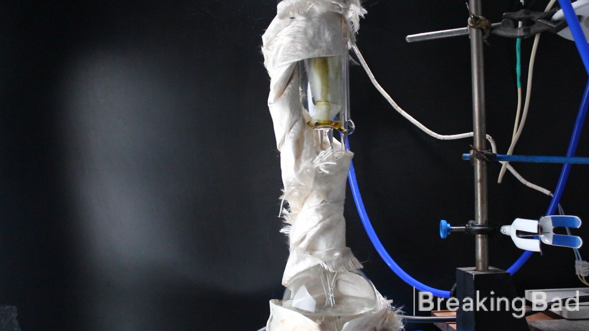

Pour 300 ml of 88% ethanol into a 500 ml flask.

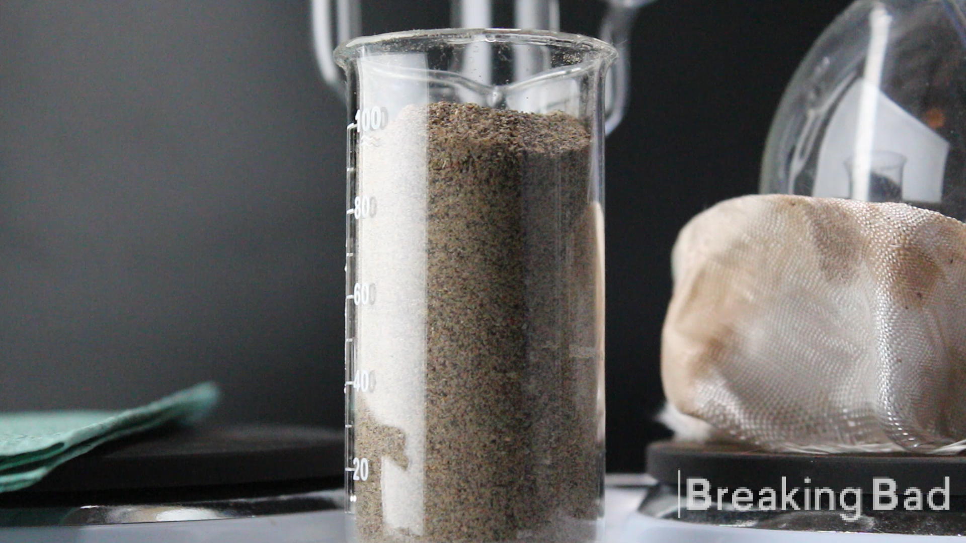

Place 60 g of ground black pepper in a paper extraction sleeve (180 mm in diameter).
UbsnLNwEKr
KcqFL981vp
Xeo9j6HnIh

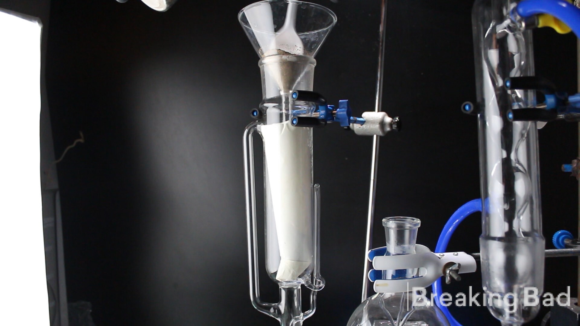

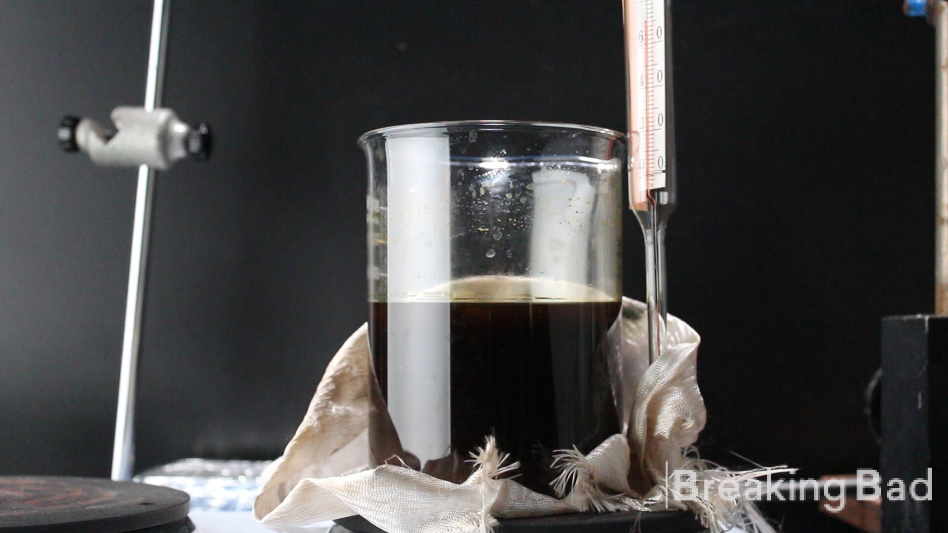

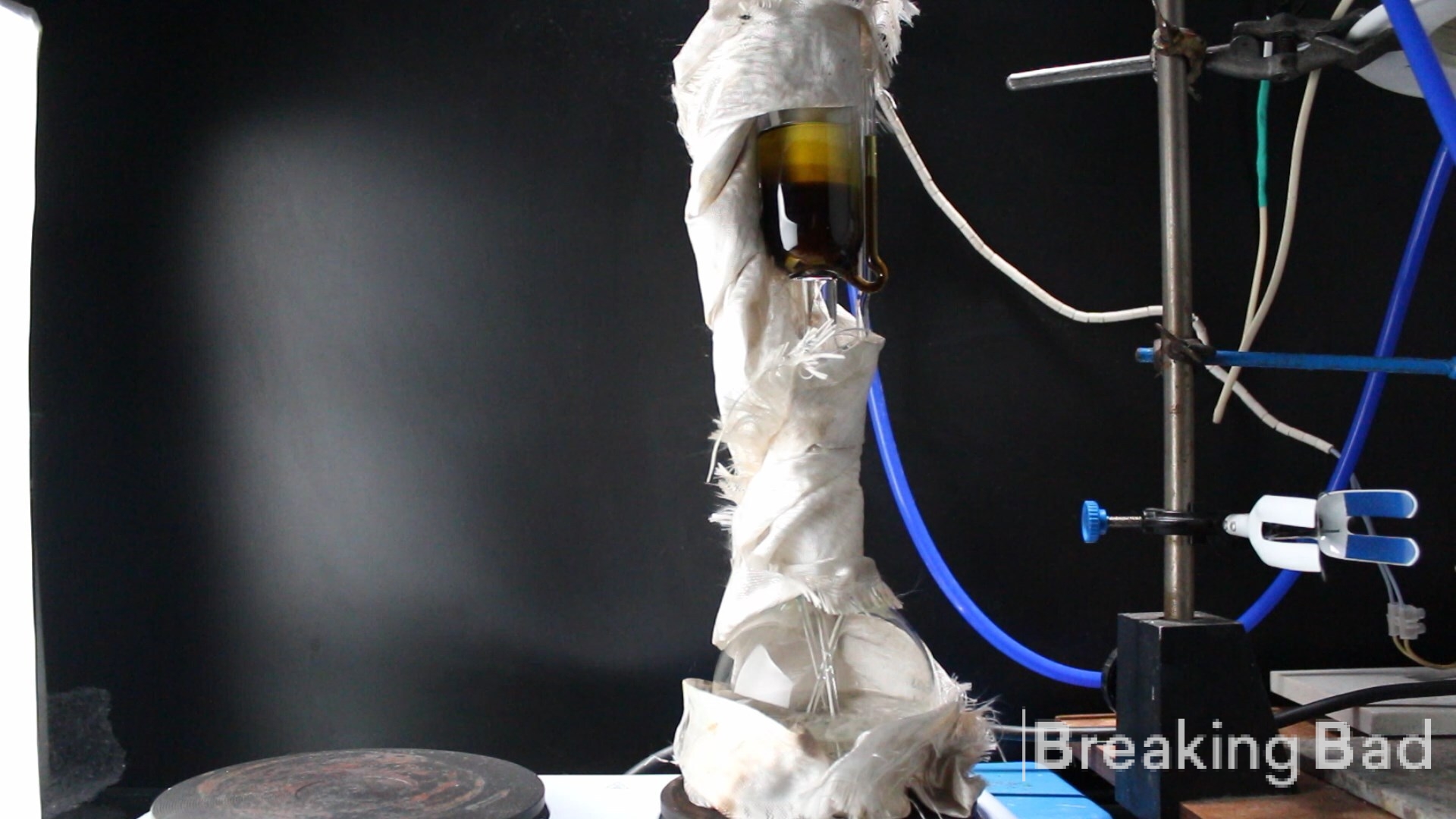

Assembling the apparatus for piperine extraction, the flask with ethanol was heated, and the reflux condenser was cooled.
NmLQeZNFzw
ECjAMD4zXe
PXfoi4hTtd
A2AqYSNovR
Each portion of pepper (60 g) was extracted until the condensing ethanol becomes colorless. Then, a new extraction was performed on the next portions of black pepper, each weighing 60 g, with the addition of 20 ml of fresh ethanol. In total, 5 extractions were carried out from portions of ground black pepper weighing 60 g each, which corresponds to the maximum saturation of ethanol with piperine.

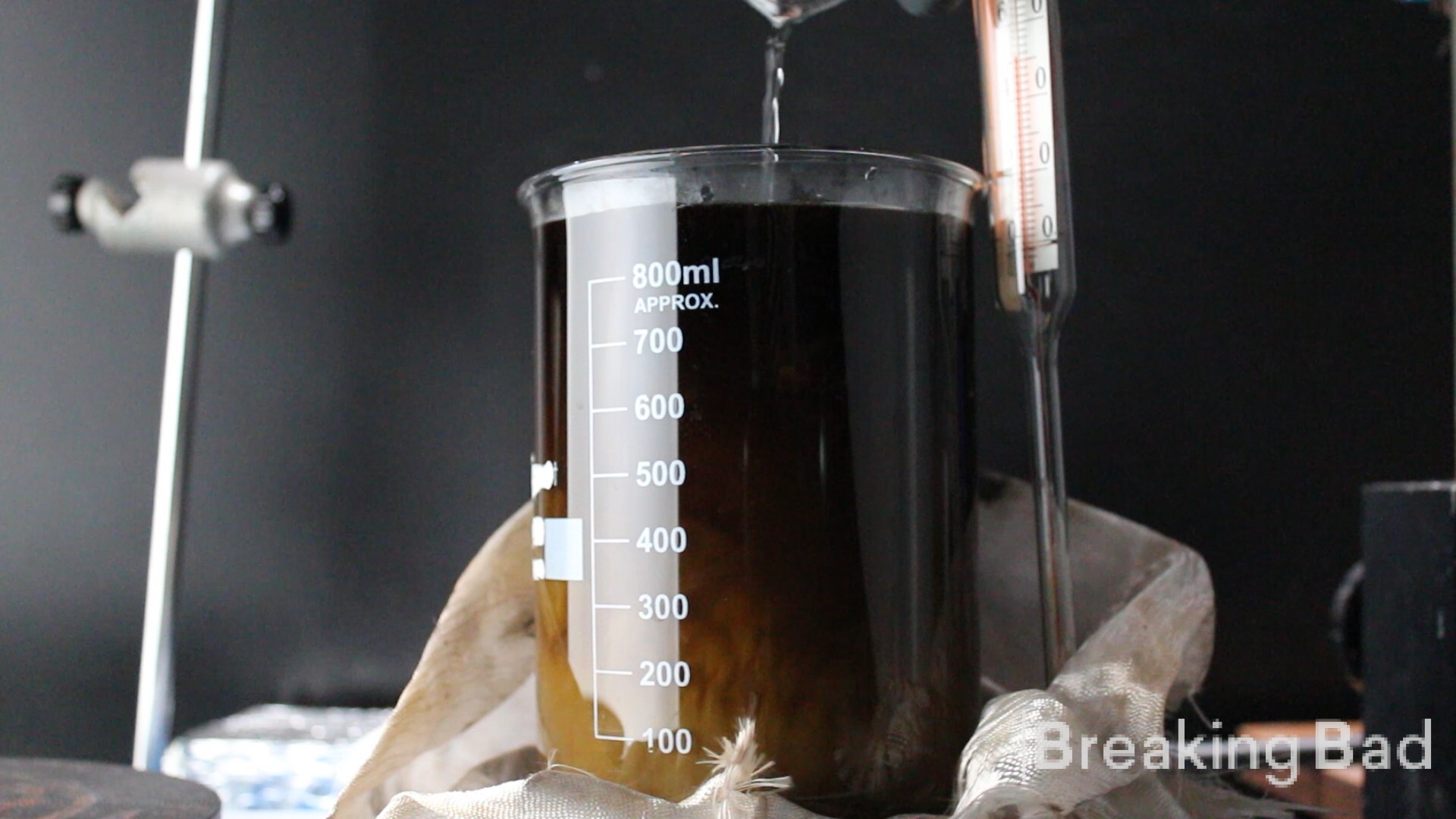

Stage 2: Piperine Precipitation
Reagents and Materials:

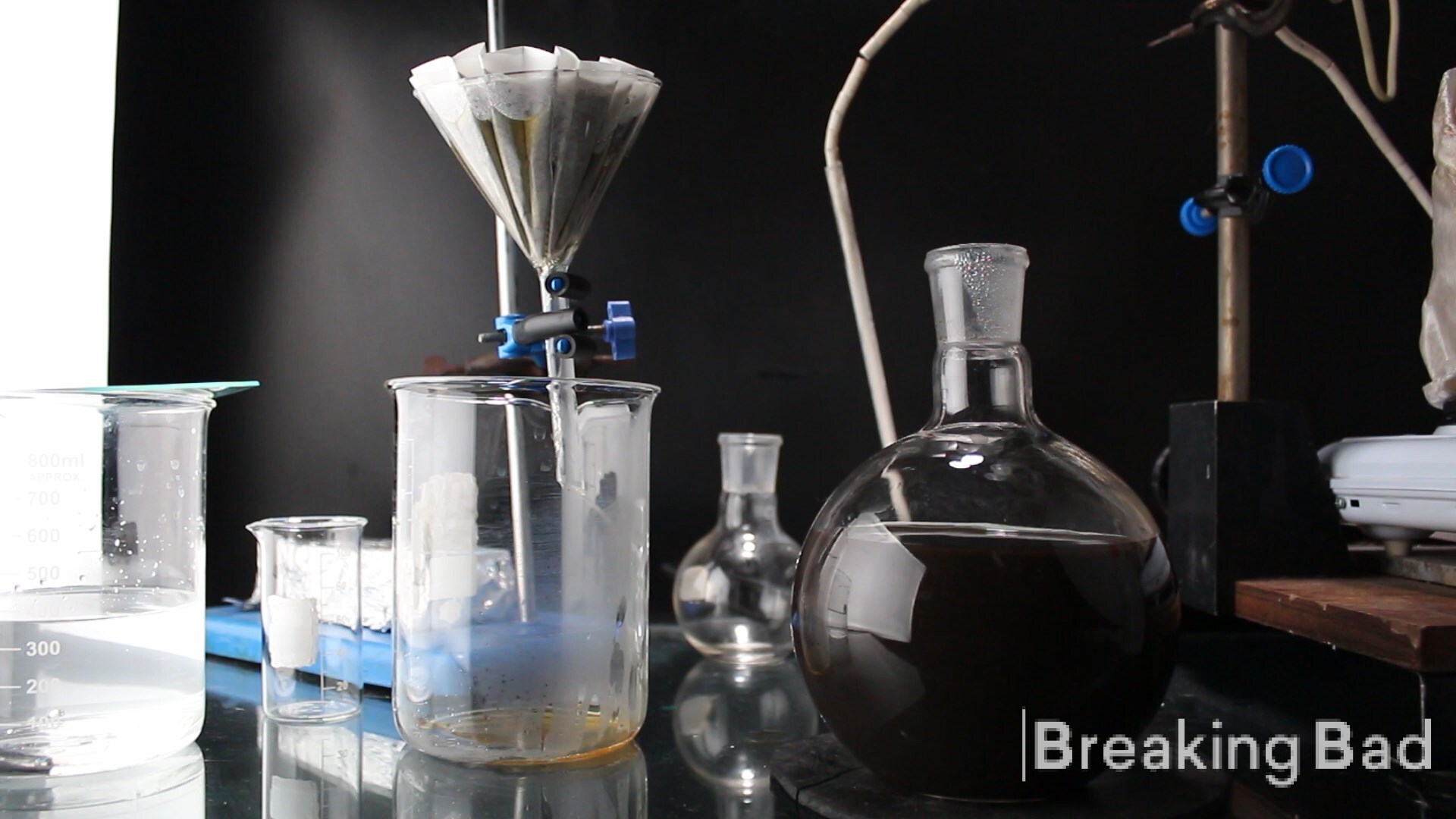

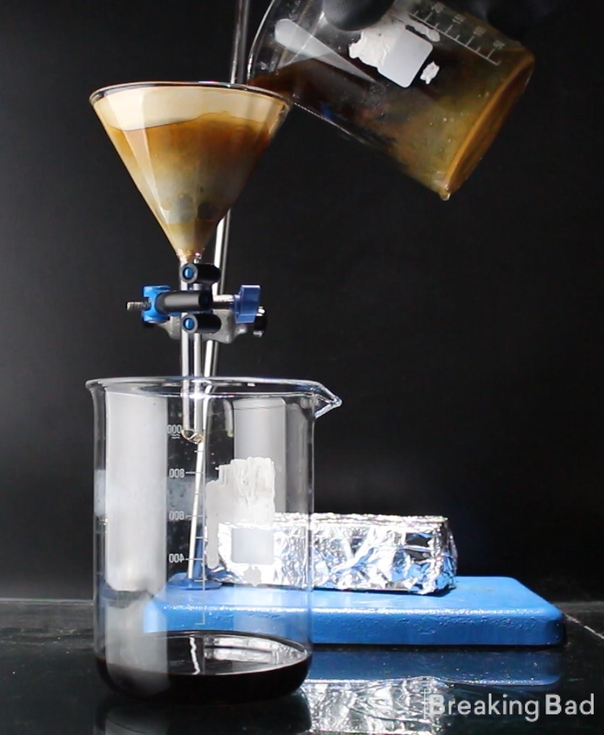

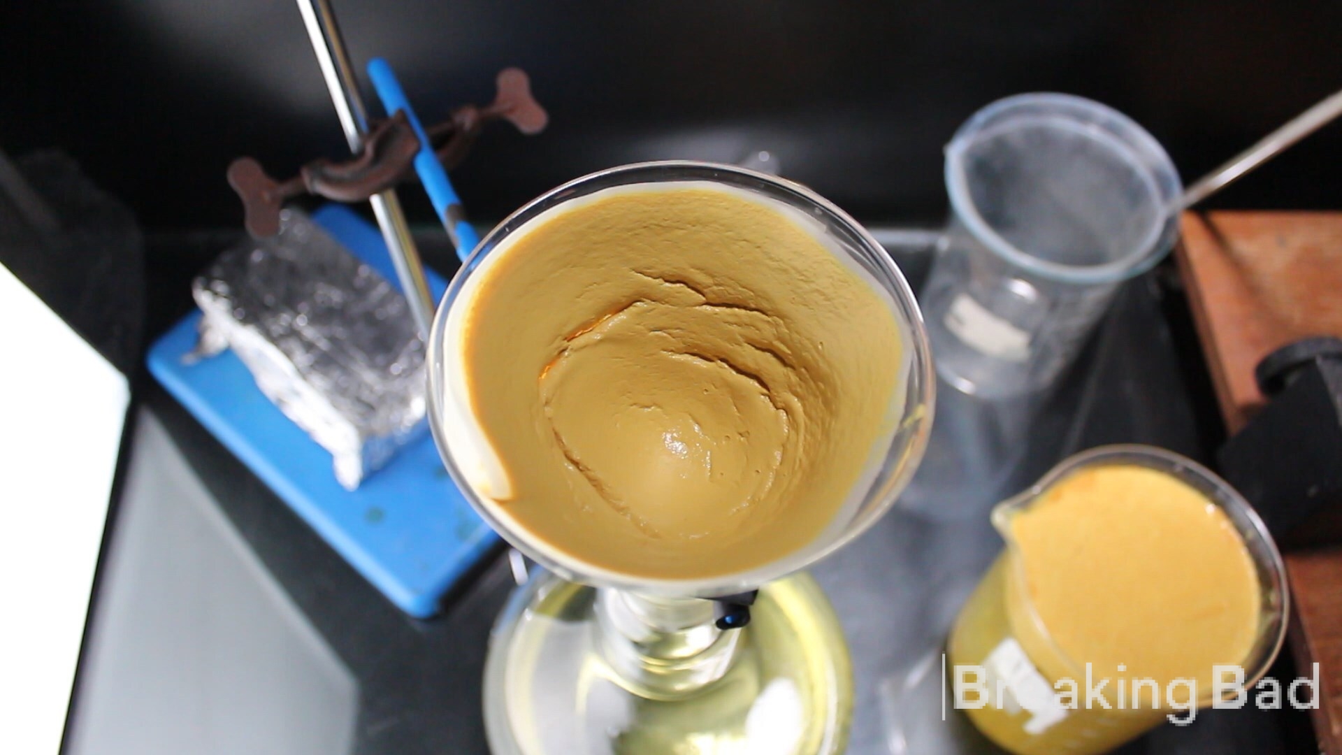

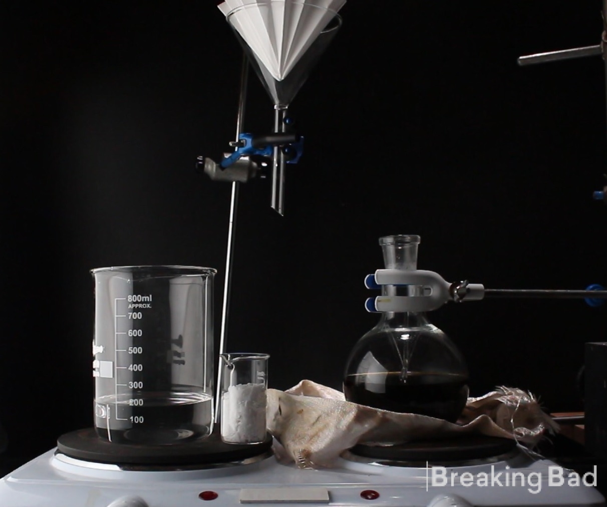

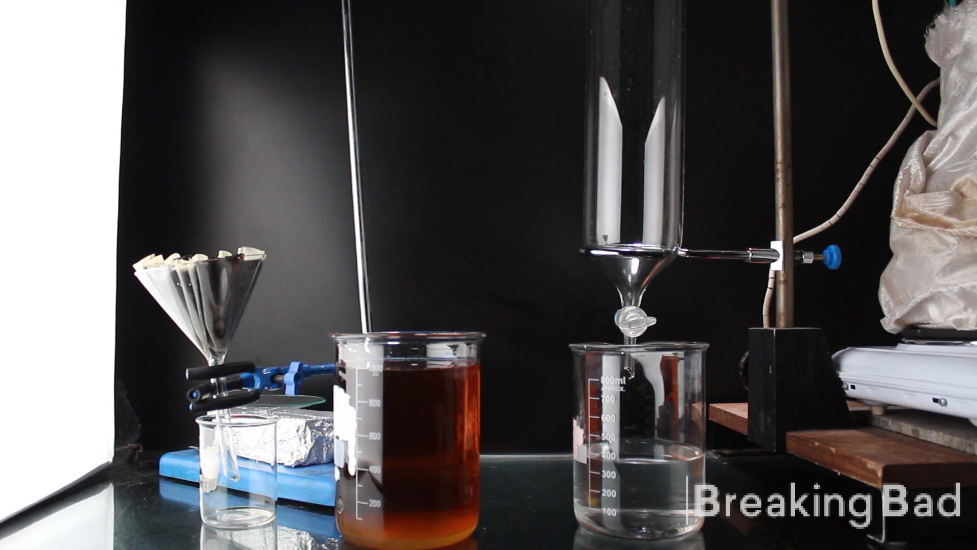

Potassium hydroxide (KOH) was dissolved in ethanol. The obtained black pepper extract was filtered through a paper filter directly into the prepared KOH solution.
34eCRYLcn9
Aa02P9bfFz
The obtained solution was heated to 60-70℃.
IUGeMYHajA

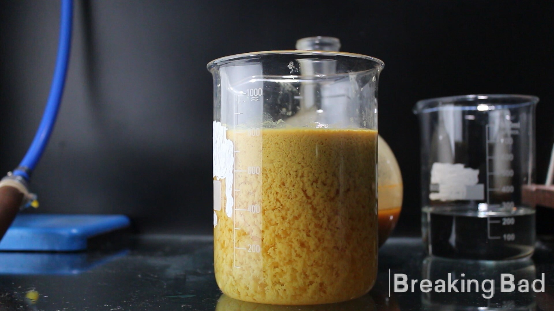

In the heated solution, water was gradually added in portions (about 1 liter) until the formation of yellow precipitate of piperine ceases.
PfHy4hmDnR
LZ0mya1BcK
O75IO6jKwL
The obtained suspension was cooled in a freezer until the next day and the precipitated residue was filtered out.
R4YutkrgjO
TM5plYLevu
The filtered precipitate of piperine was dried in a desiccator over alkali or under a heat gun until a constant mass was achieved. The precipitate should have a slight pepper odor and a melting point of 127-128°C.

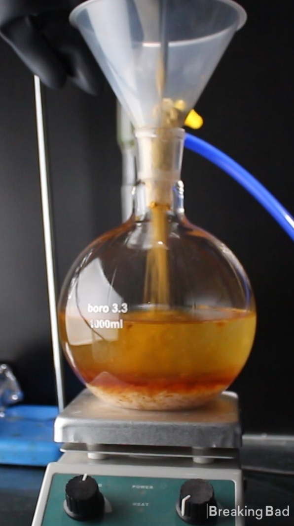

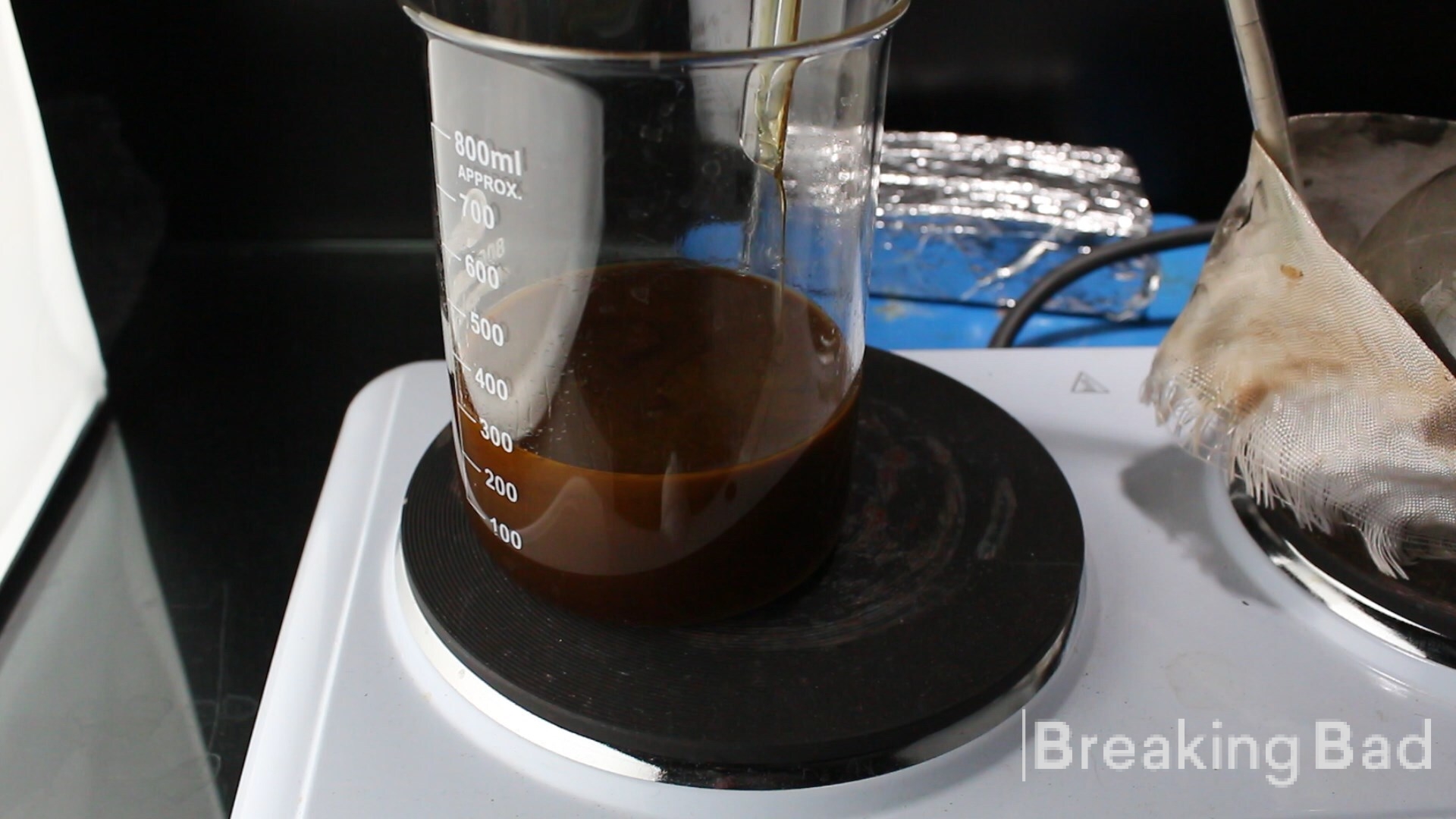

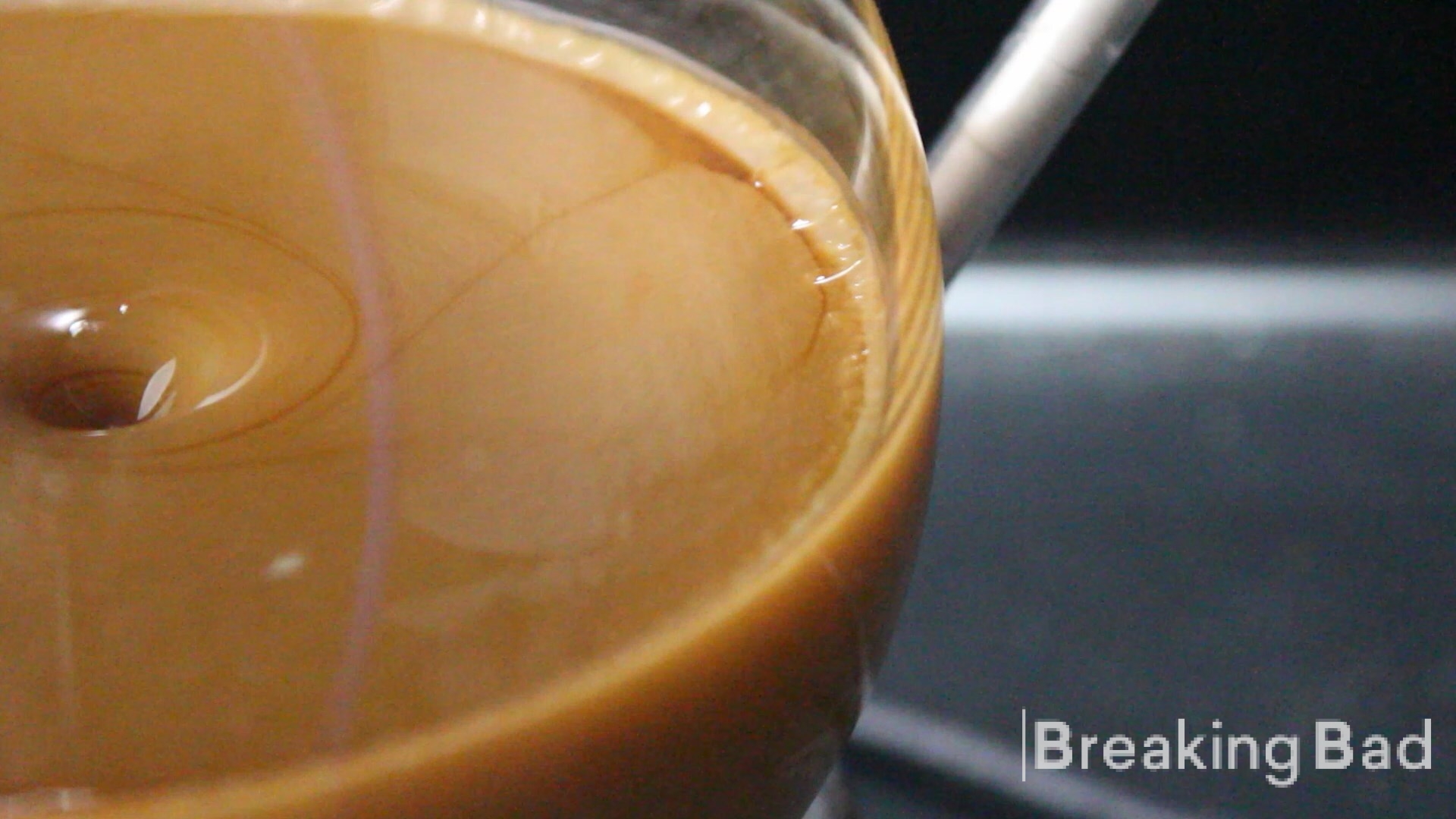

Ethanol, KOH, and piperine were added to a 1-liter flask. The mixture was stirred until dissolved and heated at 70-80°C for 10 hours.
HYumtRe4V0
WABnZditK7
3SJq9QinxE
The resulting warm suspension of potassium piperate was transferred to a beaker, and hydrochloric acid was added until complete precipitation of piperic acid occurs.

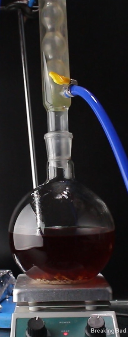

The solution of copper sulfate was mixed while adding the alkali solution, and then piperic acid was added. The solution was heated for 8 hours under a reflux condenser at a temperature of 80-90°C.
