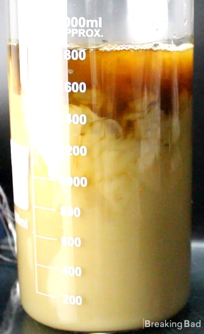

The heated solution is transferred to a large 2000 ml beaker. Fig 7
GqX6nHwDoW
Fig 7
Water is added to the solution until sediment formation stopped (~1400 ml water). Fig 8
5D8PnSjmVF
Fig 8
