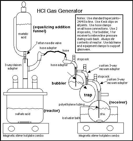

Dripping an affordable muriatic acid (HCl aq 31%) over concentrated sulfuric acid (H2SO4) is one of the best methods for producing a dry gaseous HCl, if it is necessary to quickly scaling. The reaction rate and temperature is easily controlled. Capacities are easily and quickly cleaned, and if necessary, immediately launches with a new portion of reagents. The method is well suited when you need large volumes of dry HCl immediately and quickly. It is better to use glass or plastic reactor or handmade analogs (barrels and stirrer devices).
Muriatic acid slowly drops to stirred sulfuric acid. Sulfuric acid is dehydicing muriatic acid, releasing dry gas. The released HCl is preferably skipped over a small amount of sulfuric acid in an intermediate container to remove traces of water. The obtained dry gas can saturate the available isopropyl alcohol for storage as anhydrous solution. By weight of the solution, it is possible to determine the concentration of the resulting solution (no more than 25% for IPA)
Recommended amount of sulfuric acid - 2 parts per 1 muriatic (31%) acid. The stirred during all time. The reaction can be seen bubbles in the receiver. Plastic tubes are suitable for gas. With the right proportions, almost all HCl is removed from muriatic acid.

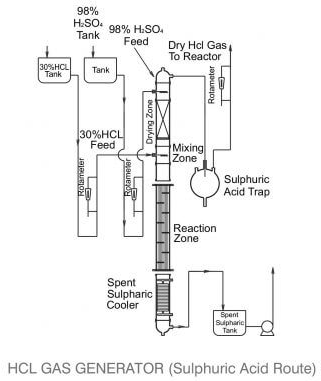

Example of an industrial reactor for this method

Example of a laboratory generator

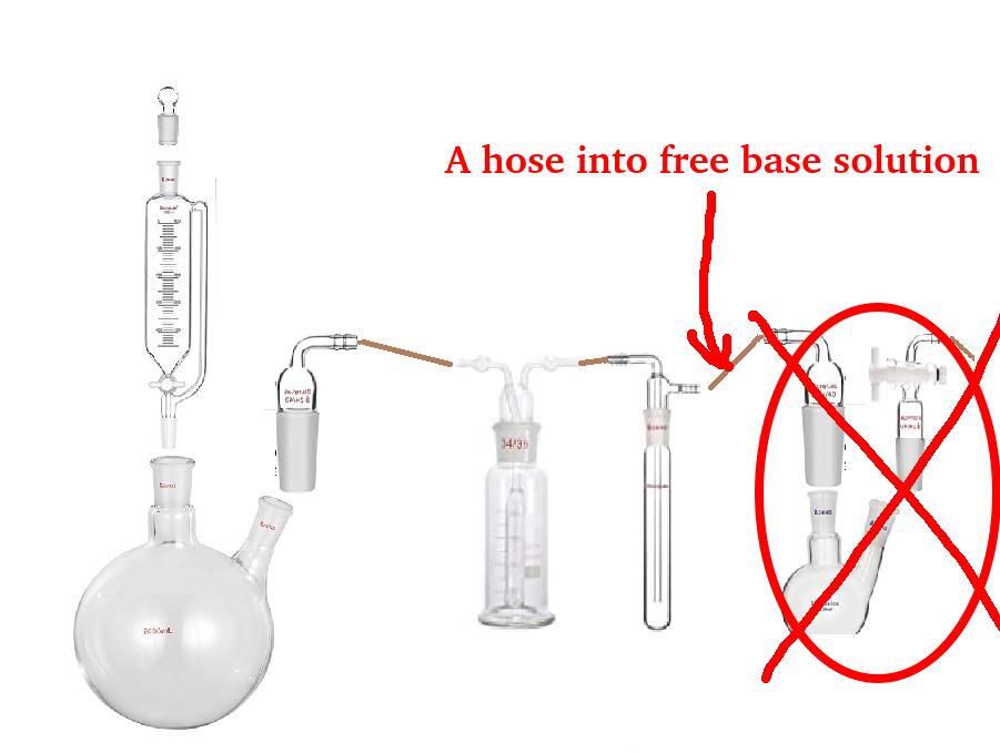

Hello,
i try to understand with all equipement i know how to do
after that i have done two "shema" , can you confirm me if all it's ok ?
N91EuoI6tD
FouHsLfiWn

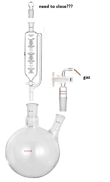

for the CaCl2 route the shema 2 is ok or i need to do somthing like the first one?
I imagine that my set-up is not perfect, but made with what I find on amazon, be indulgent ;)
3,081
3,537
LBCzucWgUj
Hi, ASheSChem. You have to close your pressure-equalizing dropping funnel. Also, you have to emerge hose with gas into a free base solution. Better to use traps by reason that it will increase yield but not significantly.

I told about 4-mmc or methamph syntheses, when you want to make HCl salt.
Yes, exactly. Water will dissolve product salt and yield will be lower.

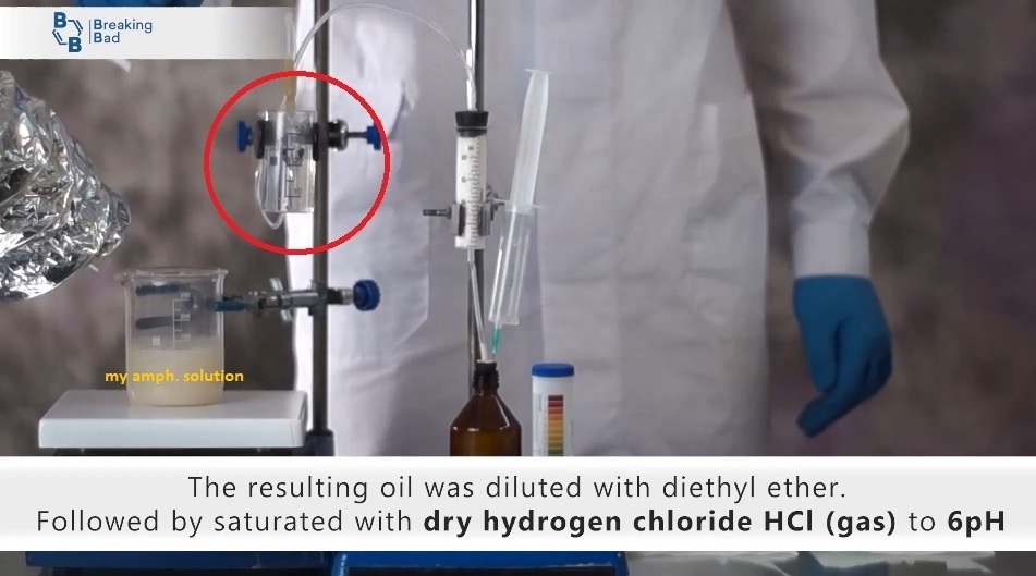

do you speak something like this ? what reagent it is ? (in the red circle)
UFRocIM5Vj
3,081
3,537
Yes
I can't say exactly what is used in this video. Probably CaCl2 and HCl acid. Syringe with CaCl2 is absorb water from gas. Empty syringe is used as gas volume indicator.

thanks @G.Patton
he put the hose with gaz in the red circle when he don't use it or i don't understand ? ^^
it is water?
