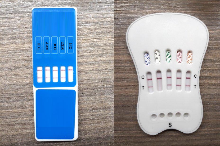

The main goal of this research is evaluation possibility of determination of main drugs in biological fluids by publicly available express methods at home. This article answers to following questions:
- Do pharmacy test for $3-20 really reveal the fact of using the declared substances? (Classical combined test strips contain scales for the determination of amphetamine, methamphetamine, cocaine, marijuana, opiates).
- Could these test strips be useful for Alpha-PVP and Mephedrone? (There are no specialized tests in pharmacies)
The reason of using most common pharmacy test, which easy to buy, is a that the research should be helpful and has practical application.
Important: another lateral flow tests (LFTs) kits with different labels could be used, a manufacturer company does not matter because any test kit stripes have same working mechanism and have comparable effectively.

The substances were used by volunteers who did not take anything psychoactive for a sufficient period of time, urine was taken for their analysis. Here are the results of the experiment.

If you look at the test on the right, you can see why the test strips have to handle with a critical point of view. The tested person has not recently used any PAS, except for cocaine.

There are MDMA / Ecstasy test strips available, but they are more difficult to find. Amphetamine and methamphetamine were found in urine. This is explained by their common belonging to the same class, and, accordingly, by the structural similarity of substances and their metabolites. The THC (cannabinoids) and OPI (opiates) scales on the second test do not participate in the experiment (not activated). According to the left photo, these substances are not detected in connection with the use of MDMA.

In addition to standard substances, another one test strip was used to test for barbiturates. There is clearly something wrong with this test stripe. The test was repeated by another volunteer who had never used barbiturates or preparations containing them, with a similar result.

The second line in the PCP window is almost completely absent.

Tests have been detecting drugs in body fluids for much longer than its psychoactive effect is felt. They are quite cheap, have good sensitivity, and are only marginally inferior to the methods used in the laboratory. Remember your safety - if there is a need to check your "cleanliness" yourself, express tests will be indispensable.
