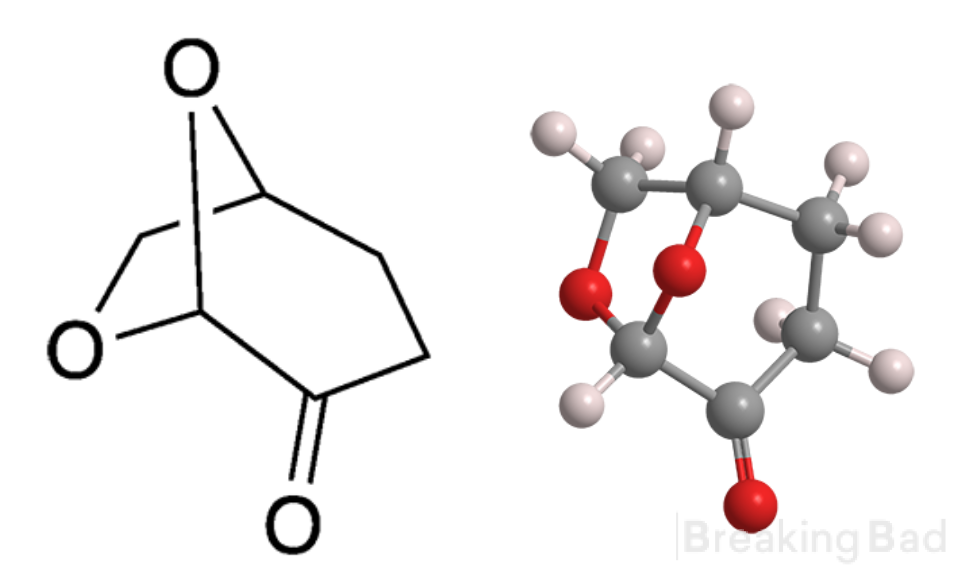

Cyrene structure

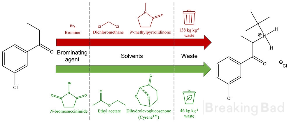

A laboratory experiment was developed to introduce systems thinking and green chemistry concepts through the synthesis of the cathinone antidepressant and smoking cessation aid, bupropion hydrochloride. The traditional synthesis has several issues from a green chemistry perspective: it uses the toxic solvents N-methylpyrrolidinone (NMP) and dichloromethane (DCM) and other hazardous chemicals including bromine and 12 M hydrochloric acid resulting in 138 kg of waste per kg of product. A greener synthesis has been developed with suitable improvements to the traditional procedure. The reprotoxic NMP and potentially carcinogenic DCM solvents have been substituted with the green biobased solvent Cyrene and ethyl acetate, respectively, and bromine has been substituted with N-bromosuccinimide. An alternate extraction method has also been developed using 1 M hydrochloric acid and ethyl acetate rather than 12 M hydrochloric acid and diethyl ether. These changes have also reduced waste by 92 kg kg–1, and the resultant experiment is much safer to perform.
Scheme 1. Bupropion hydrochloride synthesis

Bupropion hydrochloride is synthesized in a two-step process by brominating m-chloropropiophenone followed by amination with tert-butylamine and precipitating as its hydrochloride salt (as shown in Scheme 1), and it has already been reported as a suitable organic laboratory experiment. However, from a green chemistry perspective, there are several issues with the synthesis of bupropion hydrochloride. The reprotoxic solvent N-methylpyrrolidinone (NMP) is used, which is now restricted by the Registration, Evaluation, Authorization and Restriction of Chemicals (REACH) regulation. Dichloromethane (DCM) is also used, despite being a suspected carcinogen. Other hazardous substances are also required, including elemental bromine (fatal if inhaled), 12M hydrochloric acid (corrosive), and diethyl ether (extremely flammable and forms explosive peroxides). The quantity of waste produced by the reaction was determined using the green metric, E-factor, which includes all reaction masses except water to calculate the waste produced and is shown in eq 1. It was found that 138 kg of waste is produced per kg of product following the traditional synthesis route, whereas 25–100 kg kg–1 is typically produced on average in pharmaceutical industry processes

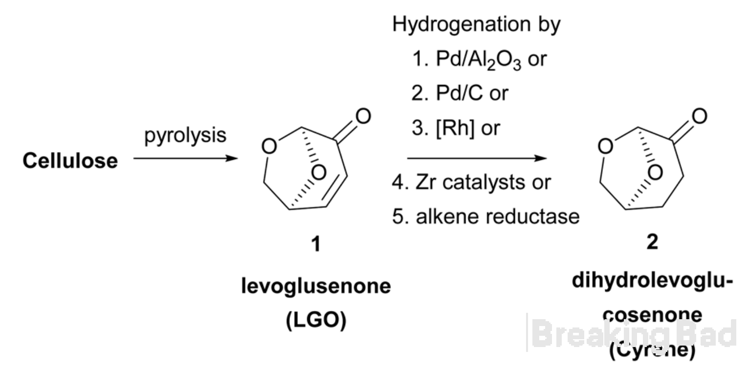

Cyrene synthesis from biomass
Dihydrolevoglucosenone or 6,8-dioxabicyclo[3.2.1] octanone is a cellulose-derived solvent, which can be synthesized in a twostep process from biomass. The first step for its synthesis was reported back in 1973 by Broido and coworkers, who characterized correctly the chemical structure of levoglucosenone (LGO), as a result of cellulose pyrolysis (Scheme 1). Although Cyrene was synthesized before, the first structural characterization of the molecule was incorrect. Since then, a lot of effort has been put in increasing the conversion of cellulose into LGO.
Scheme 2
Various methods have been developed concerning the pyrolysis of cellulose, mostly by investigating a wide range of acids to succeed in obtaining the highest yields. In 2011, the Circa group reported a thermal method which afforded LGO in 40% yield. The Circa group patented a method for the formation of LGO, which involves the catalytic pyrolysis of biomass using phosphoric acid in sulfolane. Having in hand the best results for producing the main precursor of dihydrolevoglucosenone, Circa initiated the industrial production of this promising derivative under the trade name Cyrene, and since then the interest in its use as a bio-based solvent has been gradually increasing.
The second and final step involves the reduction of levoglucosenone, by hydrogenation, to afford Cyrene (Scheme 1).
In this context, various palladium catalysts have been widely employed, such as Pd/Al2O3 or Pd/C; however, rhodium catalysts and zirconia-supported catalysts have been used as well. Moreover, a one-pot synthesis of Cyrene from levoglucosenone was suggested by Wang and coworkers, while in 2018, levoglucosenone was reduced to Cyrene using an alkene reductase.

Regarding its chemical structure, Cyrene is an optically active ketone composed of two fused rings, which form a cyclic acetal (Scheme 1). The ring fusion results in a double anomeric effect, which stabilizes the existence of the cyclic acetal. In general, acetals are stable towards bases and nucleophiles and Cyrene is very unstable toward strong acids and oxidizing or reducing agents. Cyrene is a colorless viscous liquid with a high boiling point (227 °C), which offers the possibility to mediate reactions taking place in a wide range of temperatures.
