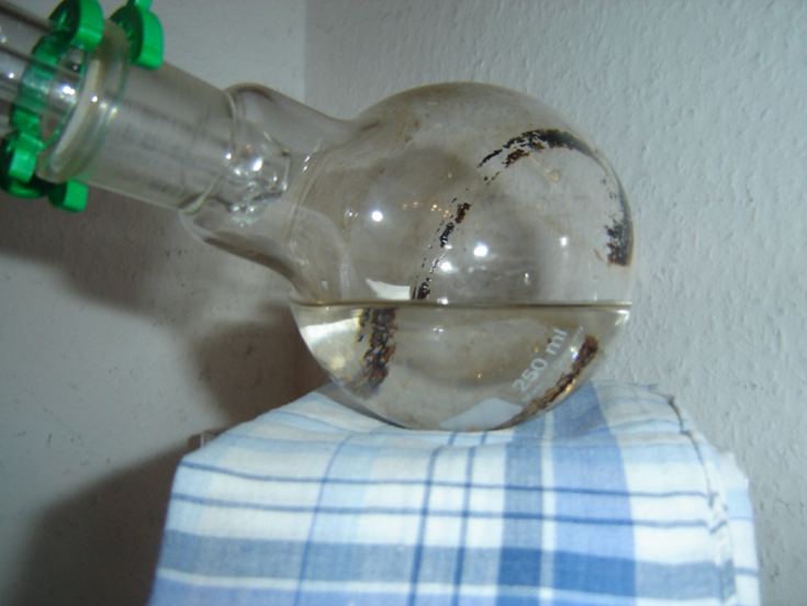

Here you can see the pure safrole in the flask which came over, it is water-white oil.
4EYPZhxilr
F0ShcUj8wa
Out of 90 ml of sassafras oil, 75 ml of safrole is distilled out. On the right, you see the tar and rest of the crap that is left in the distillation flask, this stuff doesn't come over, so apparently it will be a chemical that we have a boiling point greater than 300 *C.

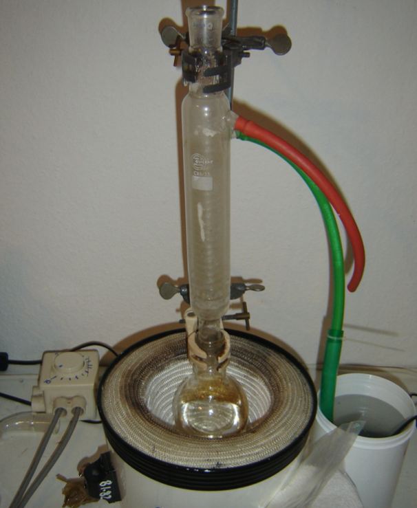

Glassware set up for reflux.
Reflux means that the cooler is put inside the flask upside down, and so when there are chemicals in the flask that can evaporate easily, they would normally evaporate and be gone out of the reaction when you heat it to let them react.
If you would placed a cooler on top of the flask, the chemicals which evaporate will cool down again and fall back down in the reaction flask.
That is in short the principle of refluxing.
The person who did this synthese let s call him SWIM poured the 75 ml safrole in the flask.
He added to this 30 ml 96% ethanol and 21,10 g of KOH.
SWIM refluxed it for 3-4 hours on a gentle reflux of 60 *C.

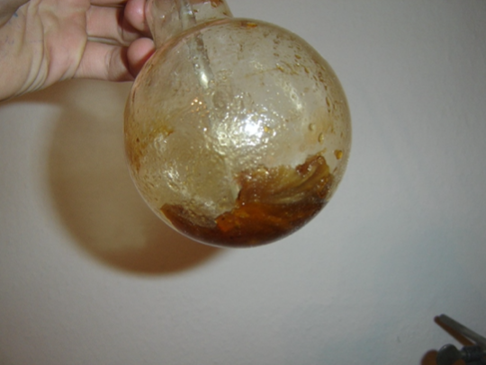

This is what is left after distilling the isosafrole, the yield was 80% by weight. It was 66 ml.

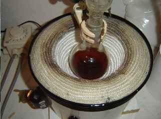

All the DCM is added to the flask (500 ml) and it is ready for the heating, so SWIM turned on the heat and started to distill off the DCM.
TJKLFcNsEm
Boiling brush de-hardener.
OpqfFmEYCy
Quite some DCM came over quickly, at least enough to use as a solvent for the epoxidation reaction.

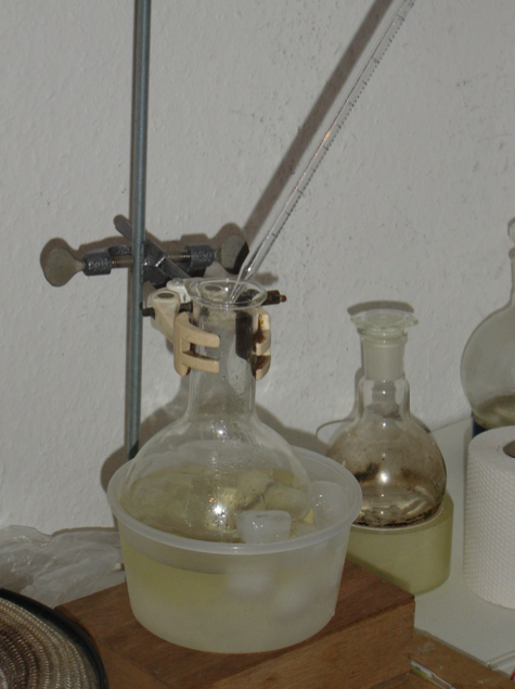

Here you can see the icebath with the isosafrole and DCM mixed in there, while the peracetic acid is being added to it slowly.
As you can see, it is in an icebath as mentioned above, this is to prevent the liquid becoming too hot, and get to a boil.
Although it should not exceed 40 *C, DCM is used as a solvent, so you also need not worry about explosives peroxides(since you need to distill this mixture) when using acetone make sure you do not add too much H2O2, since if not everything is used up by the acid it will peroxidize your solvent if it is peroxidizable (such as ether and acetone).

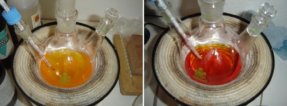

Below you can see the color change, the first picture is after everything is just added, the 2nd after an hour and the third after 2 hours and so on, on the third it is capped with Al foil, and left to stir for 16 hours.
IWfpHyS8Iw
JLfPlnK4U0
As you can see, the color changes from clear to yellow to orange to red to dark black-red.
