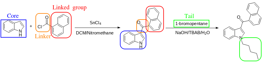

Most synthetic cannabinoids are synthesized according to the general principle: core + linked crop with linker + tail. The simplest example to understand is the synthesis of JWH-018: indole + 1-benzoyl chloride + 1-bromopentyl. Below is the synthesis scheme with groups, which are distinguished by colours.

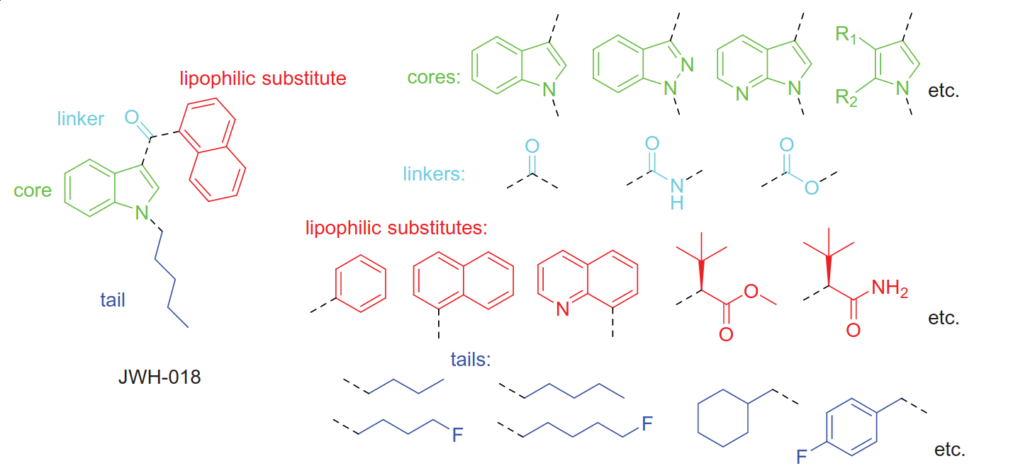

Rather simple synthesis routes allow the construction of alternative synthetic cannabinoids with a certain affinity for CB1 receptors (CB1R).
ASb6iePHgw
General structural information of synthetic cannabinoids with JWH-018 as an example, where the dotted lines are connected bonds.

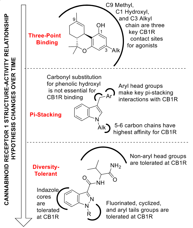

The earliest structure−activity relationship (SAR) studies of known CB1R ligands, like THC, led to the three-point attachment hypothesis. In this hypothesis, cannabinoid receptor binding was considered to be dependent on three structural moieties of THC: the C9 methyl group, the phenolic alcohol, and the pentyl chain extending from C3. This binding model was supported by an early cannabimimetic, WIN 55,212-2 , an aminoalkylindole which binds to both CB1R and CB2R with high affinity despite being structurally unique compared to THC. With the aminoalkylindole scaffold thus appearing to be a reasonable template to expand upon for early SAR studies of SCBs, research chemists began to generate libraries to further cannabinoid receptor ligands based off the findings with this initial scaffold. One of the earliest considerations into the SAR of CB1R ligand binding was the truncation of the indole core to a pyrrole. While this change results in a reduction of activity at the CB1R, it is still tolerated. In concordance with the three point attachment theory, it was believed that the C3 pentyl chain involved in the affinity of THC for the CB1R was mimicked in the aminoalkylindoles by the N-alkyl chain. Many lengths of this chain have been tested, from methyl to heptyl, on both naphthoylindoles and pyrroles, including removal of the amino group, which did not affect CB1R affinity. While methylindoles displayed no CB1R affinity, low micromolar binding was observed with an ethyl group. This trend of increasing activity continued through n-hexyl, where affinity peaks at 9.5 and 5.5 nM affinity for CB1R and CB2R, respectively. The same trend is seen in compounds with a methyl group present at C2, although such compounds display reduced affinity overall. Similarly, activity at CB1R was only first observed with n-butyl extensions from the pyrrole compounds, peaking in affinity with the incorporation of an n-pentyl group.
Moving to a separate portion of this alkylindole scaffold, compounds with methoxy, alkyl, and halogen substitutions around the naphthyl ring were tested. These analogues spurred the observation that additions to sterically hindered positions of the ring were not tolerated, whereas groups added to freely accessible positions were tolerated, and sometimes even improved activity. Multiple aromatic stacking interactions have also been observed in silico between high affinity CB1R ligands and the transmembrane domains 3−6 of CB1R, which is a region rich with tyrosine, phenylalanine, and tryptophan residues. Furthermore, several compounds used in these docking studies were JWH-series analogues which specifically lacked the carbonyl oxygen yet still retained CB1R activity, impugning a central tenet of the three-point theory, and supporting the π-stacking interpretation. However, this π-stacking CB1R agonist binding theory, which was sufficient to explain the affinity of naphthoylindole SCBs, was unable to explain the generations of SCBs that came to follow. Among these are the carboxamides in which the naphthoyl group is replaced by a nonaromatic derivative of valine. Many SAR studies were subsequently conducted to determine the effects of these broader scaffold changes on CB1R affinity, including substitution of the indole core for the closely related indazole, altering the valinamide side chain, changing a terminal carboxamide to a methyl ester, and fluorinating the terminal end of the N-alkyl chain. In support of this diversity-tolerant SAR, to date, there are hundreds of known SCB compounds identified from seized products, elucidating dozens of novel structural alterations that do not impair CB1R activity, while simultaneously being more difficult to detect. Following this expansion, easy structural generalization of SAR across all known SCBs has also become far more difficult. Nevertheless, based on the prototypical naphthoylindole SCBs, general SCB structures can be demarcated into four regions: a core, a head, a linker, and a tail.

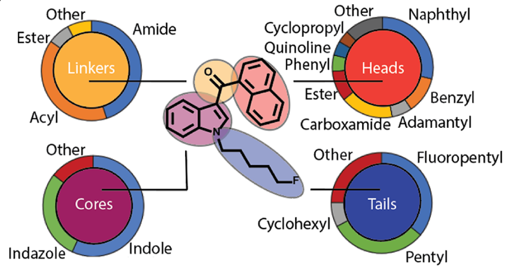

The majority of seized SCBs in illicit products still contain indole or indazole cores, while common head groups consist of large aryl, hydrophobic groups, or valine derivatives. These two regions are linked most often by acyl, amide or ester bonds. Most tail groups are alkyl chains, especially pentyl varieties and their terminally fluorinated analogues, although cyclohexylmethyl and benzyl tail groups are also noteworthy. Overall, given the number of variations observed within each region for these known SCBs, tens- to hundreds-of-thousands of different combinatorial SCB molecules are conceivable, even considering limitations such as ease of synthesis, cost of precursors, and incompatibility of different moieties among the four regions. Therefore, there remains a great deal of chemical space available for SCBs that could plausibly be exploited in clandestine production.

Due to the impressive breadth of molecules that possess agonist activity at the CB1R, several synthetic routes to generate SCBs in a simple and cost-effective manner are available. Many of the most dominant routes derive from the work of John Huffman’s group in the study of CB1R SAR for naphthoyl-indole and -pyrrole containing compounds. As C3 is the primary site of electrophilic substitution on the indole core, naphthoylindoles were easily achieved through Friedel−Crafts acylation followed by N-alkylation. In contrast, acylation of the pyrrole core occurs at both C2 and C3: addition of an N-sulphonyl directing group, as well as solvent and temperature changes, are needed to achieve C3 selectivity. Both the synthetic complexity and reduced CB1R activity of the pyrrole SCBs justified prioritization of the naphthoylindole scaffold for future compound production. Over the years, this classic route has seen several variations for the generation of 3-acylindole SCBs, such as N-alkylation prior to 3-acylation and a microwave- assisted one-pot synthesis. As many of the newer generation SCBs contain amide and ester linkages between the core and head groups, slightly different approaches are required to synthesize these compounds. One of the easiest methods for generating these SCBs with the N-alkylation of 1H-indole. The reactivity of the indole C3 position allows the addition of trifluoroacetic anhydride to the crude N-alkylated product. The resulting 1-alkyl-3-trifluoroacetylindoles are subsequently hydrolyzed to the carboxylic acid. This acid can then be converted to an acid chloride or activated with standard coupling reagents; upon reaction with an amine or alcohol, the corresponding amide or ester linked indole SCBs, respectively, are produced. In contrast, amide and ester linked indazole analogues, which lack C3 reactivity, require use of a protected indazole-3-carboxylic acid, often as the methyl ester. Following N-alkylation, the acid can be deprotected, allowing the coupling of amines and alcohols as before. This discrepancy also accounts for the relative lack of acylindazole SCBs that have been identified, as Friedel−Crafts acylation of an indazole does not generally occur at C3, thus requiring additional modifications and adding additional complexity to the synthesis.

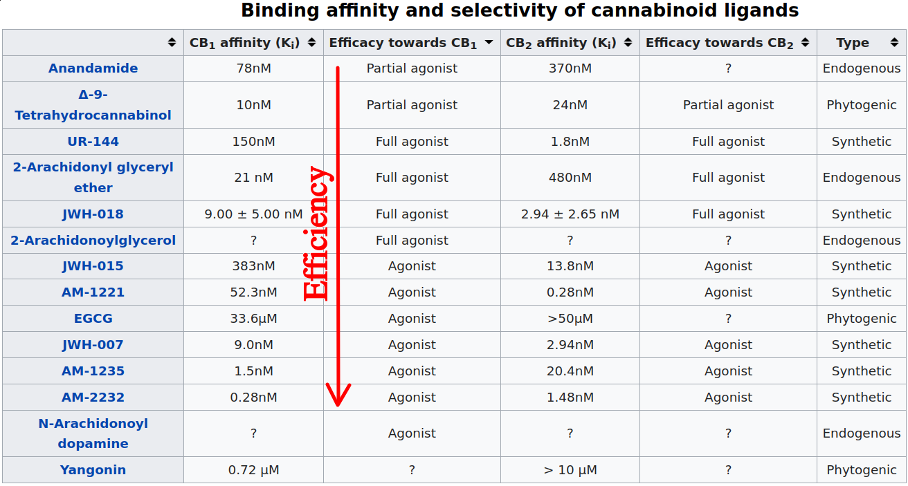

For examples of various synthetic cannabinoids which are synthesized according to the above pathways, compounds such as JWH-073, JWH-018, AM-2201, JWH-200, can be presented. Substituents on the indole ring (tails) was changed in this row, it changes their affinity for CB1R 12.9 ± 3.4 for JWH-073, 9.00 ± 5.00 nM for JWH-018, 1.0 nM for AM-2201 (with increasing potency).
NKlp5kNPuR
In the row of ADBICA, PB-22, JWH-018, JWH-250 and UR-144 the attached groups are replaced (the naphthyl group of JWH-018 by others), it also changes their CB1R affinity 0.69 nM for ADBICA, 5.1 nM for PB-22, 9.00 ± 5.00 nM for JWH-018, 11.00 nM for JWH-250, 150 nM for UR-144 (with potency reduction).
