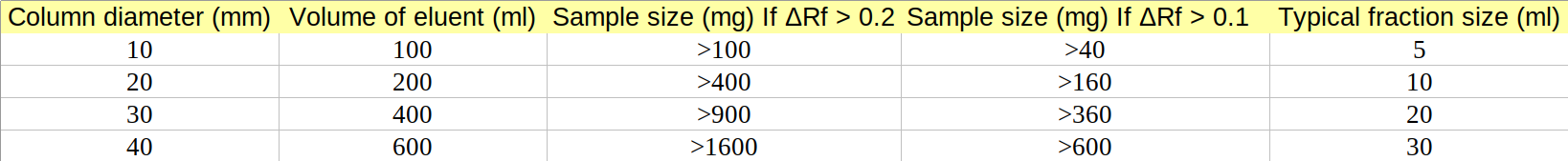

For example, a column of 2.5 cm should be able to purify around 400 mg of material if the separation is good (ΔRf > 0.2, third column in Pic. 1), or around 160 mg if the separation is difficult (ΔRf > 0.1). The column should be able to be prepared and eluted using around 200 ml of solvent, and the fractions can be collected with approximately 10 ml of solution each.

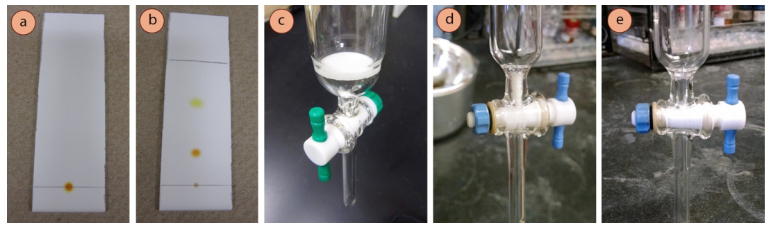

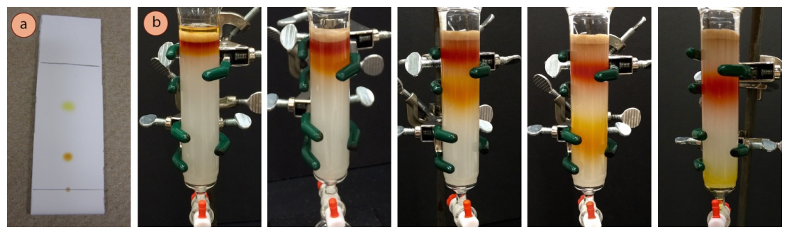

a) TLC of ferrocene/acetylferrocene mixture, b) Column chromatography
The column pictured in this section shows purification of a 0.20 g sample containing a mixture of ferrocene and acetylferrocene (crude TLC is in Fig.2 a). Roughly 8mL fractions were collected into small test tubes, and roughly 400 ml of eluent was used.
a) TLC plate of crude ferrocene/acetylferrocene mixture before elution, b) After elution, c) Column with frit, d) Column with cotton wedged in the bottom, e) Column lacking the cotton wedge (would need to be inserted before use)
Run a TLC
1) Run a TLC on the sample to be purified (Fig.3 a and b) to determine the appropriate solvent for chromatography. The desired component should have a Rf around 0.35 and should ideally be separated from all other spots by at least 0.2 Rf units.

3) Obtain an appropriate column (see Fig. 1), and be sure there is something near the stopcock that will allow liquid to pass through, but not solid. Columns may have a sintered disk (also known as a "frit"), Fig.3 c), or a plug of cotton or glass wool remaining from the previous user (Fig.3 d). If no disk or plug is present (Fig.3 e), wedge a small wad of cotton or glass wool into the bottom of the column using a long rod.

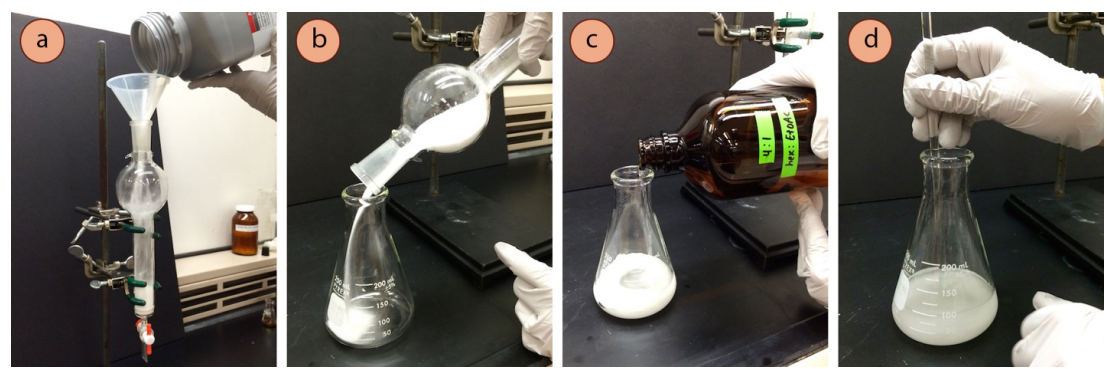

a) Pouring in silica to 12.5-15 cm high in the fume hood, b) Pouring the silica into an Erlenmeyer flask, c and d) Making a slurry
Safety note: Powdered silica and alumina are lung irritants, and should always be handled carefully in a fume hood. Spilled dust should be disposed of by mopping it with a wet paper towel (if wet, the fine particles are less dispersive).

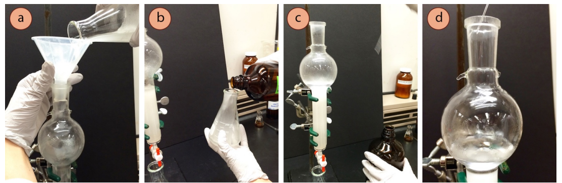

5) In the fume hood, pour the adsorbent measured in the column into an Erlenmeyer flask (Fig.4 b), then add some eluent (Fig.4 c). Make a loose slurry by swirling and stirring with a glass stirring rod (Fig.4 d) until all the adsorbent is completely wet, gas bubbles are released, and the consistency is somewhat thick, but pourable.
a) Pouring the slurry into the column, b) Rinsing the flask, c) Adsorbent adhered to the sides of the column, d) Rinsing off the clinging adsorbent
6) Put a beaker or Erlenmeyer flask beneath the clamped column and open the stopcock. In one quick motion, swirl and pour the silica or alumina slurry into the column using a large-mouthed funnel (Fig. 5 a). Immediately use more eluent to rinse residual slurry out of the Erlenmeyer flask (Fig.5 b) and onto the column.
7) Immediately rinse any silica or alumina off the sides of the column reservoir using eluent and a swirling motion from a Pasteur pipette (Fig.5 c and d). If allowed to dry, the adsorbent will cling to the glass and won't easily be rinsed down.

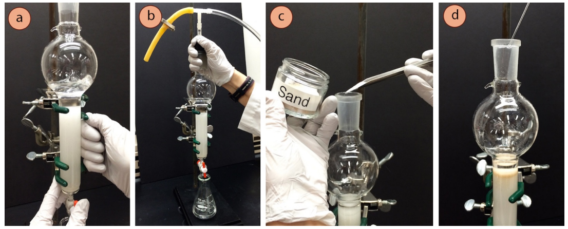

a) Jostling the column to remove air bubbles, b) Applying air pressure, c) Adding sand, d) Rinsing sand from the sides
8) Jostle the column firmly using a cork ring or your knuckles (Fig.6 a) to dislodge any air bubbles in the column (which could cause poor separation or cracking of the adsorbent in the column), and to promote an even deposition of adsorbent.
9) Apply gentle air pressure to the top of the column (Fig.6 b) to compress it, stopping when the eluent level is 1 cm from the top of the column. If a T-adapter is used with the air line as in Fig.6 b, fine control of the airflow can be accomplished by adjustment of the pinch clamp on the rubber tubing. Throughout the entire elution process, keep the white column of adsorbent wet, with the eluent level above the top of the silica or alumina. Gently break the seal to cease application of pressure, and close the stopcock to prevent liquid from dripping out further.
10) Add a thin layer of sand (Fig.6 c), approximately 0.5 cm high. Rinse the sides of the column with eluent using a swirling motion to dislodge the sand off the sides of the glass (Fig.6 d). Open the stopcock and allow liquid to drip out until the liquid is just above the sand layer. Apply air pressure if the dripping is too slow.

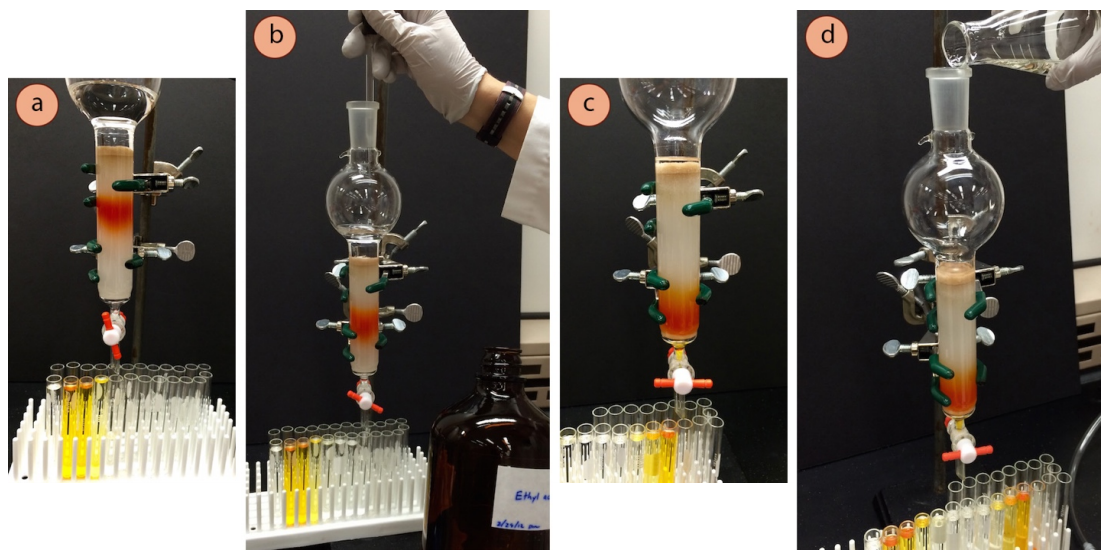

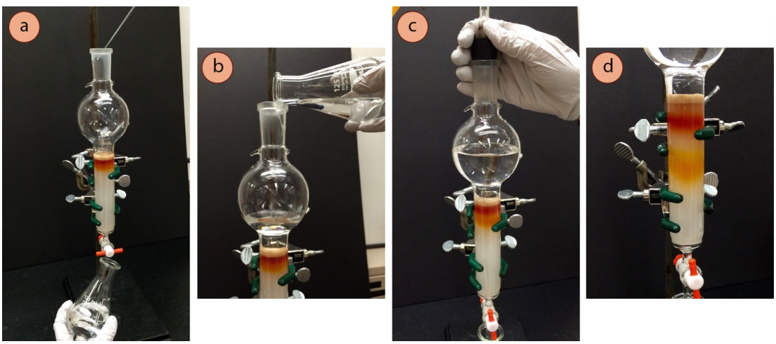

17) Delicately add more eluent via pipette (Fig.8 a), swirling down the sides, and then when the sand layer would no longer be disturbed with the additions, carefully pour in larger quantities (Fig.8 b) of the prepared eluent to fill the reservoir (or fill with as much as may be needed). Clean eluent collected during the packing of the column can be reused.
18) Use air pressure to gently and steadily elute the sample through the column (Fig.8 c and d). The more times the pressure is started and stopped, the more likely the column may crack. It's best if the pressure can be kept gentle and steady the entire time.
The optimal drip rate during elution depends on the size of the column. The ideal flow of eluent is when the solvent in the cylindrical section of the column above the adsorbent drops at 5 cm per minute. Therefore, the drip rate should be slower with a narrow column compared to a wider column. The drip rate for a one-inch column should be where individual drops can be barely distinguished. A stream of liquid pouring out the stopcock with this size of column is slightly too fast.

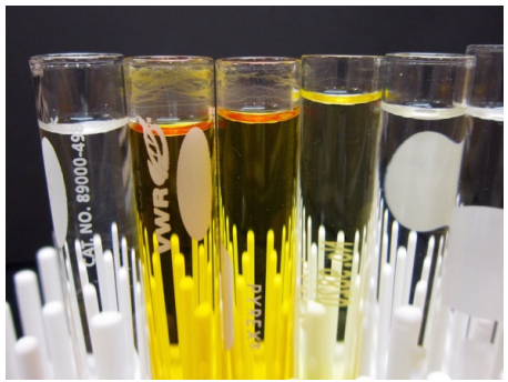

a-c) Collecting fractions, d) Running a column
Collect fractions

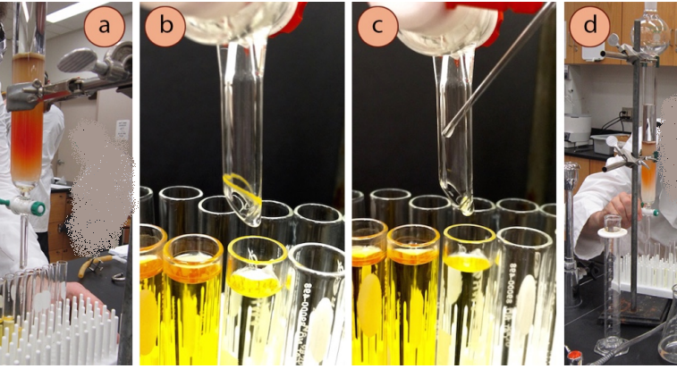

19) Immediately start collecting the eluting liquid into test tubes on a rack (Fig.9 a). See Fig.1 for recommendations on volumes to collect in each test tube.20) When the first test tube fills, or if a certain height of liquid has been collected as recommended by your instructor or Fig.1, move the rack over to start collecting into a different tube (Fig.9 b and c). Fill and keep the tubes in order on the rack.
These different tubes are called "fractions". The goal of a column is to collect small enough fractions that most (or some) fractions contain pure material. If the separation of the mixture is difficult (if the ΔRf of the components is low), it may be best to collect small fractions (e.g. half-filled tubes).
a-c) Rinsing material splashed onto the tip of the column, d) Students running a column
21) As liquid drains off the column, it often splashes onto the outsides of the tip of the column, and when the solvent evaporates you may see a ring of material on the tip (you will see a ring of solid if the component is a solid as in Fig.10 b, or oily droplets if the component is a liquid). If the components are colored, the column tip should be rinsed (Fig.10 c) when it appears as if one component has completely eluted and before the other component approaches.

a) Elution, b) Addition of ethyl acetate to increase the solvent polarity, c) Solvent level nears the sand layer, d) Refilling
Possibly Increase the Solvent Polarity

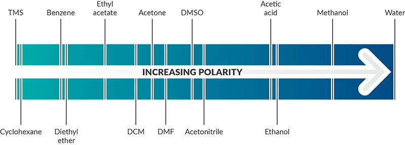

23) One eluent may be used throughout the entire column, especially if the components to be separated have similar Rf values. However, if the components have very different Rf values, the solvent polarity may be increased after one component has eluted from the column (Fig.11 a).
Increasing the solvent polarity will make components travel "faster." There are several reasons a faster elution is desired. First, if one component has already exited the column, the column has already done its job with separation, so speeding up the process will not affect the purity of the collected fractions. Second, the longer it takes to run a column, the wider will be the component bands (due to diffusion), and collecting a broad band of material will use (and waste) a lot of solvent.
Contains a partial list of the eluotropic series, a list of common solvents ranked according to their "solvent power" in normal phase chromatography. The more polar solvent causes the most dramatic increase in Rf

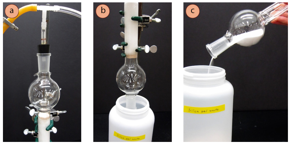

a) Using air pressure to dry the column, b) Allowing the column to dry upside-down, c) Collecting the waste silica
Clean Up the Column
32) To dry the column, apply air pressure to drain the majority of eluent from the column into a waste container. Then further dry the column using one of these methods:
a) Leave connected a gentle stream of air running through the column to further dry it as you clean up other things (Fig.16 a).
b) Clamp the column upside down over a large waste beaker in the fume hood, so that the adsorbent will fall when it has dried (Fig.16 b). This will take a long time (until the next class period), but is an option.
33) When dry, the adsorbent can be poured out of the column into a waste container in the fume hood (Fig.16 c).
Safety note: Powdered adsorbents are a lung irritant, and their hazard is exacerbated if the column contains residual compounds that can now make their way into your lungs. Pouring silica or alumina powders should always be done in the fume hood.
34) When the majority of the adsorbent has been collected in a waste container, use water to rinse any residual solid into the sink, and then rinse the column with acetone into a waste beaker. Further, clean the column with soap and water and dry with the stopcock parts separated.

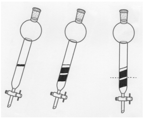

The Bands are eluting unevenly
If the components of a mixture are colored, it may be obvious when the bands elute in a crooked manner. This is most likely due to the column being clamped at a slight diagonal. If the column is clamped in a slanted manner, components will travel in a slanted manner (Fig. 18). This may cause separation problems if the components have a similar Rf.
There is no way to resolve this problem midway through a column, but if the components have very different Rf values, the slanted bands may have no effect on the separation. In the future, be sure to check that the column is perfectly vertical in both the side-to-side and front-back directions.
