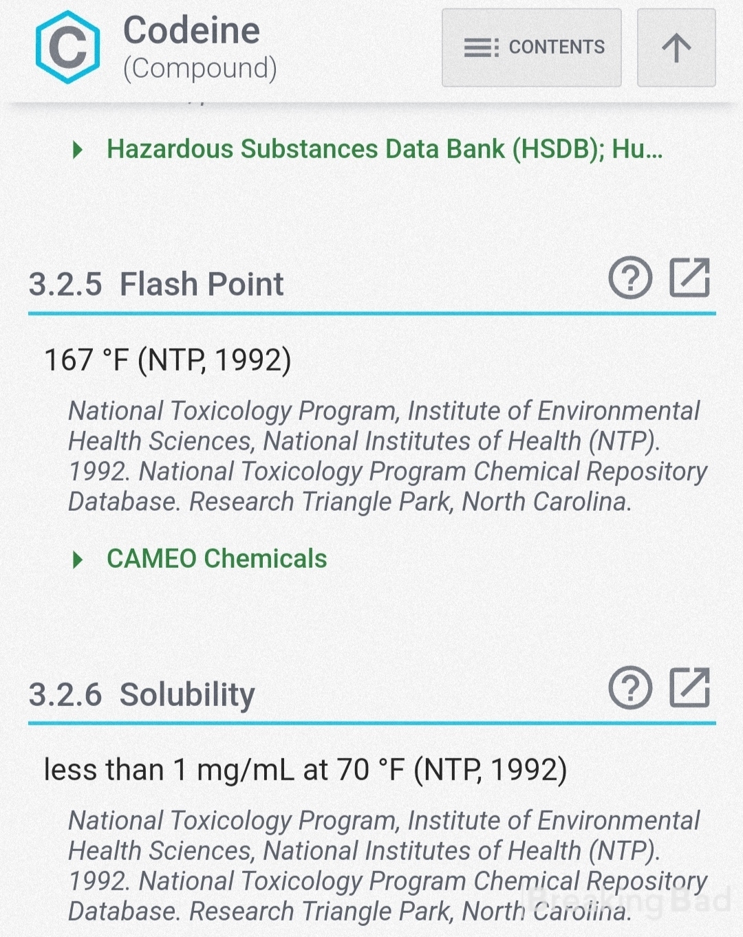

Codeine phosphate
Water-soluble;
Boiling Point: 462 ºC at 760 mm Hg;
Melting Point: 238-240 ºC;
Molecular Weight: 397.4 g/mole;
CAS Number: 52-28-8 (phosphate salt).

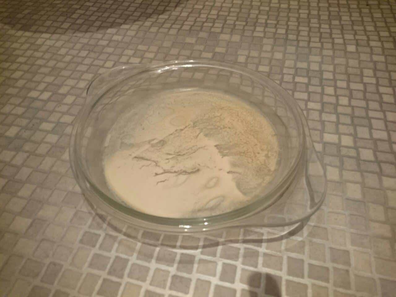

Dried codeine product from a cold water extraction on a pyrex tray.

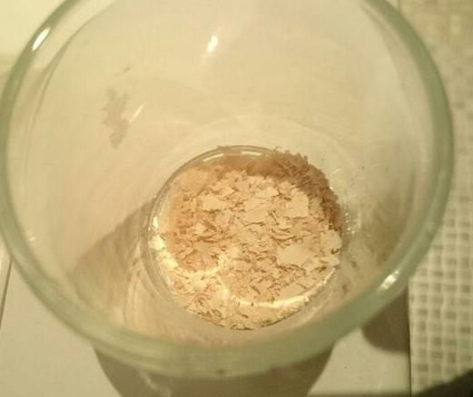

6. Then the volume is again reduced to 50 mL. The solution is cooled in the fridge and then filtered. More caffeine is filtered off at this step. After this treatment, less than 15% of the original amount of caffeine will remain in the solution.
What remains is a solution of codeine without a discernible amount of caffeine that leaves a truly euphoric stoning codeine. The solution can be evaporated down to a powder that looks something like brown sugar and is intensely bitter (unlike caffeine, that is only mildly bitter). This is a relatively concentrated form of codeine phosphate that you're after. Note how this technique also does not use any acids, bases or organic solvents to accomplish the removal of caffeine from the caffeine/codeine, and thus I feel is a significant breakthrough.

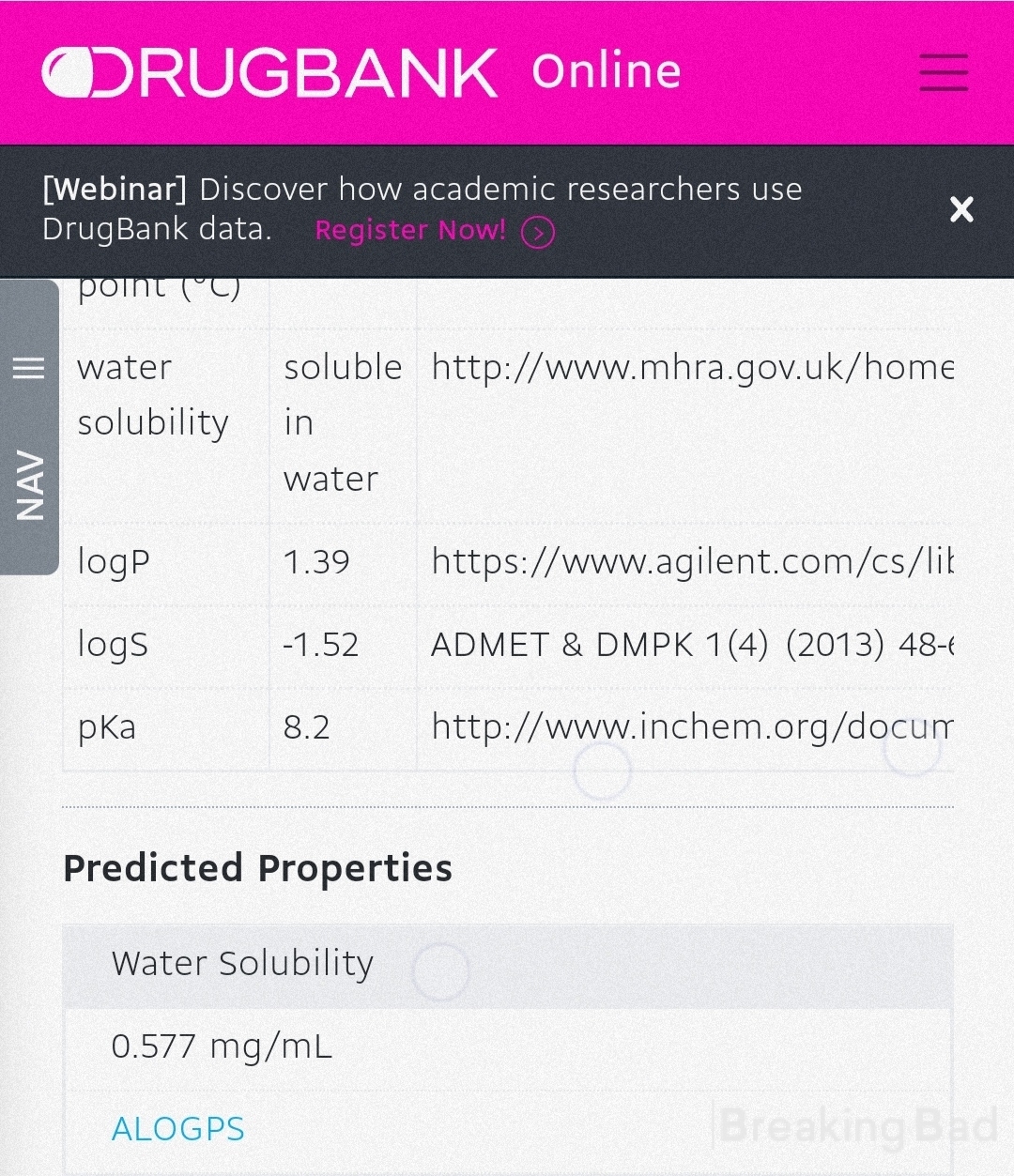

Solubility of ibuprofen and paracetamol
These figures should be taken as approximates only. Don't forget, this only includes how much para/ibu is dissolved, and does not include suspended solid particles of paracetamol and ibuprofen. The purpose of filtering is to remove as many of these solid particles as possible. If filtering is not done properly, toxic levels of paracetamol or ibuprofen can remain in your final product.
Solubility of Ibuprofen
The solubility of ibuprofen in water at 25 degrees Celcius or lower is less is than 1 mg per mL.
At 31 ºC, 100 mg dissolves in 100 ml (1 mg/mL).
At 21 ºC, 7.8 mg dissolves in 100ml (0.078 mg/mL)
