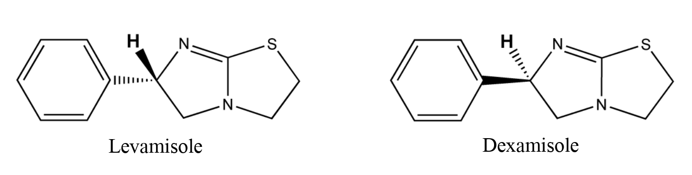

Phenyltetrahydroimidazothiazole (i.e., levamisole, dexamisole, ortetramisole) has been increasingly utilized as a cutting agent by South American illicit cocaine laboratories for the past eight years, and is now the most predominant adulterant in cocaine produced in Colombia. The salt form of illicit cocaine must be determined when possible for sentencing purposes; this is typically done via infrared spectroscopy. Two separation techniques for cocaine/phenyltetrahydroimidazothiazole mixtures are presented to common users or sellers. Mixtures of cocaine (hydrochloride and base) and phenyltetrahydroimidazothiazole (85:15, 70:30, and 50:50) were prepared and separated with liquid/liquid extraction and ion-pair chromatography. Recovered cocaine was subsequently analyzed via infrared spectroscopy, gas chromatography-flame ionization detection, and isotope ratio mass spectrometry. A qualitative reaction for the determination of sulfur in organic compounds will be described also.
