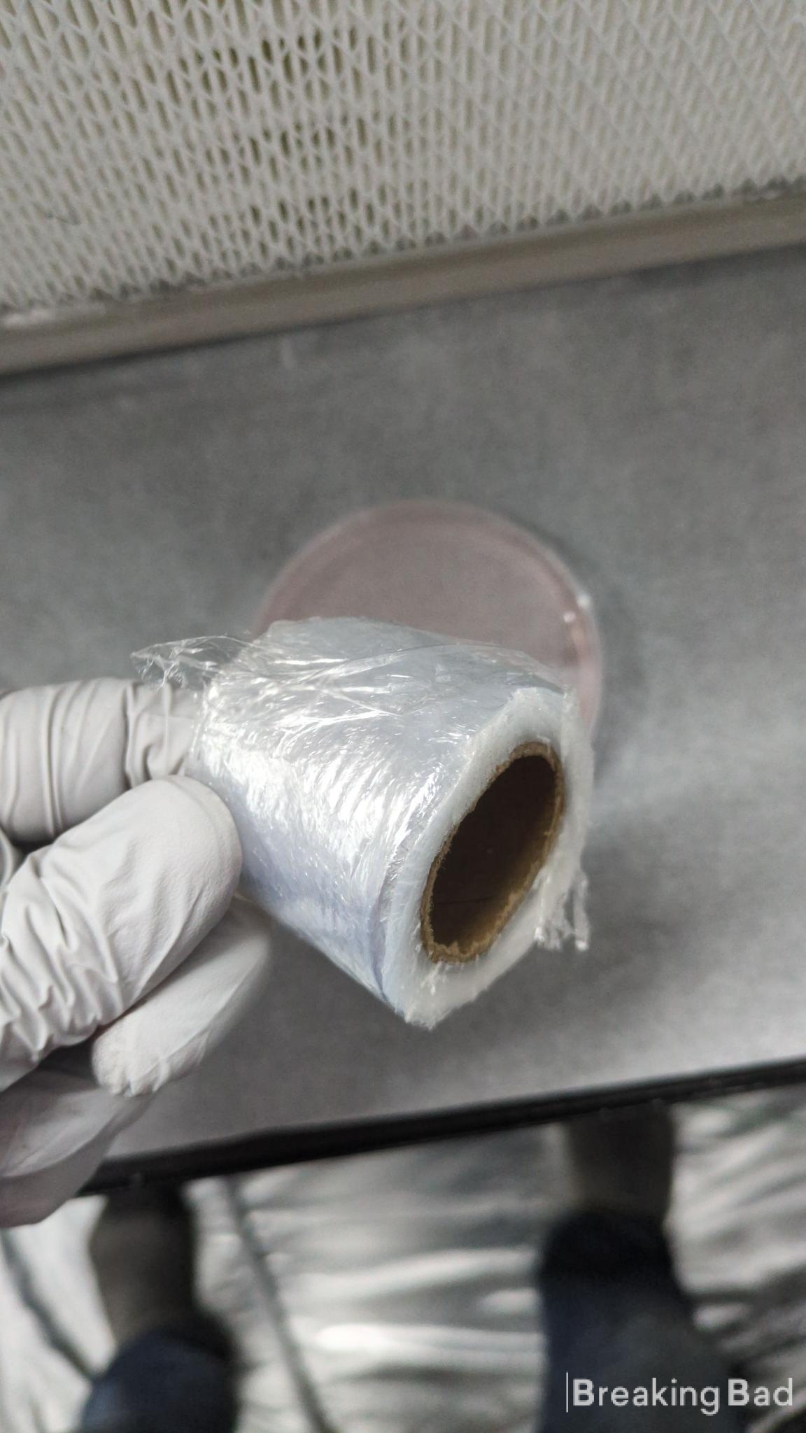

And, now that I am thinking about it, this is a small section, a mini roll, of saran wrap, cut from a whole roll, way cheaper and easier to use for sealing petri dishes

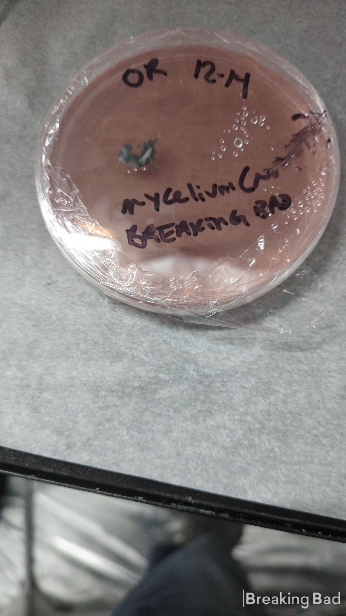

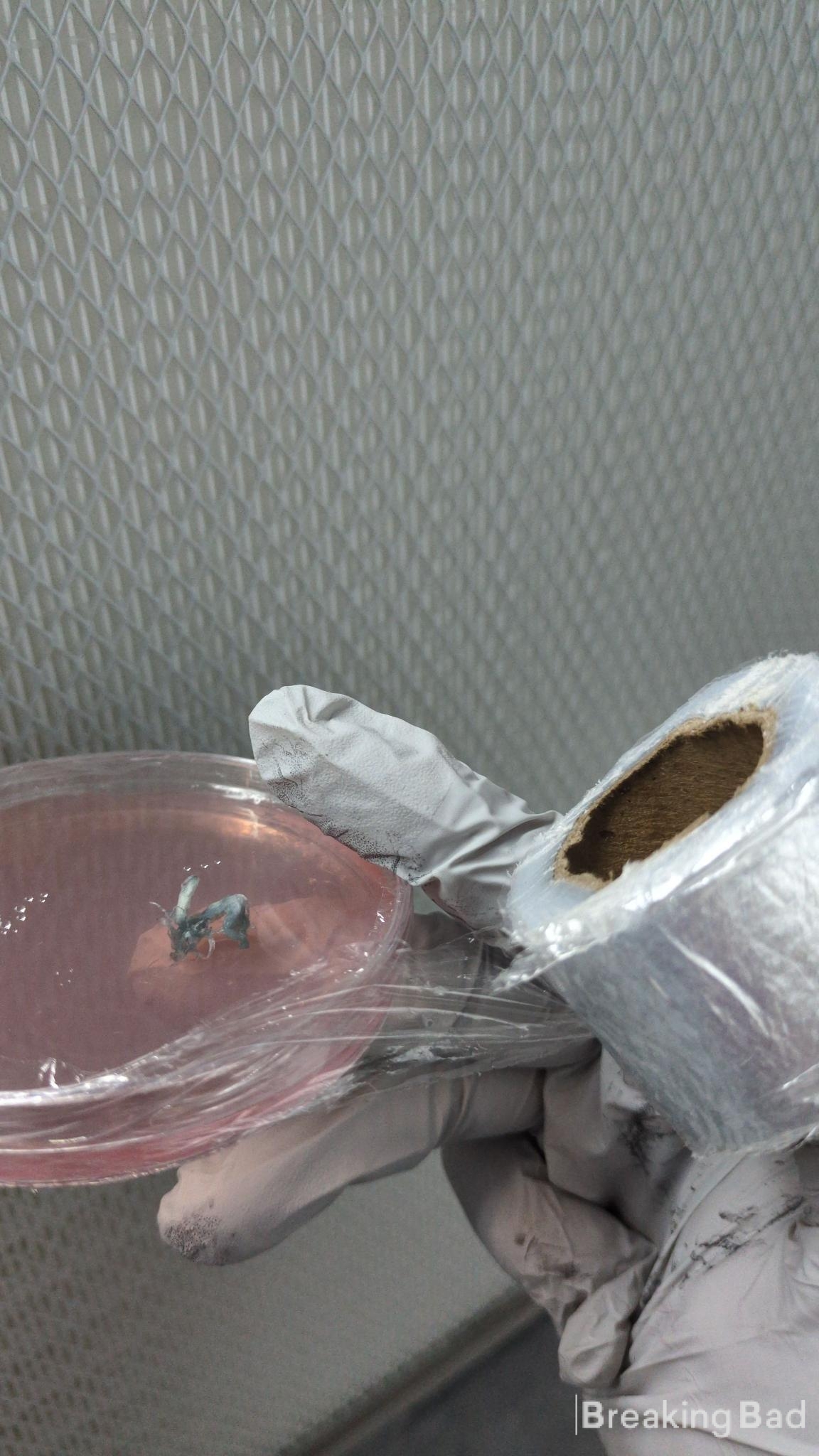

Deposited specimen on the agar and closed the lid
ZE2e6ijTvW
Wrap with the saran
ITZKtX4BJM
And label it.

5lMx3FIH4L
And, after a few days (4-8) you see the mycelium going away from the tissue culture..take a fresh piece in the same sterile conditions, until the culture is clean and go agar to grain or agar to liquid culture

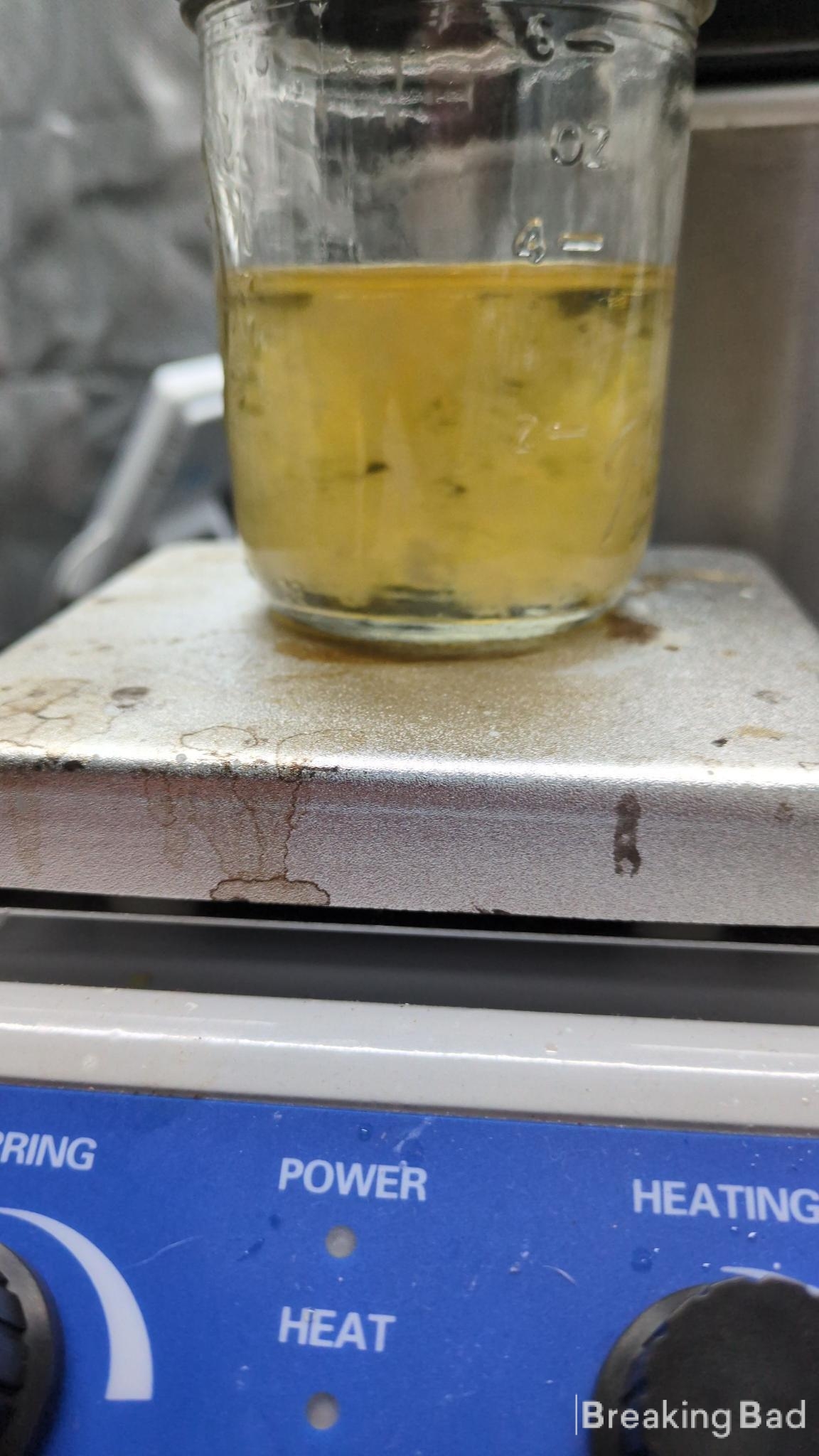

This liquid culture used the JoseX poke LC method , using 10g of light male extract per liter of water, and sterilized for 25 min at 17 psi, with a 1.5" stirbar in the jar prior to sterilization, stirred for 10 seconds twice a day, mostly. About 3-4 weeks old, ready for grain.
P. natalensis
