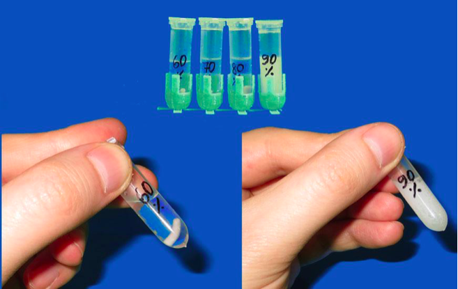

Testing acetone at home.
Let's start with a simple one. At what concentration, acetone stops dissolving ABS plastic. Let's prepare 4 solutions of acetone 60%, 70%, 80%, 90%, add ABS plastic and leave it for 24 hours. After shaking:

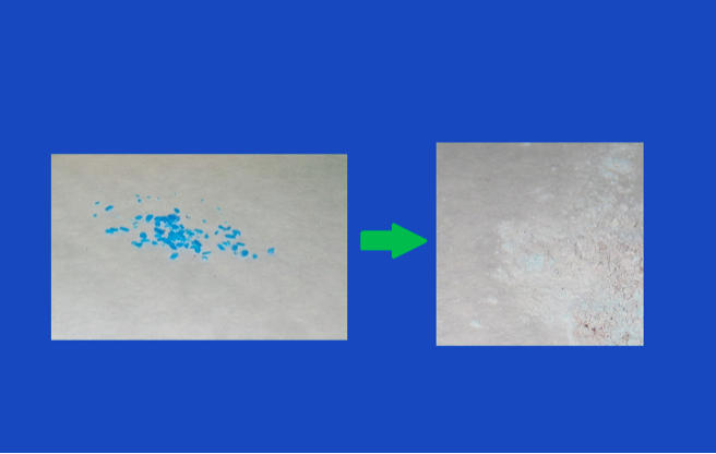

You can see that the plastic dissolved only in 90% acetone. In other words, if acetone has more than 10% water, it will not work. Let's move on to another experiment: to test acetone, you will need copper sulfate, which you can freely buy in a fertilizer store. The blue crystals should be crushed into a powder and carefully heated (copper sulfate is poisonous, it should be done in a non-food pan under a hood and/or in the open air).
Pour the resulting powder with a small amount of acetone. Stir it around. If there is water in the acetone, the white powder will turn blue after a minute.
The comparison photo shows pure acetone and acetone with 20% water. If after one minute the color has not changed to blue, and the ABS plastic does not dissolve in this acetone, then we can safely say that this acetone is of very low quality, and it must be cleaned.
