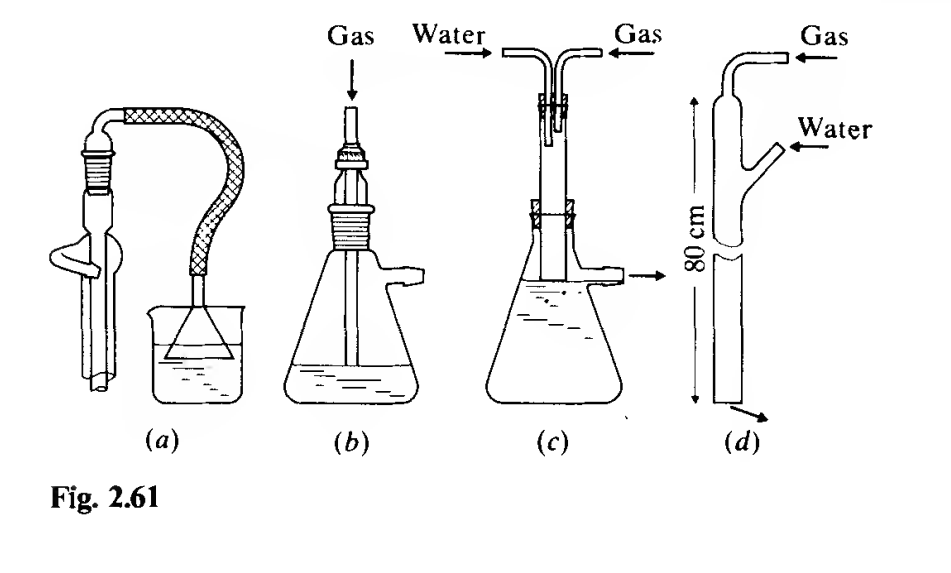

  • In a 1 -litre two-necked round-bottomed flask, equipped with a dropping funnel and a double surface reflux condenser to which is attached a gas absorption trap
