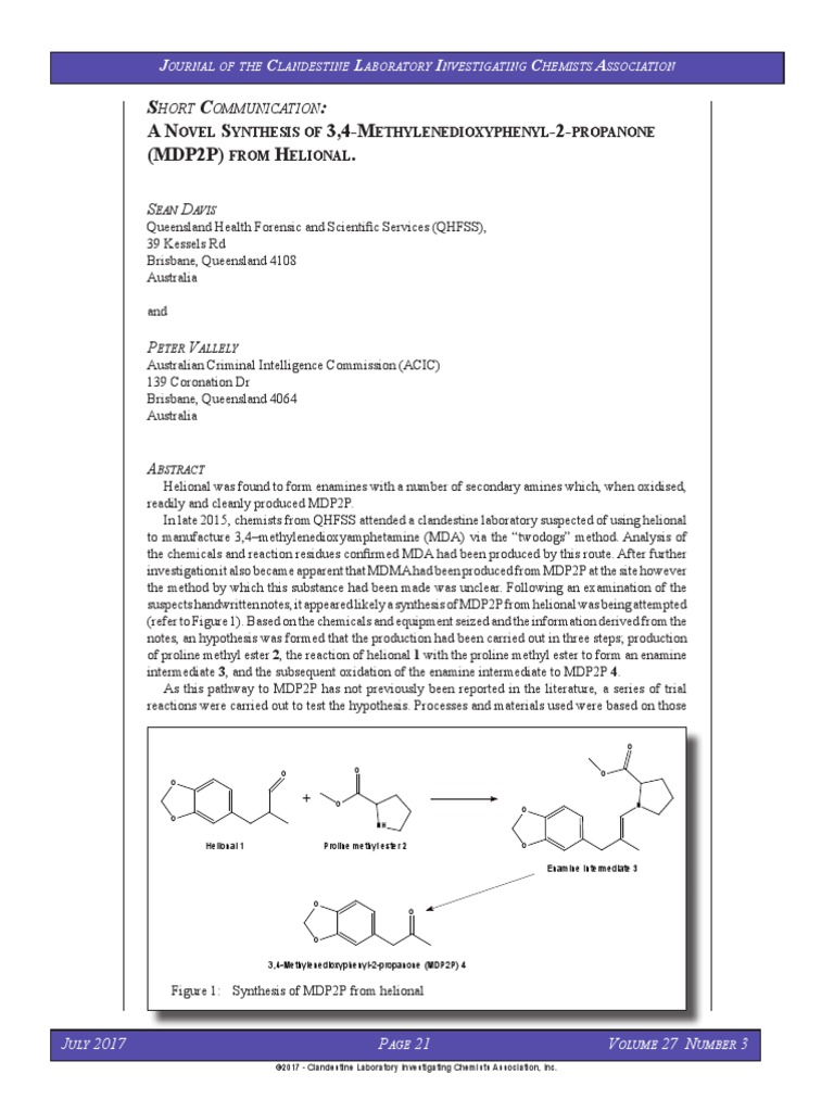

Helional To MDP2P?
Blammo
Sep 25, 2024
251
46
Is there a way to convert helional to MDP2P?
Strike3
Dec 22, 2024
Optimising MDP2P Synthesis from Helional Using an Enamine Intermediate
Strike3
Dec 22, 2024
The copper route to Enamine oxidative cleavage is tough and very messy. Works much better in chilled chloroform and sieves (to absorb water made in the reaction) with a strong light source and photosensitizer to generate singlet oxygen. Run overnight and there should be plenty of ketone.
You should pump in pure O2 (regular check valve should work), or use it to pressurize a balloon and place over the flask. But molecular oxygen is not reactive singlet oxygen, which is not stable and so must be generated. It can be done with some chemical reactions or oxidizers, but the photochemical route is very clean and easy and means there is less to clean up during purification.
https://www.reddit.com/r/TheeHive/comments/175uf99
Strike3
Dec 22, 2024
Strike3
Dec 22, 2024
Enamine formation is needed followed by oxidation. Also, get good at TLC you will need to test the oxidation for complete helional conversion since helional and your ketone boil less than 10C difference. The vispary has a great write up from milk n honey on photo oxidation. That should be easy enough to put into the Google machine. Sawdust and Honey
helional to mdp2p it's been done officially « on: September 09, 2019, 11:34:43 AM
https://www.reddit.com/r/ChemicalRevolution/comments/1bb0j09
mycelium
Nov 17, 2024
429
160
Thank you for a good read, strike3
Irving Langmuir
Jan 23, 2024
49
19
Strike3
Dec 22, 2024
It's been posted everywhere vesp etc all of that is posted in the same thread
Carl/samecarlheretoo posted it years ago. It's "around" see the link below.
Strike3
Dec 22, 2024
Irving Langmuir
Jan 23, 2024
49
19
It's not the same thing at all. What I'm talking about is a publication from 2019. What you're showing me is a short communication on this method from 2017 that I've already seen over and over again. This publication takes that work and optimizes it.
2,124
1,602
I stumbled upon this and remembered this post, it may have already been linked, my applogies if so a thing I saw
Irving Langmuir
Jan 23, 2024
49
19
Thanks, but I already have this paper, and it's not the one I was talking about.
