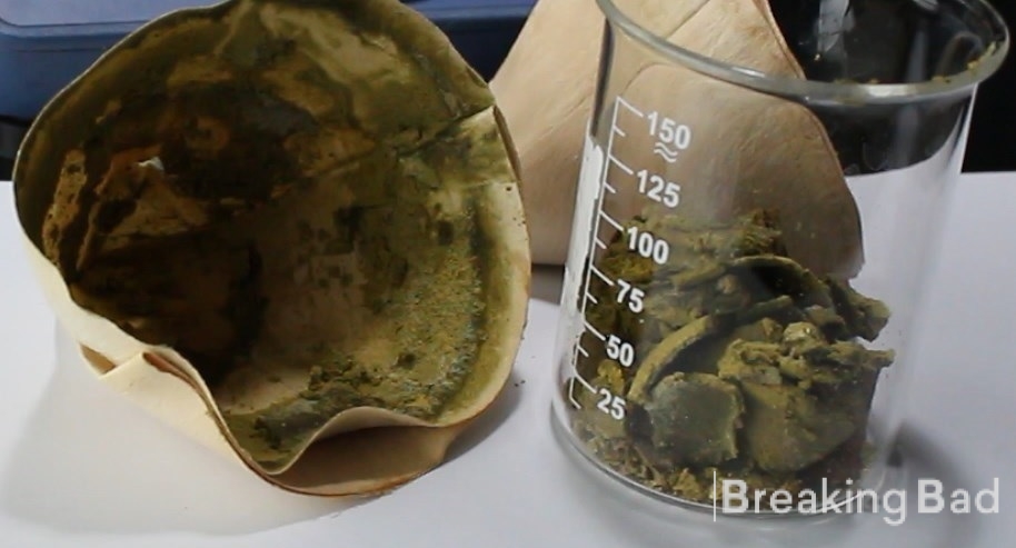

Starting Reagents and Materials
  • 10 g piperine on filters
  • 250-300 ml EtOH 88%
  • 50 ml EtOH 40%
  • Beakers
  • Filter paper
  • Funnel
  • Heater
Piperine Recrystallization
Piperine is scraped into a glass Fig 2
KUpONBGtCD
Fig 2

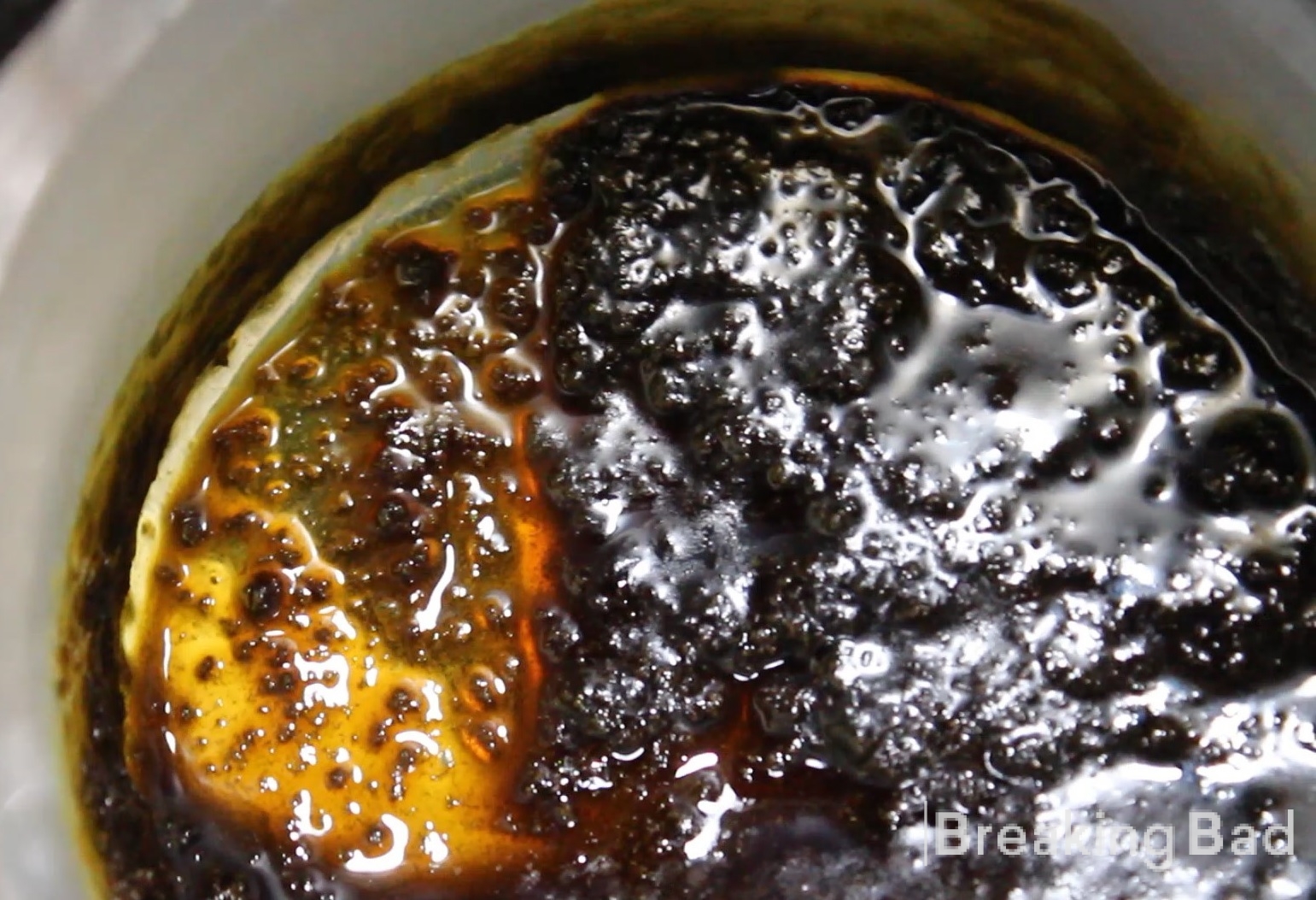

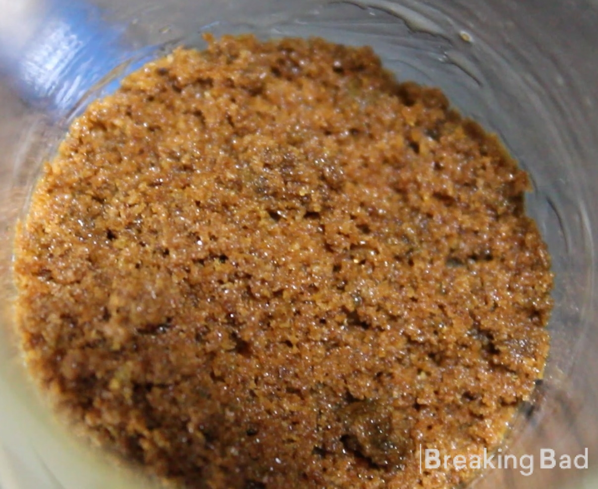

Ethanol is added to piperine at heating to 40-50℃ Fig 3
QyjH0lwrOk
Fig 3

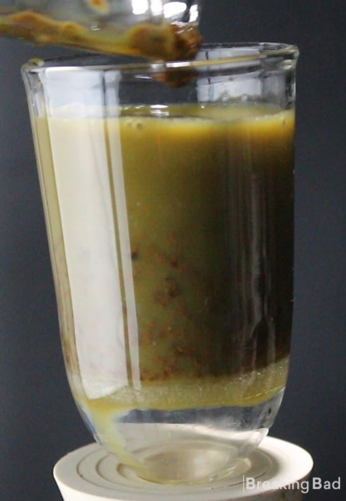

Ethanol should turn yellow to brown in color Fig 4
Nnzoa4dvCW
Fig 4

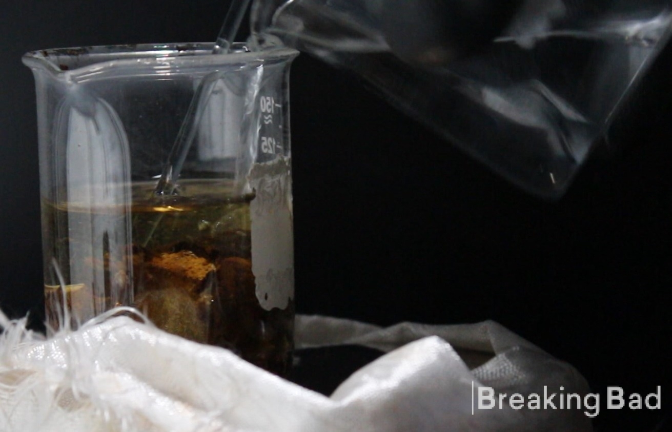

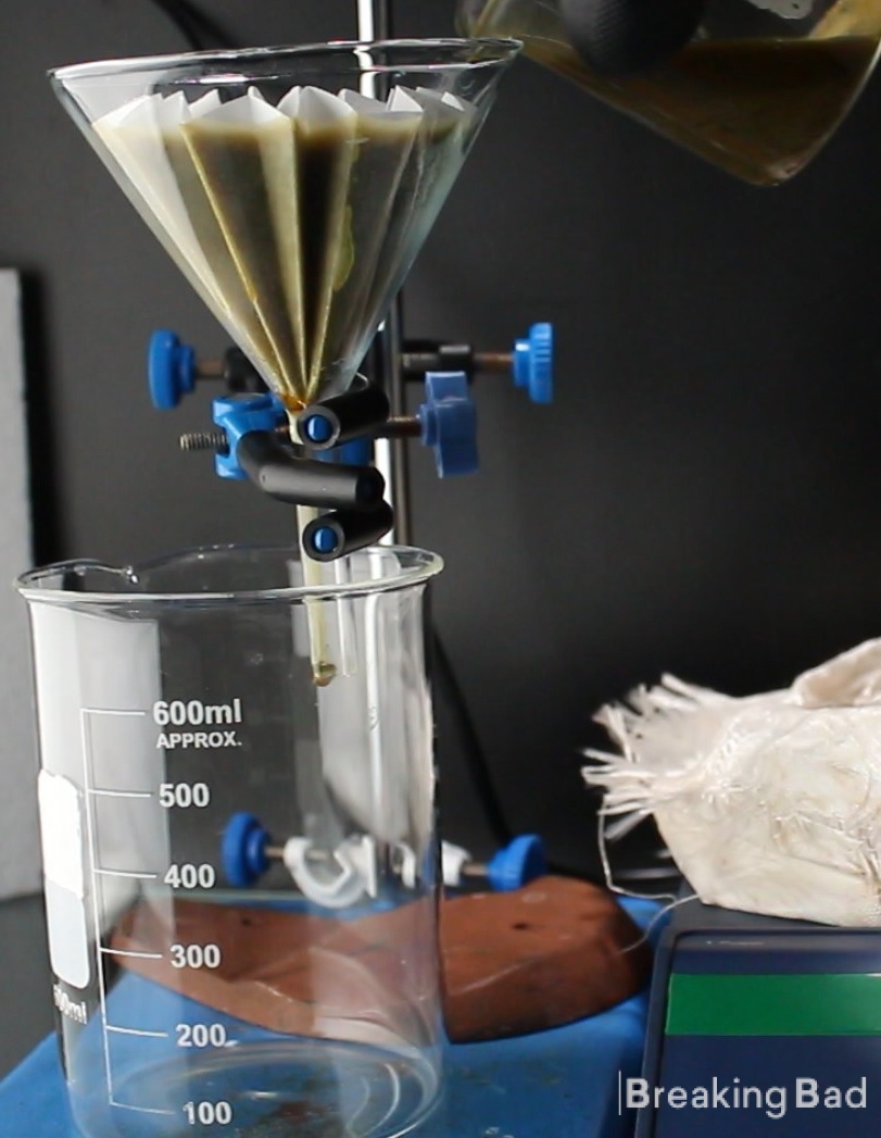

Ethanol is stopped being added when the solution no colored. The warm solution of piperine in ethanol is filtered through a paper filter Fig 5
P3pGhea9lv
Fig 5

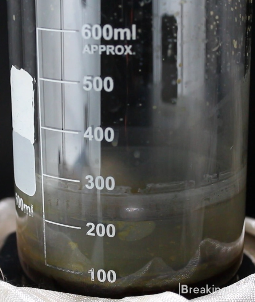

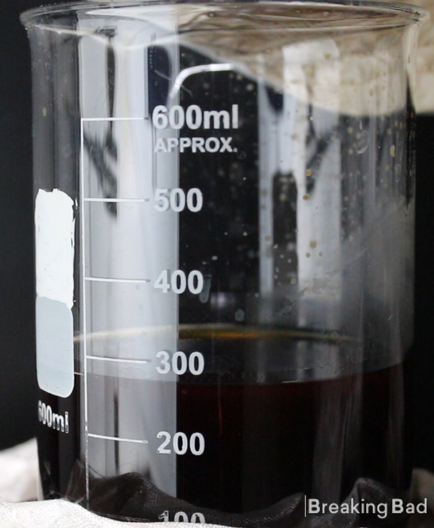

After filtration, the total volume of the piperine solution in ethanol is 250-300 ml Fig 6
PHyVCP9gIT
Fig 6

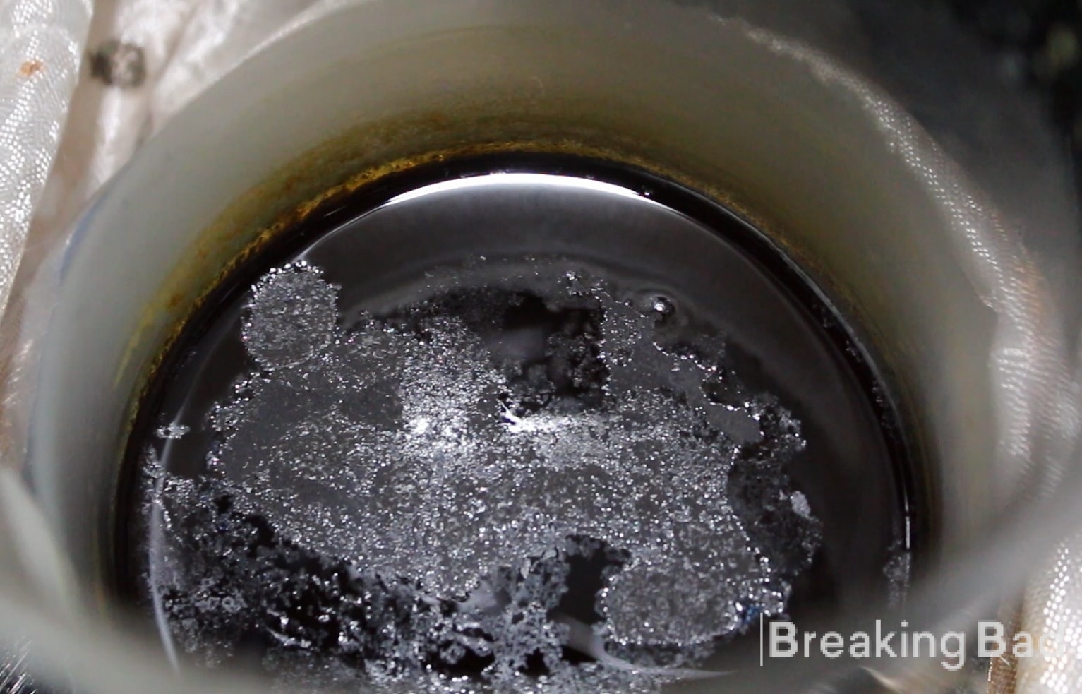

When the first crystals appear, stop evaporating. Fig 8
IRpWqXa6Jz
Fig 8
