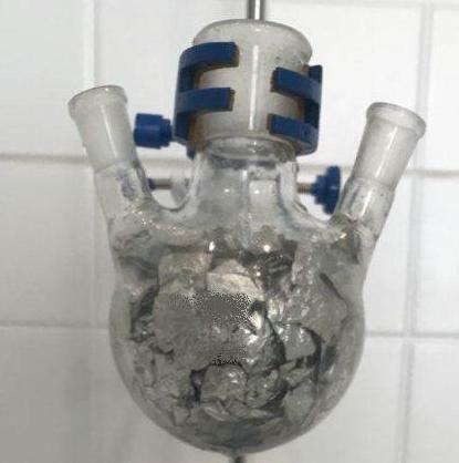

Set up a two-liter flat-bottom three-neck flask, and plugged one of the necks. Arrange a reflux condenser in the center hole. The apparatus was placed on stirrer/hotplate. Cut Reynolds Heavy Duty aluminum foil into about 1" squares, to make a total of 27.5g.

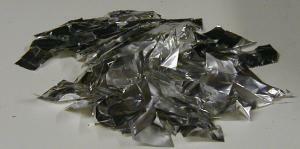

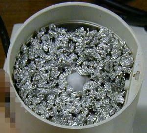

5g of foil in 1" squares and 5g of foil and foil after 8-10 seconds of grinding in a Braun coffee grinder

Closeup of foil balls and 27.5g foil in a 2000 mL flat-bottom flask
Put 5g batches into a small Braun coffee grinder and ground the foil for 8-10 seconds. The foil doesn't really get "ground", but it gets all balled up into little globs. This works amazingly well. It may sound weird to put your foil in a coffee grinder, but this is without question a breakthrough in the preparation of aluminum for the Al/Hg. Next, 400 mg of HgCl2 was dissolved in 750 mL of lab grade MeOH. When the MeOH was ready (all HgCl2 dissolved), it was also dumped in the flask and the condenser was put in place. It was stirred for 5-10 seconds every minute or so. In less than 10 minutes, faint bubbling was visible, the solution was gray, and the aluminum was distinctly less shiny. Some pieces had started to float. When the amalgam is ready, gas evolution stops.

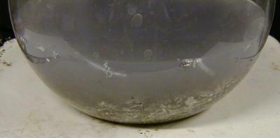

Amalgamation complete

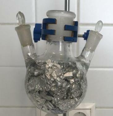

We take 14 g of aluminum foil and tear it with our hands into pieces of 2x2, 3x3 cm in size. Be sure to tear, not cut, to increase the surface area. Place into a 3-necked round-bottomed flask and fill the foil completely with water.

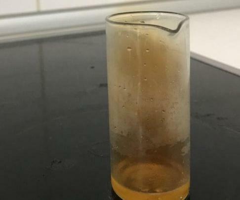

Now we are preparing the mercury salt. We take a mercury thermometer from the pharmacy, wrap it in paper, break it at the bottom tip. Pour all the mercury (~1-2 g) into a glass, where then add 4 mL of nitric acid (70%). Do not forget that mercury vapors are hazardous to health! To initiate the reaction, the glass had to be heated to about 50 degrees, stirring occasionally. All the mercury dissolved about for 30 minutes, and an orange gas, nitrogen oxide (IV), was released from the glass. The reaction equation is as follows:
Pipette 2 mL of the solution and place it in a round-bottom flask with foil. After about 5 minutes, the foil lost its shine, became dull, and a small layer of gray sludge (aluminum hydroxide) collected at the bottom of the flask. After 10-15 minutes, the reaction stops, this can be seen by the cessation of gas evolution.
XClBG4hTiW
We drain the liquid and rinse the foil with water 3 times.

Segundo a Wikipédia, para a produção de nitrato de mercúrio (II), é necessário ácido nítrico quente e concentrado, ou isso não faz diferença?
A reação com ácido nítrico quente parece, pelo menos, mais violenta, produz-se muito gás e não demorou 10 minutos.
No caso do nitrato de mercúrio(II) e do alumínio, existe uma proporção a seguir? Ou como se pode determinar a quantidade correcta para se obter uma amálgama adequada?
Será um erro ter uma solução de ácido nítrico com cerca de 50mg de nitrato de mercúrio(II) dissolvido em 0,1ml de solução? Porque li que se deve usar uma solução ácida para evitar a precipitação de produtos de hidrólise.
Ou que outras possibilidades existem?

Ok, então não faz diferença se adicionamos ácido nítrico quente ao mercúrio ou frio e depois aquecemos. Provavelmente, o segundo método é mais suave.
Esta é uma gama relativamente grande, com 50g de Al isto seria uma quantidade de 0,4g a 0,9g. Mas agora sei porque é que aumentar a alimentação não deu muito mais rendimento, muito pouco sal para formar a amálgama. Muito obrigado!
É melhor dar mais nitrato de mercúrio (II) ou apenas a quantidade necessária? Sempre pensei que a amálgama é uma reação em cadeia, que só precisa de um empurrão para reagir completamente.
O que é que significa muito ácido? Solução ácida significa que tenho um pouco mais de ácido do que reagiu na solução.
Dissolvi 21g de mercúrio em 70ml de HNO3 a 60%, o que deveria dar uma concentração de 0,1ml de solução ácida para cerca de 50mg de nitrato de mercúrio(II) e eu teria colocado cerca de 50ml de HNO3 a mais.
Isto seria cerca de 1ml (0,5g de sal) de solução ácida para 50g de Al. Será que isto já é demasiado ácido?

Estou a ver que não tenho de me preocupar com os produtos de hidrólise, mas sim com o facto de o excesso de ácido nítrico estar a interferir com a minha amálgama.
Procedi muito teoricamente de acordo com o princípio de que quero 50mg por 0,1ml de solução e peguei nesta fórmula e calculei o resto:
3HG + 8HNO3 --> 3HG(NO3)²+...+....
601,77g+504,08g -->1027,86g +...+...
2.93g+2.45g -->5g +...+...
5g de nitrato de mercúrio(II) + 10ml de HNO3 = concentração 0,05g/0,1ml
70ml de HNO3 requerem, portanto, 21g de mercúrio.
Dos 70ml de HNO3, 17,15g=12,55ml devem então ter reagido e o restante (57ml) será a solução ácida.
Qual seria a melhor forma de guardar a solução preparada?
-Posso destilar o ácido nítrico? O que restaria, o sal de mercúrio puro? No entanto, com a pequena quantidade, isso seria certamente demasiado dispendioso.
-Ou devo adicionar mercúrio e aquecer tudo para obter uma maior concentração de sal de mercúrio e menos ácido?

Mas, senhor, a reação
HG + 2HNO3 --> HG(NO3)² +NO2 + H2O
do seu post não pode estar correcta,
HG + 2HNO3 --> HG(NO3)²+ H2 seria a correcta se assim fosse, mas provavelmente deveria ser ->
HG + 4HNO3 --> HG(NO3)² + 2NO2 + 2H2O, caso contrário o número de moléculas em ambos os lados não está correto, faltaria um azoto e três oxigénios. Concordas comigo? Em todo o caso, forma-se dióxido de azoto (NO2), concordo consigo a 100%, senti o seu cheiro.
A minha reação com o óxido nítrico (NO)
3HG + 8HNO3 -->3HG(NO3)² + 2NO + 4H2O
também estaria correcta, a partir dos números de moléculas, mas o óxido nítrico é inodoro, por isso não pode estar certo, culpa minha.
Não faço ideia porque é que consigo encontrar tantas reacções para HG + HNO3 e qual delas é a correcta.
Pensei que a minha solução não estava correcta, demasiado ácida, pelo menos foi assim que o entendi, e pensei em duas formas de "salvar" a minha solução, destilar ou concentrar. Mas...
Afinal não parece necessário, como acabaste de escrever.
Se concordar comigo, utilizarei a nova reação para cálculos futuros, a fim de determinar a quantidade correcta de sal de mercúrio.
