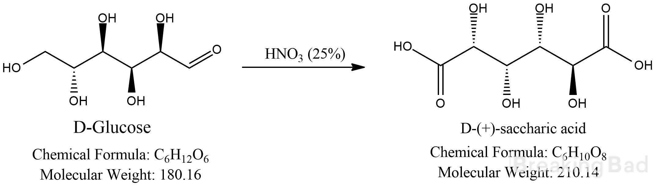

Saccharic acid or D-glucaric acid is a dicarboxylic acid C6H10O8 derived from glucose or its derivatives by oxidation with nitric acid. Saccharic acid formed the salt with d-amphetamine. This salt is a component of Adderall as a long-lasting amphetamine (Study Candy).
The synthesis process proceeds according to Scheme 1

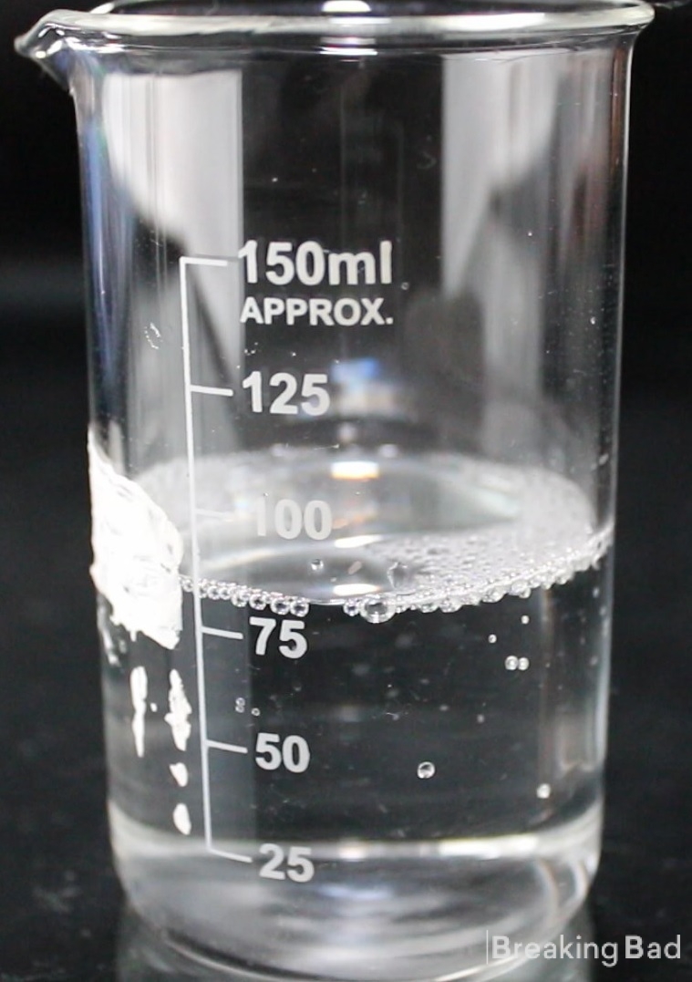

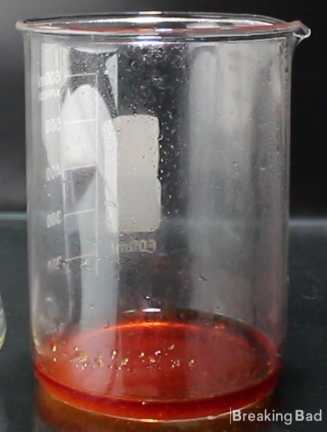

80 ml of concentrated nitric acid (~50%) is placed in to a beaker. Fig 1
PYCM4qZITi
Fig 1

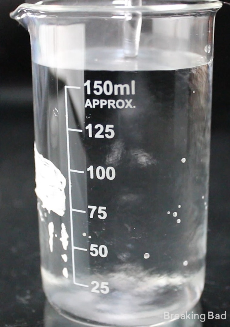

~50% nitric acid is diluted with water to 160 ml to a concentration of ~25-26% Fig 2
G6q2T0PtAN
Fig 2

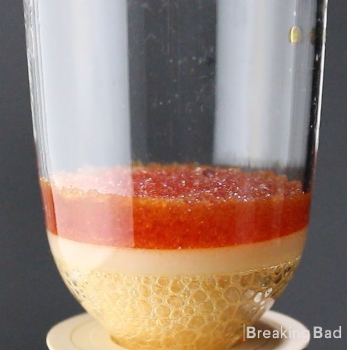

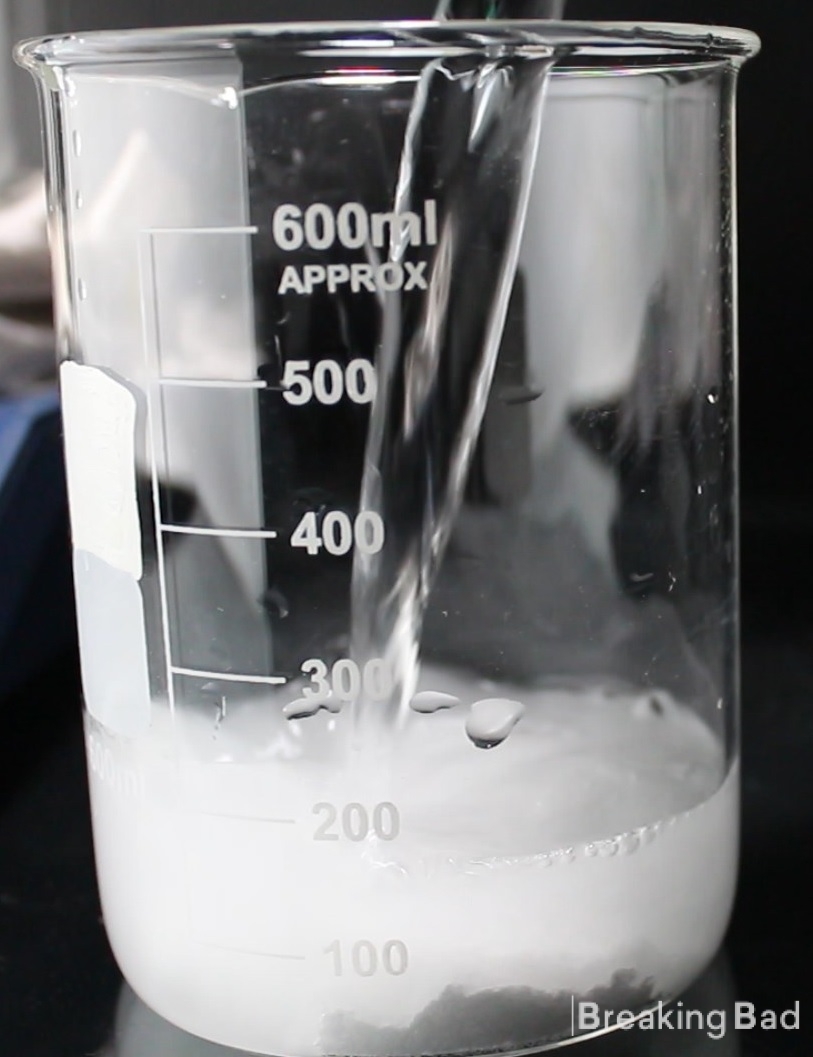

160 ml of diluted nitric acid is added to 30 g of glucose powder. Fig 3
3rL6E7wqkN
Fig 3

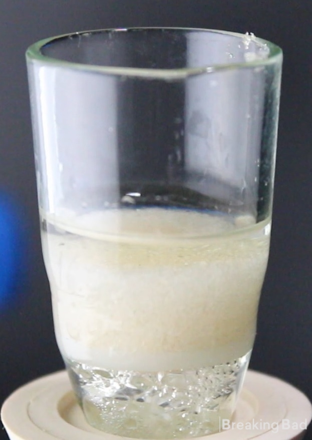

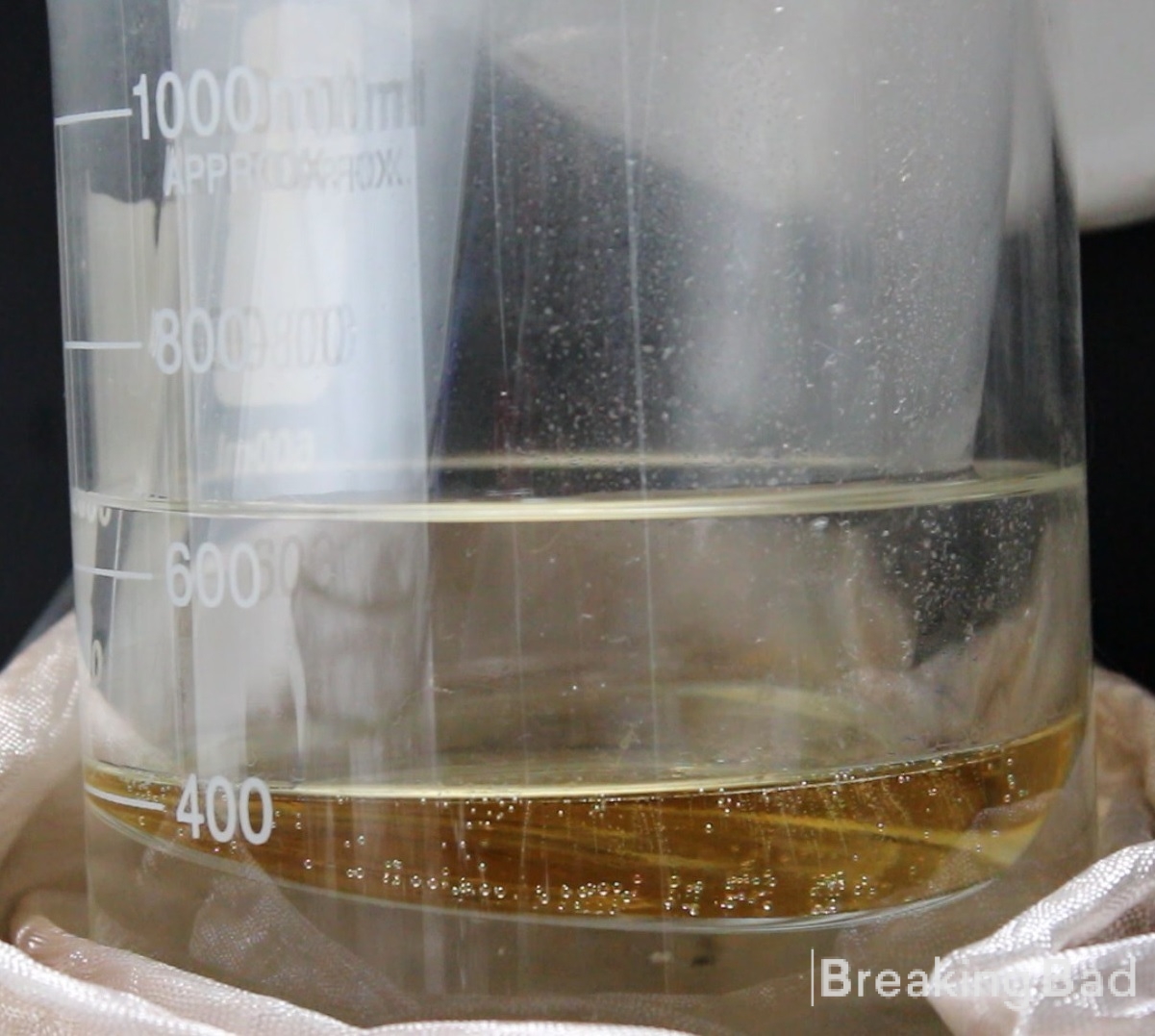

The mixture is heated and carefully evaporated on a water bath. Nitrogen oxides are formed! (Toxic brown gas!) Fig 4
5bZQLjHkFw
Fig 4

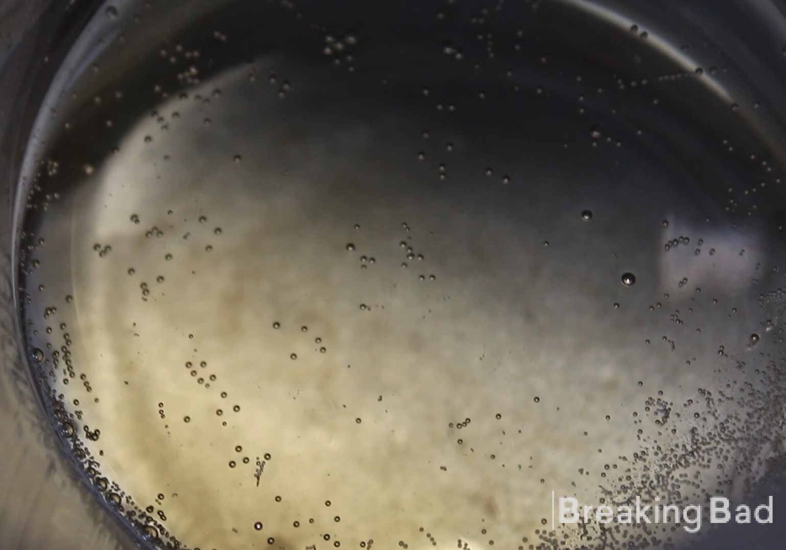

After the formation of nitrogen oxides ceases, RM evaporates to a syrupy consistency. Fig 5
FyDc2le89L
Fig 5
The syrupy RM is left to crystallize in air or in a desiccator over alkali for several days. Fig 6
QgkxRHFb1c
Fig 6
Over time, the RM may acquire a brown color, which is normal. Fig 7
31kmChf9b6
Fig 7

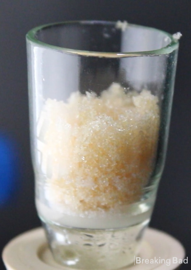

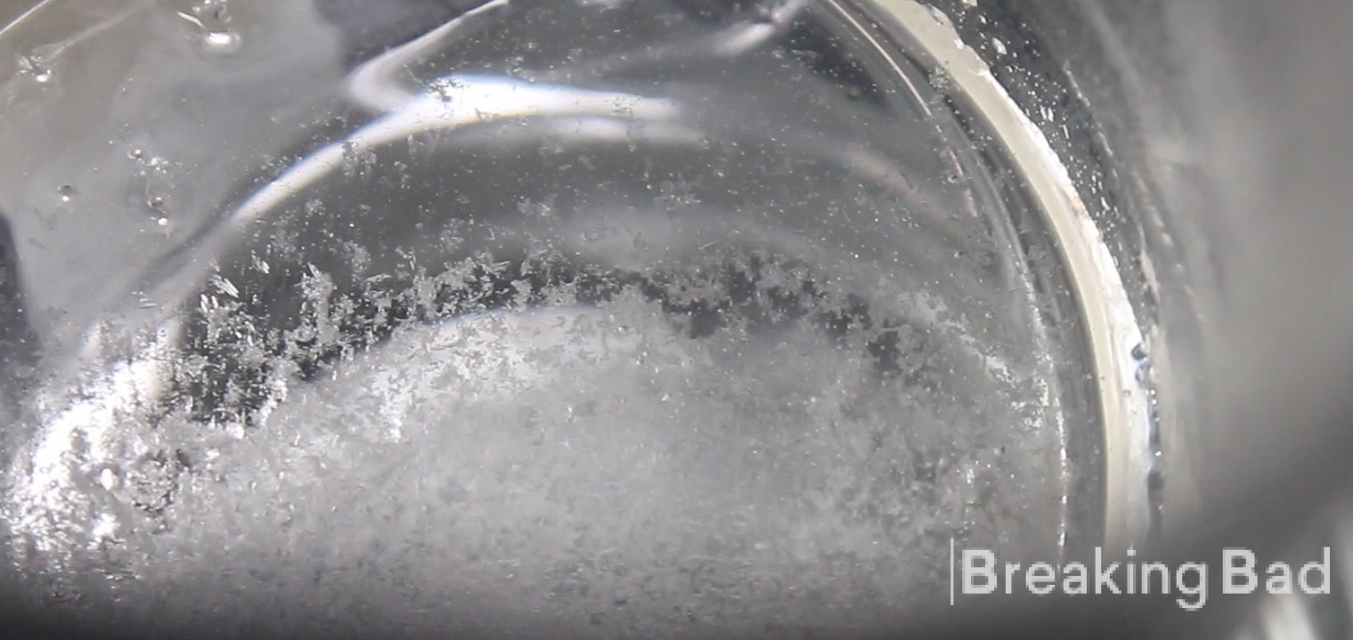

The crystals are filtered out Fig 8
R2MxIB3NLP
Fig 8

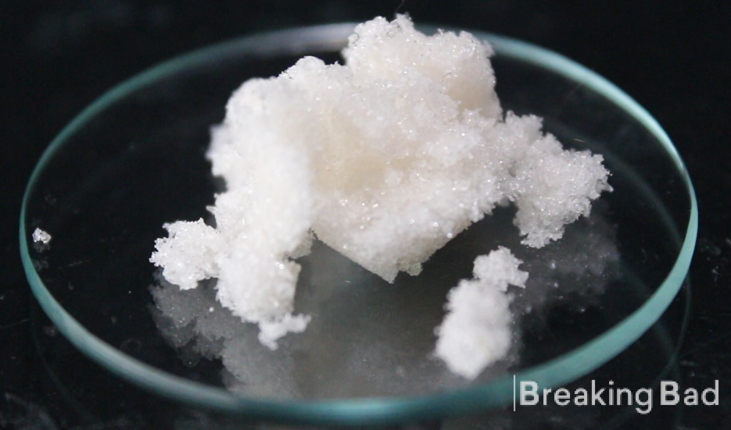

The crude crystals are transferred to a small porous filter Fig 9
COTBxilZAs
Fig 9
With the vacuum on, rinse with water in a volume of no more than 5 ml. The acid is very soluble in all solvents. Fig 10
AlLOYb8pPe
Fig 10
The crystals are dried in a desiccator over alkali. Fig 11
WRx2YbU15Z
Fig 11
Yield is 2 g
