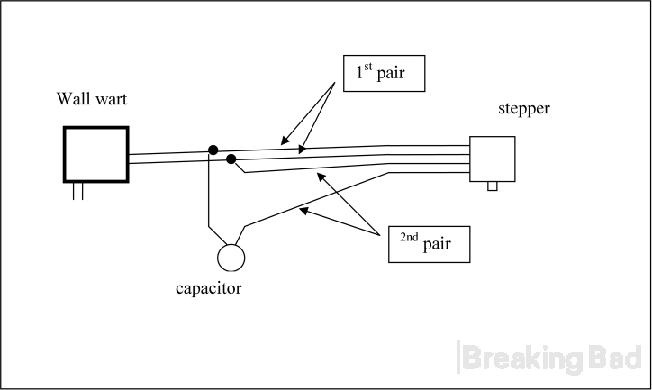

The Wiring The wiring is easy. With an ohmmeter, check the wires coming out of the stepper motor. There are two pairs where one wire is connected to the other. You need to identify the pairs. We’ll call one pair the 1st pair and the other the 2nd. (Flip a coin to decide which is which, but label them once you decide.) In Figure 1 the top two wires coming from the stepper have been designated the 1st pair. The third and forth are the 2nd. Notice that they originate from the same place, one wire leading to the second pair is connected through the capacitor. Insulate all the connections with electrical tape or shrink wrap.

Figure 1. Wiring
At this point you’re ready to test the circuit. Plug in the wall wart and the stepper motor should begin to turn. If it does not, the capacitor is probably connected to the wrong wire of the second pair, so swap them and try again.
If it still doesn’t turn you probably need a larger capacitor. If you don’t have one, add another in parallel with the first. Keep adding capacitors until the motor turns. (Don’t use tiny little ones or you may never get there.) Keep in mind that you still have to check after each attempt to ensure that the capacitor is connected to the correct wire in the second pair.

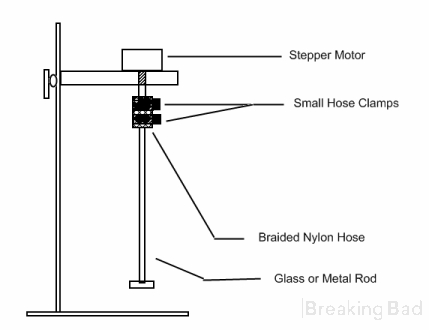

Once you’ve verified your wiring it’s time to mount the motor. Place it on top of the support to protect it from heat and fumes. You might want to build an enclosure of some sort, but make sure it’s got adequate ventilation.

Figure 2. Example Mounting
