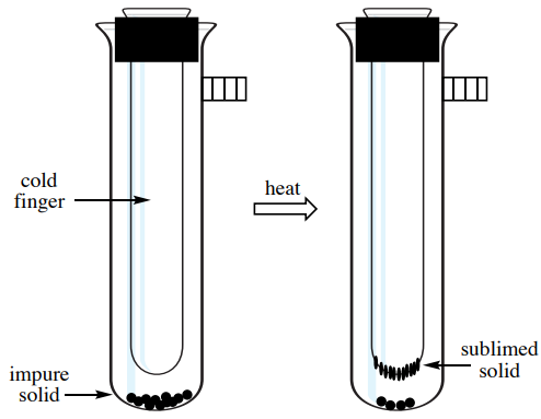

As relatively few solids are capable of sublimation, the process can be an excellent purification method when a volatile solid is contaminated with non-volatile impurities. The impure solid is heated in the bottom of a vessel in close proximity to a cold surface, called a "cold finger" (Fig. 1). As the volatile solid sublimes, it is deposited on the surface of the cold finger (where it can later be recovered), and is thus separated from the non-volatile substance left in the vessel. The process, however, is not particularly efficient at separating volatile solids from one another.

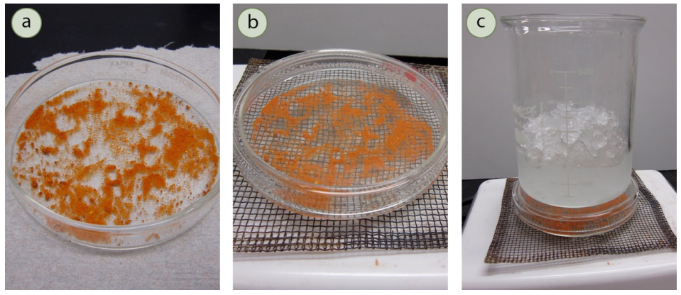

1. Spread the crude, dry solid to be sublimed in a thin layer on a "bottom" Petri dish (Fig.2 a). If chunky, first crush with a mortar and pestle. Determine the empty mass of the top Petri dish. It is important that the solid to be purified is dry: if the sample is wet with solvent, condensation may form on the top Petri dish during the sublimation. In the beginning stages of the sublimation, small amounts of condensation can be wiped off the top Petri dish with a paper towel. However, too much condensation may wash crystals off from the top dish.
2. Cover the bottom Petri dish with the top dish and set atop a wire mesh on a hotplate in the fume hood (Fig.2 b) set to the appropriate temperature (depending on the sublimation point of the compound of interest, perhaps medium low). The wire mesh helps dissipate the heat evenly to the dish and minimizes charring.
3. Place a large 600 ml beaker filled with ice water atop the Petri dish (Fig.2 c).

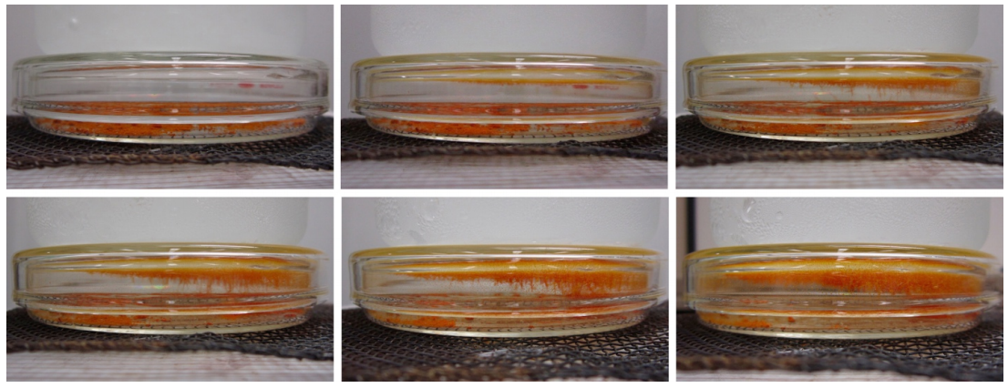

4. Over time, the sample will sublime and collect on the upper Petri dish (Fig. 3). Monitor the sublimation as compounds may char during the process (if it starts to blacken, turn down the heat). Continue the sublimation until it appears as if little (or no) solid remains on the bottom Petri dish. It is very common for crystals to also grow along the sides of the bottom dish.

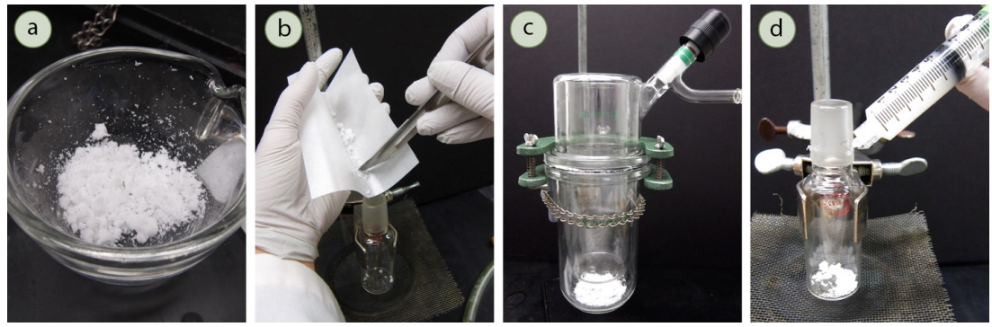

1. If the solid to be sublimated is chunky, first crush with a mortar and pestle (Fig.5 a). Then place the crude, dry solid in the bottom of the sublimation apparatus (Fig.5 b). It is important that the solid is dry: if the sample is wet with solvent, condensation may form on the cold finger during the sublimation. Too much condensation may wash crystals off the cold finger.
2. Secure the apparatus to a ring stand or latticework (Fig.5 c and d). For small scales, support the apparatus with a platform (Fig.5 d). A large scale sublimator is shown in Fig.5 c.
3. Lightly grease the joint that connects the two pieces of sublimation glassware. Grease can be easily applied with a syringe full of grease. If using ground glass, lightly grease the joint near the end that will not be in contact with the sample (Fig.5 d).
4. Insert the top piece of the sublimation apparatus (cold finger), and twist the two pieces of glassware together to spread the grease in the joint. When using ground glass, the grease should cause the bottom half of the joint to become transparent all the way around (Fig.6 a). If the entire joint becomes transparent, too much grease has been used and some should be wiped off.

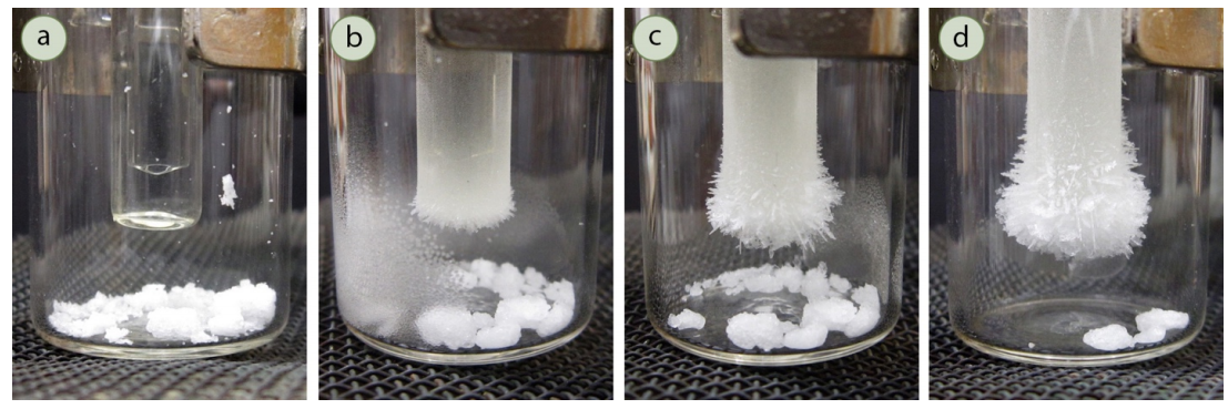

8. Over a short amount of time, solid should begin to deposit on the cold finger. It will undoubtedly also deposit on the outsides of the glassware (Fig.6 d). Solid can be coaxed away from the outside of the glassware and toward the cold finger by waving the heat gun or burner periodically up the sides of the glass.
9. Continue the sublimation until all the volatile substance is transferred from the bottom piece of glassware to the cold finger (Fig. 7). If the compound begins to darken, decrease the rate of heating to prevent decomposition.
