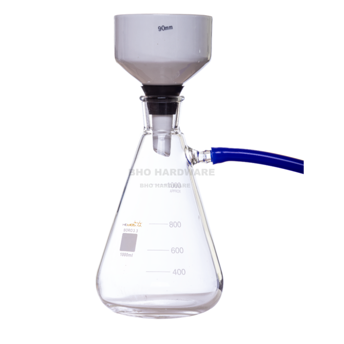

Many chemists use vacuum every day. But how do they use it? Vacuum is used for many standard applications in the preparation and processing of synthesis products. In most cases, the vacuum is not the focus, but plays an essential supporting role. The most familiar lab vacuum applications are filtration and drying. Of course, you could filter without vacuum - like brewing coffee - by letting gravity do the work for you. The problem is that, in the laboratory, the process often proves to be too slow due to the broad spectrum of solvents and solid substances. To speed up the process, low-pressure – i.e., vacuum – is created in a filter flask (Büchner flask) for Suction (vacuum) filtration.

Filtration with the aid of a chemical-resistant vacuum pump​

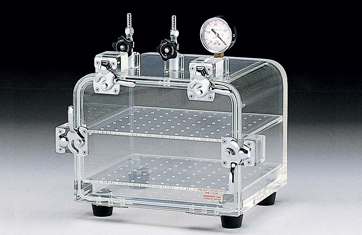

In a drying process, on the other hand, the goal is to change the state of a sample from liquid to gaseous. We could simply allow drying to happen, just as we air-dry laundry. As with filtration, this process would also take too much time, so a vacuum is used here as well to accelerate the process with help of Vacuum desiccators. Heat could be used to accomplish the same effect, but by decreasing the pressure level, less heat energy is necessary to evaporate solvents. Thus, use of vacuum makes possible the efficient drying of heat-sensitive sample materials.​

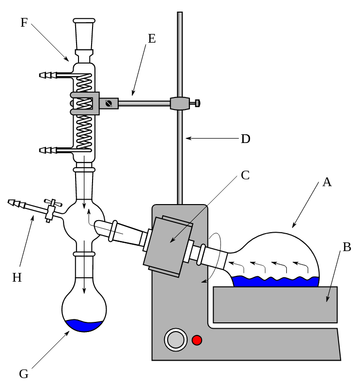

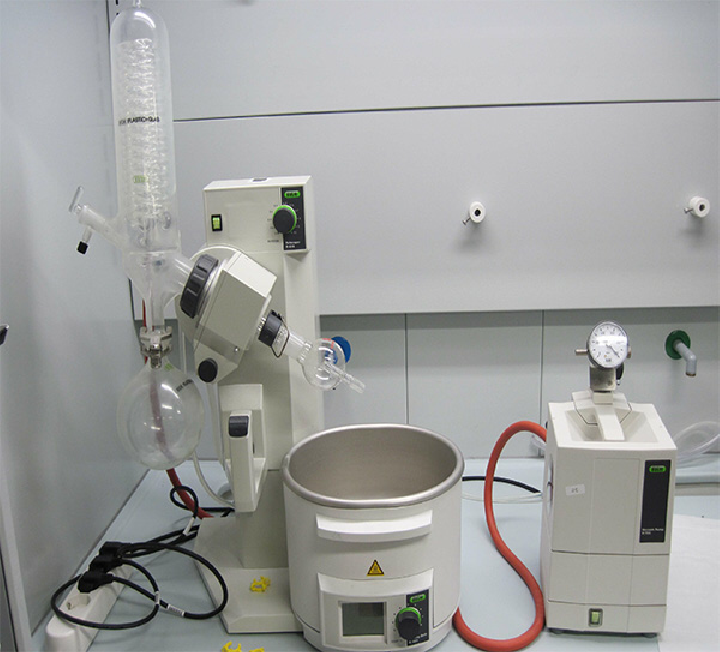

In chemistry laboratories, numerous vacuum-driven technologies are used for evaporative separation of mixtures of substances such as solvents. The best known example of this is Rotary evaporation, for which the precise control and pressure regulation impose significant requirements regarding to pump and control technology in the rough vacuum range. This equipment allows evaporating solvents quickly without intensive heating, also you can recuperate solvents after synthesis from waste.​

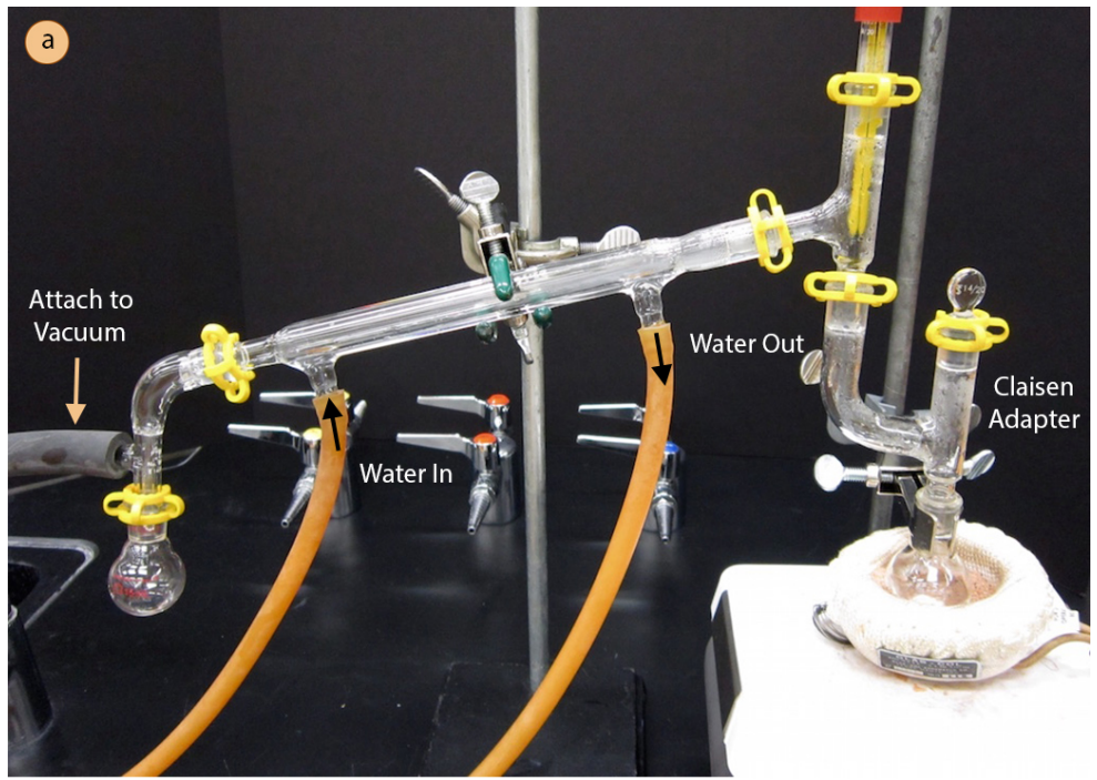

In contrast, Schlenk line and Vacuum distillation, also common in chemistry labs, demand vacuum in the fine vacuum range. This technique is used when the boiling point of the desired compound is difficult to achieve or will cause the compound to decompose. Reduced pressures decrease the boiling point of compounds.​

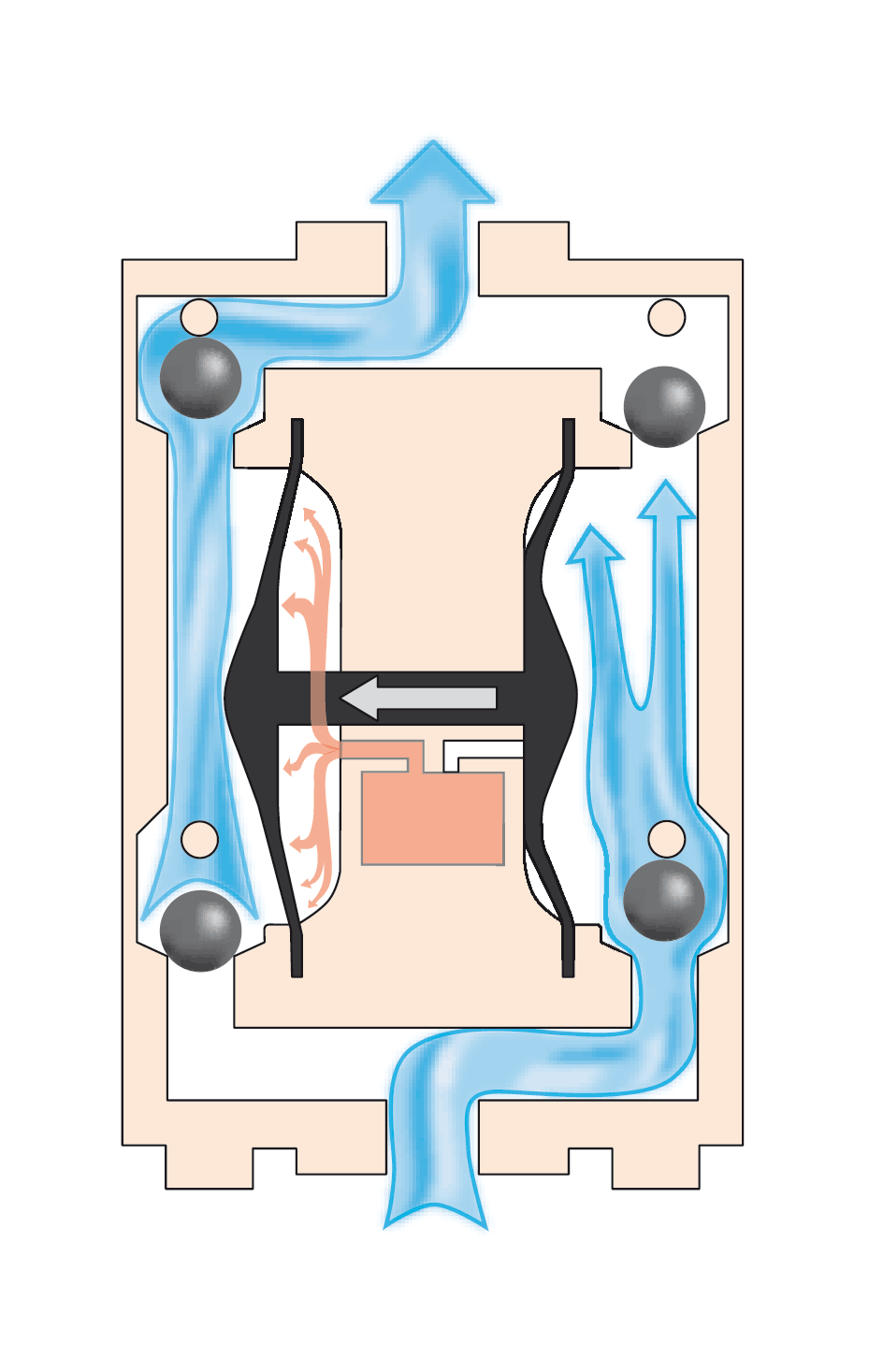

Diaphragm pumps use a flexible diaphragm and a set of check valves to produce pumping pressure and typically produce low to medium vac. They are frequently resistant to solvent and mildly corrosive vapors, making them useful for rotary evaporators, but their inability to produce high vacuum limits their utility. Diaphragm pumps often do not require oil. This type of pump may produce to 1.5 mbar vacuum. Main disadvantage is a produced noise to 50-60 dB and necessity of periodic maintenance (replacement of oil and membranes). Diaphragm pumps have cost from ~450-$500.​

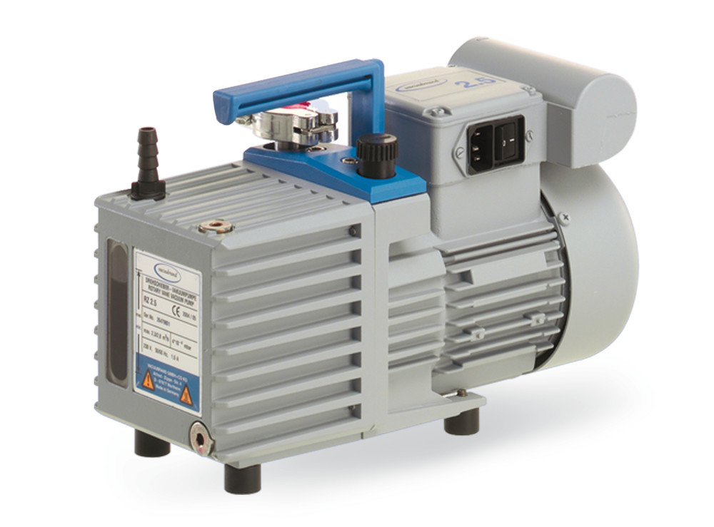

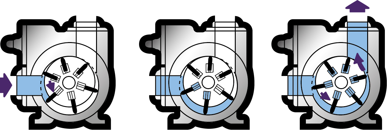

Rotary-vane pumps are also a common type of vacuum pump, with two-stage pumps able to reach pressures well below 10−6 bar. Rotary vane pumps use rotating sets of circular vanes in an elliptical cavity to create pumping pressure, and can achieve medium to high vacuum. If your pump requires oil changes, it is likely a rotary vane pump. Though they can achieve higher vacuum than diaphragm pumps, they are easily damaged by solvent or corrosive vapors. Steps must be taken to prevent harmful vapors from reaching this type of pump, such as the implementation of a cold trap, as contamination can significantly reduce a pump's efficiency and lifetime. Approximate cost from 150-$200.​

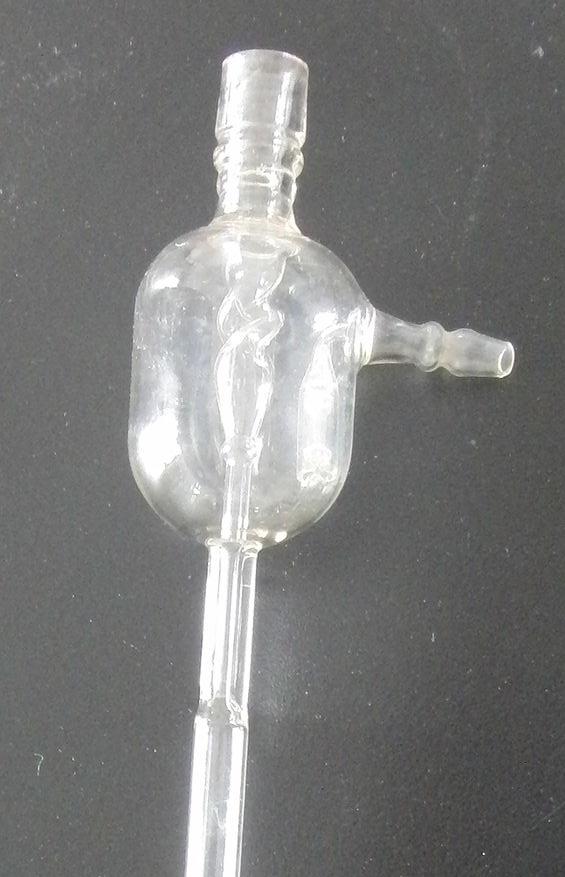

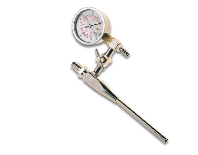

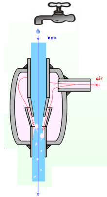

The water jet pump is a propellant jet pump in which water flows through a nozzle. A vacuum develops as a result of the high flow rate. The final vacuum to be reached depends on the water pressure and temperature (for water, 3.2 kPa or 0.46 psi or 32 mbar at 25 °C or 77 °F). If not considering the source of the working fluid, vacuum ejectors can be significantly more compact than a self-powered vacuum pump of the same capacity. Approximate cost ~25-$30. The lower the intake pressure, the more the suction capacity declines. Water jet pumps are distinguished by their very low acquisition costs and corrosion resistance. However, they are stationary. To use them, water and wastewater connections must be mounted on laboratory tables and in exhaust hoods. Because of the typical water consumption of several hundred liters per hour - a hundred thousand liters per year, even with moderate use – the water jet pumps generate high operating costs for fresh water and wastewater. Another drawback is the high noise level and the poor environmental compatibility, since all substances and solvent vapors pumped from applications go into wastewater.​

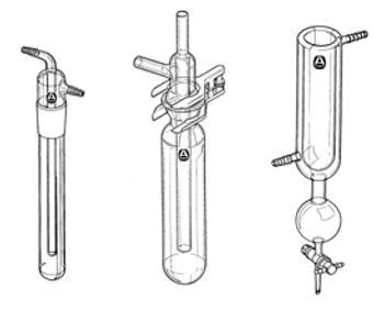

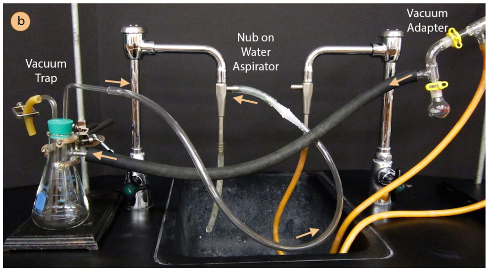

Hi, thanks for the feedback! I recommend to use 3rd trap (with bottom tap on pic below). I've used this one with oil vacuum pump.
9xPoGRDNby
JMIHQsrFyv

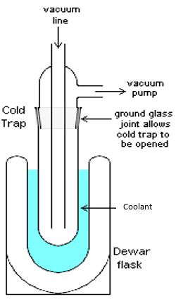

When preparing the coolant inside the dewar, add the dry ice or another cooling agent like salt ice slowly to the liquid portion; this will avoid foaming. Dry ice coolants should always be open to the atmosphere, as a closed system will cause dangerous pressure build-up. Carefully lower the trap into the dewar. If running the vacuum for long periods (30+ minutes) you may need continually to add more dry ice. Check the trap often to ensure that the collected liquid does not freeze and cause a blockage of the trap. If this occurs, you may need to switch your coolant to a higher temperature bath (e.g. ice and salt bath). When complete, remove the trap from the dewar, shut off the vacuum and slowly vent.​

The size of the cold trap is a big question as well, because the prices vary a great deal.

You can take standard size for rotavap machine. In case of big volume of evaporation solvent flask, you can use two traps sequentially. It depends on volume.

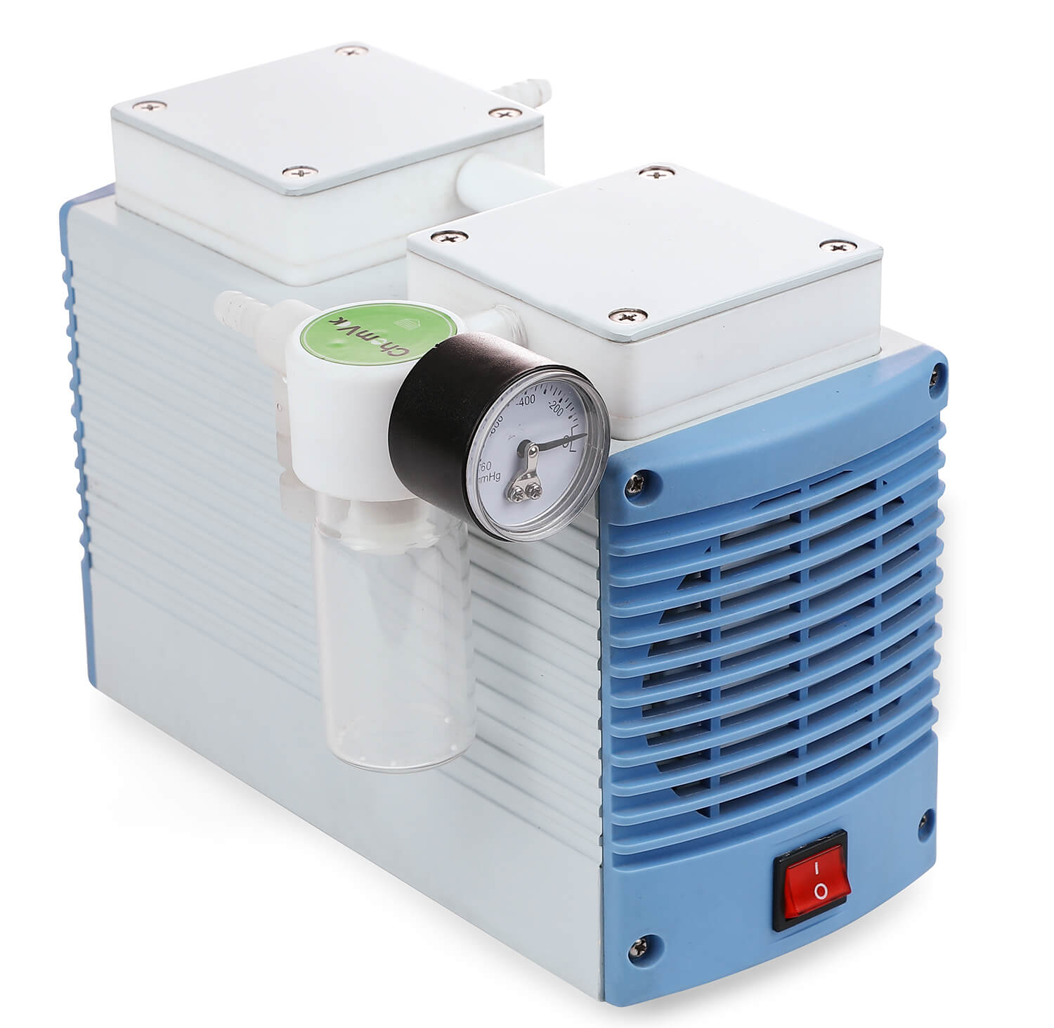

this kind of pump is ok ?
OTZjyiocm9
IuOZD3IBkj
3,077
3,531
for what?
ASheSChem
Apr 10, 2022
303
176
sory; for vacuum filtration with a buchner filter
