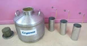

- Do not transport liquid nitrogen in wide-mouthed glass Dewars or Dewars not protected with safety tape;
- Use only approved containers. Impact resistant containers that can withstand the extremely low temperatures should be used. Materials such as carbon steel, plastic and rubber become brittle at these temperatures;
- Only store liquid nitrogen in containers with loose fitting lids (Never seal liquid nitrogen in a container). A tightly sealed container will build up pressure as the liquid boils and may explode after a short time;

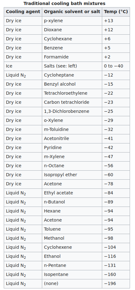

Traditional cooling baths
Water and ice baths
A bath of ice and water will maintain a temperature 0 °C, since the melting point of water is 0 °C. However, adding a salt such as sodium chloride will lower the temperature through the property of freezing-point depression. Although the exact temperature can be hard to control, the weight ratio of salt to ice influences the temperature:
- −10 °C can be achieved with a 1:2.5 mass ratio of calcium chloride hexahydrate to ice.
- −20 °C can be achieved with a 1:3 mass ratio of sodium chloride to ice.
Dry ice baths at −78 °C
Since dry ice will sublime at −78 °C, a mixture such as acetone/dry ice will maintain −78 °C. Also, the solution will not freeze because acetone requires a temperature of about −93 °C to begin freezing. Therefore, other liquids with a lower freezing point (pentane: −95 °C, isopropyl alcohol: −89 °C) can also be used to maintain the bath at −78 °C.
Dry ice baths above −77 °C
In order to maintain temperatures above −77 °C, a solvent with a freezing point above −77 °C must be used. When dry ice is added to acetonitrile, the bath will begin cooling. Once the temperature reaches −41 °C, the acetonitrile will freeze. Therefore, dry ice must be added slowly to avoid freezing the entire mixture. In these cases, a bath temperature of −55 °C can be achieved by choosing a solvent with a similar freezing point (n-octane freezes at −56 °C).
Liquid-nitrogen baths above −196 °C
Liquid-nitrogen baths follow the same idea as dry-ice baths. A temperature of −115 °C can be maintained by slowly adding liquid nitrogen to ethanol until it begins to freeze (at −116 °C).
