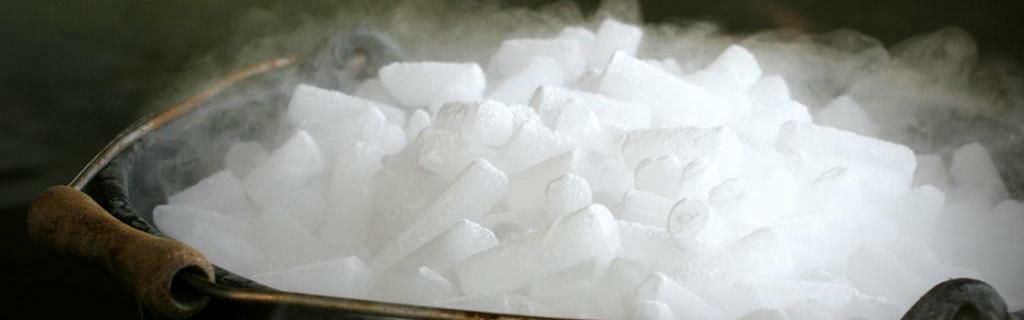

HAZARDS
Carbon Dioxide, Solid or Dry Ice is NOT considered a Hazardous Substance by the 2012 OSHA Hazard Communication Standard (29 CFR 1910.1200). The precautions associated with handling this material are as follows:
Contact Hazard: At -109 °F (-79 °C), skin contact with dry ice can lead to severe frostbite; skin cells freeze and become damaged rapidly.
Asphyxiation Hazard: Dry ice will sublime (change from solid to gas) at any temperature above -79 °C. This releases potentially substantial volumes of CO2 (1 kg solid = ~550 liters gas), which can displace oxygen quickly in the air around the dry ice, causing dizziness, headaches, difficulty breathing, loss of consciousness and death. This is especially of concern in nonventilated or confined spaces.
Overpressurization Hazard: Due to the rapid emission of large volumes of CO2 gas, any dry ice that is stored in a closed container can pressurize the container. Given enough time at normal room temperature, such a container may violently rupture if the gas is not able to escape.

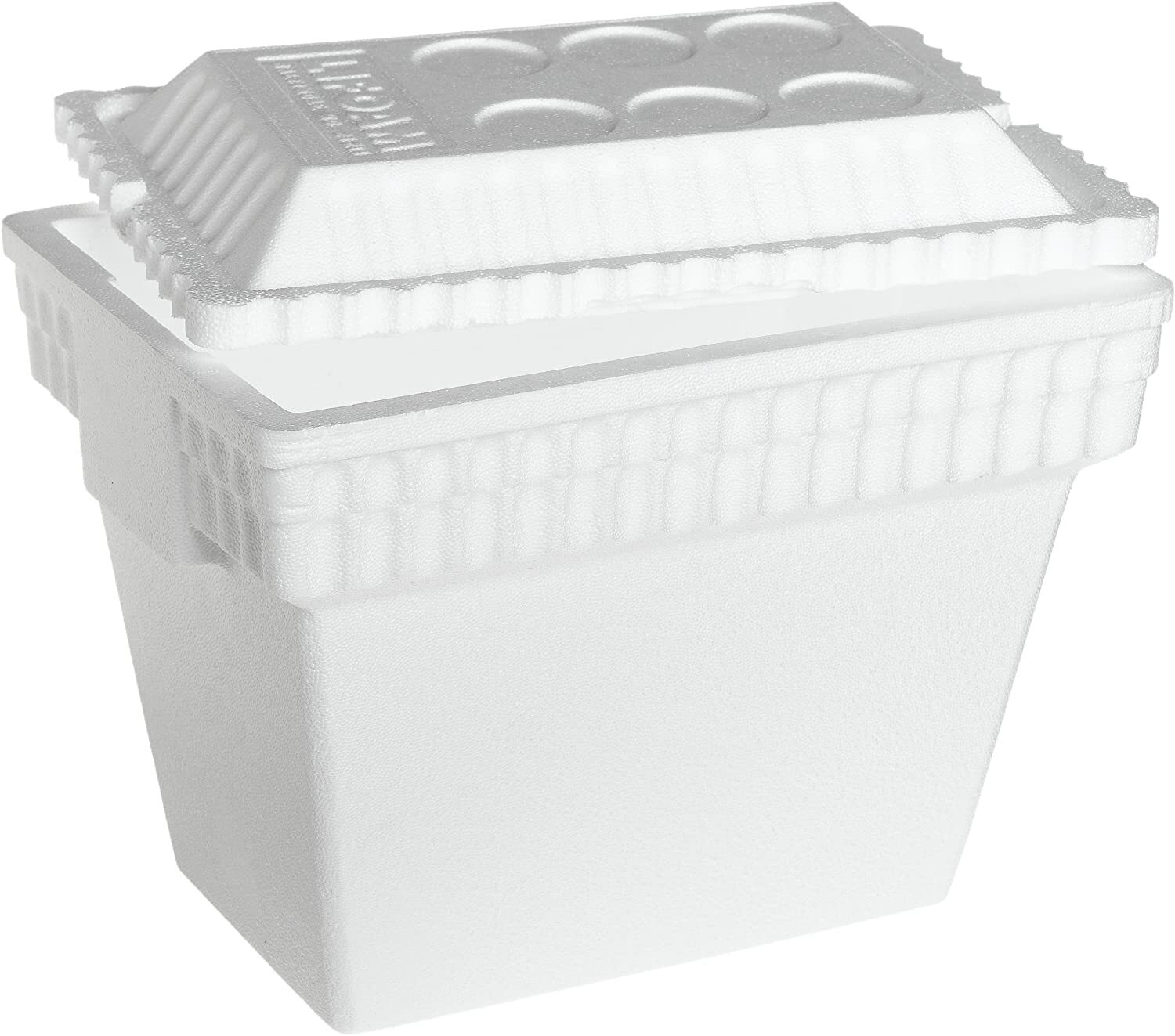

Dry ice must be stored in a Styrofoam chest, insulated cooler, or a special cooler designed for the storage of dry ice. The cooler must then be located in a well-ventilated place, such as the open lab. NEVER store coolers in closets, cabinets, refrigerators, or walk in coolers/cold rooms.
Dry ice will sublimate about five to 4.5 kg every 24 hours (blocks last longer) in a typical storage cooler. Plan on purchasing dry ice as close as possible to the time needed.

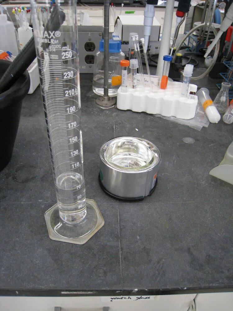

Step 1: Pick a Dewar and Measure the Solvents
For this example, I’ll be making a -20 °C bath, which requires a 30:70 ratio of MeOH to water. This Dewar holds 150 mL, so I need 100 mL of liquid. Large Dewars are more wasteful, but maintain their temperature far better.

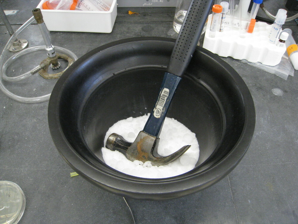

Step 2: Crush Dry Ice
You can use large chunks of dry ice, but the powder variety cools much faster. I fill the pictured plastic ice buckets, then crush the dry ice with the bottom of the hammer (not the claw or face).

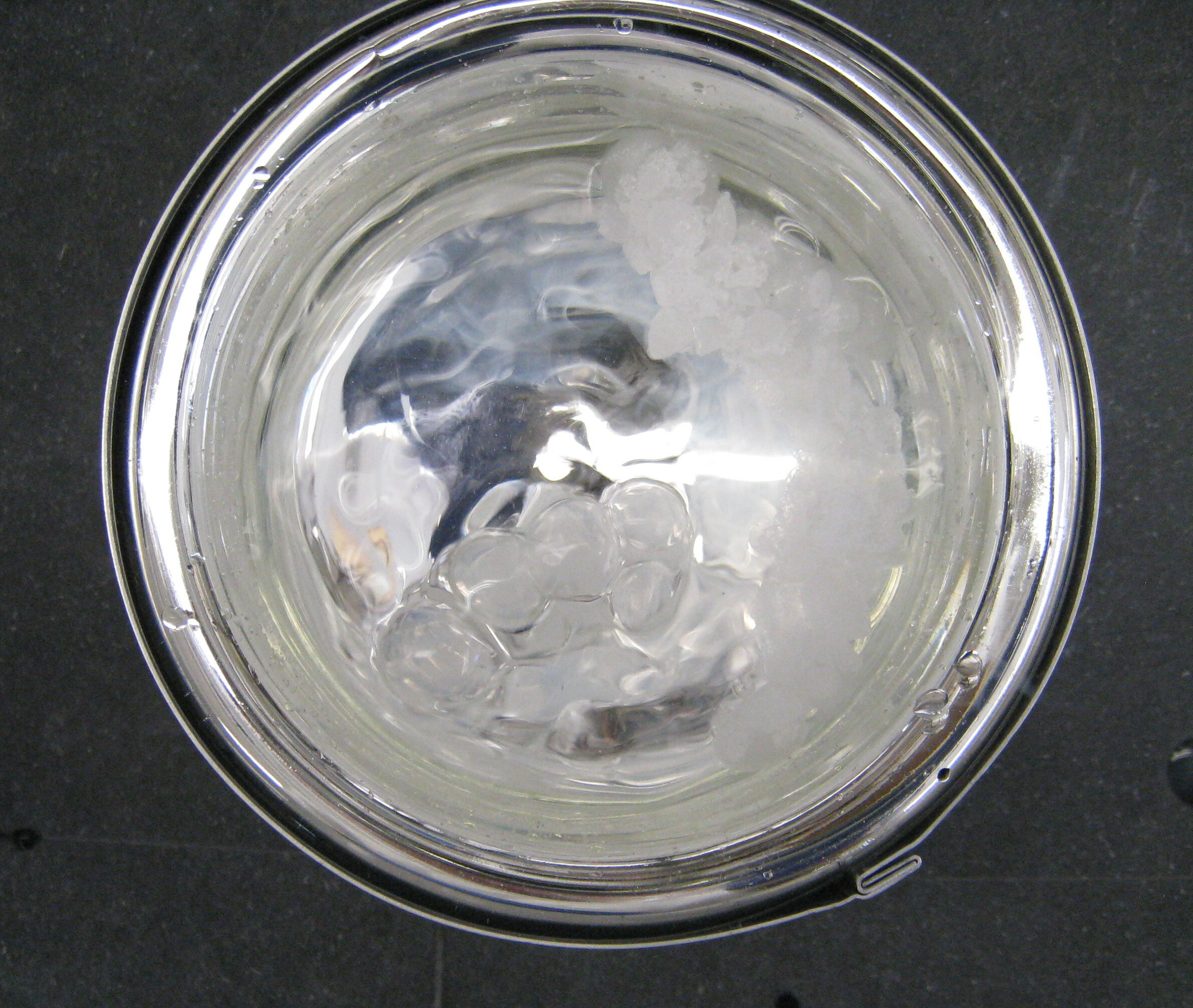

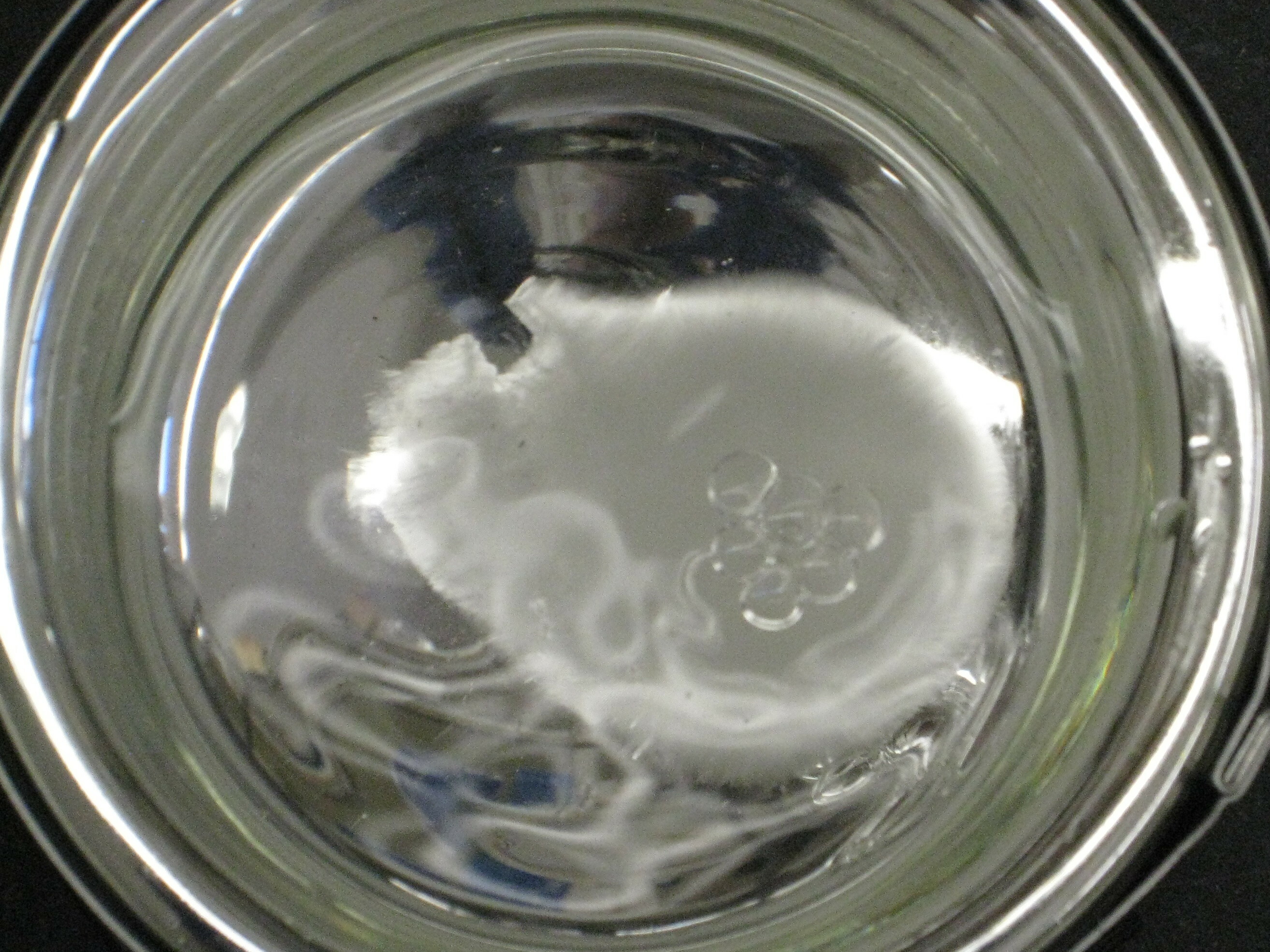

Step 6: Set and Maintain the Desired Temperature with 1-2 Pieces of Dry Ice
Chunks of dry ice about 1.5 cm x 1 cm work best. After about five minutes, you should see a fuzzy blob of ice form around the dry ice, indicating that you are at the desired temperature. When the bath starts to warm this blob, will float to the surface, and it’s time to add another piece of dry ice.
