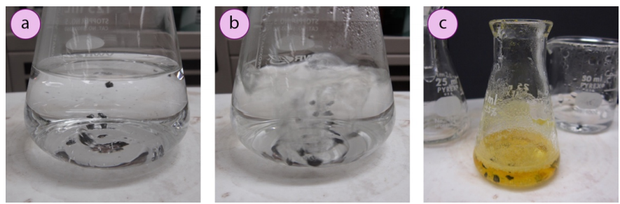

2. Add a stir bar or few boiling stones for bump prevention. Boiling stones should not be used when refluxing concentrated solutions of sulfuric or phosphoric acid, as they will colorize the solution. For example, when a stir bar is used for bump prevention with concentrated sulfuric acid, the solution remains colorless (Fig.2 b). When the same reaction is conducted using a boiling stone, the solution darkens during heating (Fig.2 c) and eventually turns the entire solution a deep purple-brown color (Fig.2 d).​
Rs70mTzANi
a) Pouring in solution, b) Reaction using a stir bar (solution is colorless),c+d) Same reaction using boiling stones​

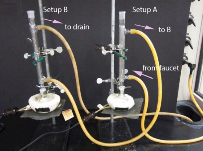

5. If multiple solutions will be refluxed at the same time (e.g. if many students are performing a reflux side by side), the hoses from each reflux setup can be connected in series (Fig. 4). To accomplish this, the upper arm of "Setup A" which normally drains to the sink is instead connected to the lower arm of "Setup B." The upper arm of Setup B then drains to the sink. Connecting apparatuses in series minimizes the use of water, as water exiting one condenser enters the next. Several reflux setups can be connected in series, and the water flow should be monitored to ensure that all setups are adequately cooled.​
Z8LvdtpHiN
6. Begin circulating a steady stream of water through the hoses (not so strong that the hose flops around from the high water pressure). Check again that the pieces of glassware securely fit together, then position the heat source under the flask. Turn on the stirring plate if using a stir bar.​

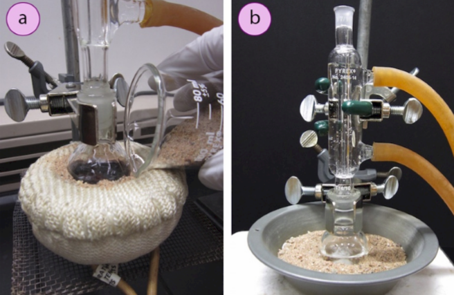

a) If using a heating mantle, hold it in place with an adjustable platform (e.g. a wire mesh / ring clamp). Allow a few inches below the mantle so when the reaction is complete, the mantle can be lowered and the flask cooled. If the heating mantle is not a perfect fit for the size of the round bottomed flask, surround the flask with sand to create a better contact (Fig.5 a).​
b) If using a sand bath, bury the flask in the sand so that the sand is at least as high as the level of liquid in the flask (Fig.5 b).​
c) If the setup will eventually be left unattended for a long period of time (e.g. overnight), tighten copper wire over the hose attachments to the condenser to prevent changes in water pressure from causing them to pop off.​
3WoOMVfUCN
a) Filling a heating mantle with sand to ensure a perfect fit, b) Heating a reflux apparatus with a sand bath.​

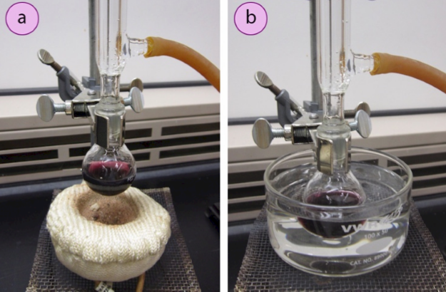

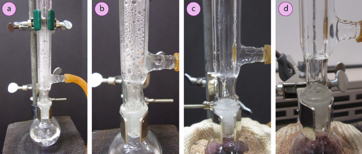

7. If the heat source was preheated (optional), the solution should begin to boil within five minutes. If it does not, increase the rate of heating. The appropriate heating rate occurs when the solution is vigorously boiling and a "reflux ring" is seen roughly one-third of the way up the condenser. A "reflux ring" is the upper limit of where hot vapors are actively condensing. With some solutions (e.g. aqueous solution), the reflux ring is obvious with easily visible droplets in the condenser (Fig.6 a+b). With other solutions (e.g. many organic solvents) the reflux ring is subtler, but can be seen with close observation (Fig.6 c). Subtle movement may be seen in the condenser as liquid drips down the sides of the condenser, or background objects may appear distorted from refraction of light through the condensing liquid (in Fig.6 d, the ring stand pole is distorted).​
IHjKsYrfFp
A+b) Condensation seen in the condenser when refluxing water, c) Reflux ring of ethanol seen subtly in the bottom third of the condenser, d) Distortion of the ring stand in the condenser due to the refluxing ethanol solution​
8. If following a procedure in which you are to reflux for a certain time period (e.g. "reflux for one hour"), the time period should begin when the solution is not just boiling but actively refluxing in the bottom third of the condenser.
9. The heat should be turned down if the reflux ring climbs to go half-way up the condenser or higher, or else vapors could escape the flask.
10. After the reflux is complete, turn off the heat source and remove the flask from the heat by either lifting the reflux apparatus up, or dropping the heat source down (Fig.7 a).​
NPZ9ihwp6O
a) Raising the flask to cool, b) Cooling quickly in tap water bath​

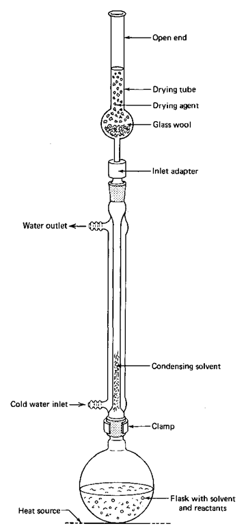

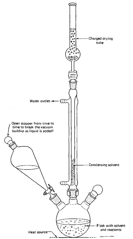

Dry reflux.​
If you have to keep the atmospheric water vapor out of your reaction, you must use a drying tube and the inlet adapter in the reflux setup (Fig. 8). You can use these if you need to keep water vapor out of any system, not just the reflux setup.​
Mu7OcA9bHt
1. If necessary, clean and dry the drying tube. You don’t have to do a thorough cleaning unless you suspect that the anhydrous drying agent is no longer anhydrous. If the stuff is caked inside the tube, it is probably dead. You should clean and recharge the tube at the beginning of the procedure. Be sure to use anhydrous calcium chloride or sulfate. It should stay okay in few usages. If you are fortunate, indicating Drierite, a specially prepared anhydrous calcium sulfate, might be mixed in with the white Drierite. If the color is blue, the drying agent is good; if red, the drying agent is no longer dry, and you should get rid of it (see Desiccants in “Vacuum desiccators”).
2. Put in a loose plug of glass wool or cotton to keep the drying agent from falling into the reaction flask.
3. Assemble the apparatus as shown, with the drying tube and adapter on top of the condenser.
4. At this point, reagents may be added to the flask and heated with the apparatus. Usually, the apparatus is heated while empty to drive water off the walls of the apparatus.
5. Heat the apparatus, typically empty, on a steam bath, giving the entire setup a quarter-turn every so often to heat it evenly. A burner can be used if there is no danger of fire and if heating is done carefully. The heavy ground glass joints will crack if heated too much.
6. Let the apparatus cool to room temperature. As it cools, air is drawn through the drying tube before it hits the apparatus. The moisture in the air is trapped by the drying agent.
7. Quickly add the dry reagents or solvents to the reaction flask, and reassemble the system.
8. Carry out the reaction as usual as a standard reflux.​

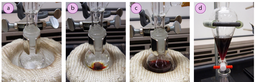

Addition and reflux.​
Every so often you have to add a compound to a setup while the reaction is going on, usually along with a reflux. Well, you don’t break open the system, let toxic fumes out, and make yourself sick to add new reagents. You use an addition funnel. Now, we talked about addition funnels back with separatory funnels (Laboratory glassware) when we were considering the stem, and that might have been confusing.
Funnel use.
Look at Fig.9 a. It is a true sep. funnel. You put liquids in here and shake and extract them. But could you use this funnel to add material to a setup? No. No ground glass joint on the end; and only glass joints fit glass joints. Fig.9 c shows a pressure-equalizing addition funnel. Remember when you were warned to remove the stopper of a separatory funnel, so you wouldn’t build up a vacuum inside the funnel as you emptied it? Anyway, the sidearm equalizes the pressure on both sides of the liquid you’re adding to the flask, so it’ll flow freely, without vacuum buildup and without you having to remove the stopper. This equipment is very nice, very expensive, very limited, and very rare. And if you try an extraction in one of these, all the liquid will run out the tube onto the floor as you shake the funnel. So, a compromise was reached (Fig.9 b). Since you’ll probably do more extractions than additions, with or without reflux, the pressure-equalizing tube went out, but the ground glass joint stayed on. Extractions; no problem. The nature of the stem is unimportant. But during additions, you’ll have to take the responsibility to see that nasty vacuum buildup doesn’t occur. You can remove the stopper every so often or put a drying tube and inlet adapter in place of the stopper. The latter keeps moisture out and prevents vacuum buildup inside the funnel.
How to Set Up
There are at least two ways to set up an addition and reflux, using either a three-neck flask or a Claisen adapter. I thought I’d show both these setups with drying tubes. They keep the moisture in the air from getting into your reaction. If you don’t need them, do without them.​
W96jaHUiAO
Separatory funnels in triplicate, a) Plain, b) Compromise separator addition funnel, c) Pressure-equalizing addition funnel
8RACNgHJFf
Zs73tMVwY0

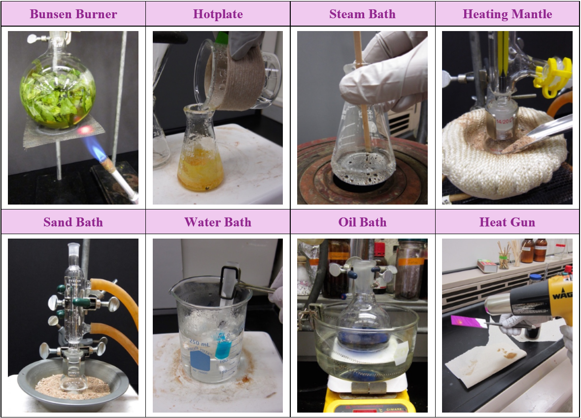

Heating methods and flammability:​
  • In some contexts, the choice of what heat source to use is critical, while in other contexts several could work equally well. The choice of which heat source to use depends on several factors:​
  • Availability (does your institution own the equipment?)​
  • Rate of heating (do you want to heat gradually or quickly?)​
  • Flexibility of heating (does the heat need to be waved around an apparatus?)​
  • Final temperature required (low boiling liquids require a different approach than high boiling liquids)​
  • Flammability of the content​
L6Po1pZty5

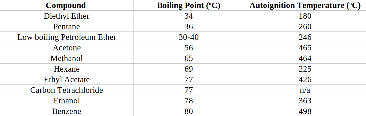

As safety is an important factor in making laboratory choices, it's important to consider the flammability of the liquid to be heated. Almost all organic liquids are considered "flammable," meaning they are capable of catching on fire and sustaining combustion (an important exception is that halogenated solvents tend to be non-flammable). However, this doesn't mean that all organic liquids will immediately ignite if placed near a heat source. Many liquids require an ignition source (a spark, match, or flame) in order for their vapors to catch on fire, a property often described by the liquid's flash point. The flash point is the temperature where the vapors can be ignited with an ignition source. For example, the flash point of 70% ethanol is 16.6 ℃, meaning it can catch on fire at room temperature using a match. A Bunsen burner is an excellent ignition source (and can reach temperatures of approximately 1500 ℃), making burners a serious fire hazard with organic liquids, and a heat source that should often be avoided.
Another important property in discussing flammability is a liquid's autoignition temperature: the temperature where the substance spontaneously ignites under normal pressure and without the presence of an ignition source. This property is particularly insightful because it does not require a flame (which is frequently avoided in the organic lab), but only a hot area. A hotplate surface turned up to "high" can reach temperatures up to 350 ℃. Safety note: as diethyl ether, pentane, hexane, and low-boiling petroleum ether have autoignition temperatures below this value (Fig.14), it would be dangerous to boil these solvents on a hotplate as vapors could spill out of the container and ignite upon contact with the surface of the hotplate. In general, caution should be used when using a hotplate for heating any volatile, flammable liquid in an open vessel as it's possible that vapors can overrun the hotplate's ceramic covering and contact the heating element beneath, which may be hotter than 350oC. It is for this reason that hotplates are not the optimal choice when heating open vessels of volatile organic liquids, although in some cases they may be used cautiously when set to "low" and used in a well-ventilated fume hood.​
N6Crl2k5Pu
As combustion is a reaction in the vapor phase, liquids with low boiling points (< 40 ℃) tend to have low flash points and autoignition temperatures as they have significant vapor pressures (Fig.12). All low boiling liquids should be treated more cautiously than liquids with moderate boiling points (> 60 ℃).​

2.13 HEATING OF REACTION MIXTURES
Heating of aqueous solutions is most conveniently carried out using a Bunsen
burner with the glass vessel suitably supported on a tripod and ceramic-centred
gauze; it is essential to use a heat resistant bench mat, and under no circum-
stances should such apparatus be left unattended. It is also imperative that no
other worker using flammable solvents is in the vicinity.
In the case of solutions of flammable liquids having a boiling point below
100 °C, the stainless steel electrically-heated water bath or steam bath provided
with a constant-level device must be used. The individual circular type is pro-
vided with a series of concentric rings in order to accommodate flasks and
beakers of various sizes. A rectangular type, suitable for use in student classes,
has several holes each fitted with a series of concentric rings. In both cases the
water bath is fitted with an immersion heating element controlled by a suitable
regulator.
For temperatures above 100 °C, oil baths are generally used.
For temps above 100 C oil baths are used. Medicinal paraf-
fin may be employed for temperatures up to about 220 °C. Glycerol and dibutyl
phthalate are satisfactory up to 140-150 °C; above these temperatures fuming is
usually excessive and the odour of the vapours is unpleasant.
For temperatures
up to about 250 °C, 'hard hydrogenated' cottonseed oil, m.p. 40-60 °C, is recom-
mended: it is clear, not sticky and solidifies on cooling; its advantages are there-
fore obvious. Slight discoloration of the 'hard' oil at high temperature does not
affect its value for use as a bath liquid. The Silicone fluids, e.g. Dow Corning 550,
are probably the best liquids for oil baths but are somewhat expensive for
general use. This Silicone fluid may be heated to 250 °C without appreciable loss
or discoloration. Oil baths should be set up in the fume cupboard wherever pos-
sible. A thermometer should always be placed in the bath to avoid excesive heat-
ing. Flasks, when removed from an oil bath, should be allowed to drain for
several minutes and then wiped with a rag. Oil baths may be heated by a gas
burner but the use of an electric immersion heater is safer and is to be preferred.
A satisfactory bath suitable for temperatures up to about 250 °C may be pre-
pared by mixing four parts by weight of 85 per cent ortho-phosphoric acid and
one part by weight of meta-phosphoric acid; the mixed components should first
be heated slowly to 260 °C and held at this temperature until evolution of steam
and vapours has ceased. This bath is liquid at room temperatures. For tempera-
tures up to 340 °C, a mixture of two parts of 85 per cent ortho-phosphoric acid
and one part of meta-phosphoric acid may be used: this is solid (or very viscous)
at about 20 °C.
High temperatures may be obtained also with the aid of baths of fusible metal
alloys, e.g. Woods metal - 4 parts of Bi, 2 parts of Pb, 1 part of Sn and 1 part of
Cu - melts at 71 °C; Rose's metal - 2 of Bi, 1 of Pb and 1 of Sn - has a melting
point of 94 °C; a eutectic mixture of lead and tin, composed of 37 parts of Pb and
63 parts of Sn, melts at 183 °C. Metal baths should not be used at temperatures
much in excess of 350 °C owing to the rapid oxidation of the alloy. They have the
advantage that they do not smoke or catch fire; they are, however, solid at ordin-
ary temperature and are usually too expensive for general use. It must be

An air bath is a very cheap and convenient method of effecting even heating
of small distillation flasks (say, 25 ml or 50 ml), where the use of a micro Bunsen
burner, results in fluctuations in the level of heating due to air draughts. It may
be readily constructed from two commercial tin cans (not aluminium) (those from tinned fruit or food are quite suitable), of such sizes that one fits into the other to provide a small concentric gap as an air insulator. The cleaned large can
is cut to the same height as the small can, and the base is then removed. The cleaned smaller can has a number of holes punched in the base. The edges of
both cans must be smoothed and any ragged pieces of metal removed. A circular
piece of ceramic paper (1 mm thickness) of the same diameter of the smaller can
is inserted over the holes. A piece of reinforced calcium silicate matrix (6 mm
thickness) of diameter slightly greater than the larger can is then obtained and a
hole of suitable diameter made in its centre; the sheet is than cut diametrically.
The two halves which constitute the cover of the air bath, will have the shape
shown in Fig. 2.46{b). The diameter of the hole in the lid should be approxim-
ately equal to the diameter of the neck of the largest flask that the air bath will
accommodate. The air bath, supported on a tripod and wire gauze, is heated by
means of a Bunsen burner; the position of the flask, which should be clamped, is
shown in Fig. 2.46(a). The flask should not, as a rule, rest on the bottom of the
bath. The advantages of the above air bath are: (a) simplicity and cheapness of
construction; (b) ease of temperature control; (c) rapidity of cooling of contents
of the flask either by removing the covers or by completely removing the air
bath; and (d) the contents of the flask may be inspected by removing the covers.
Heating mantles provide one of the most convenient means of controlled
heating of reaction vessels. They consist of a heating element enclosed within a
knitted glass-fibre fabric which is usually protected with a safety earth screen
(Fig. 2.47(a), Electrothermal Engineering). The heating unit is enclosed within
an outer rigid housing (often of polypropylene or aluminium) which is appro-
priately insulated so that the mantle may be handled at a low outer case temper-
ature. Heating control is by in-built or external energy regulators. Fixed sizes for
round-bottomed flasks having capacities from 50 ml to 5 litres are standard (e.g.
Fig. 2.47(fr), Isopad). In addition a multipurpose unit is now available which will
accept a variety of different sized flasks of round-bottomed or pear-shaped
design (Fig. 2.47(c), Electrothermal Engineering); this unit has a bottom outlet
to accept 60° angle funnels to be heated in hot nitrations, in which case only the
lower section of the heating element need be activated. Further designs of
mantle (Electrothermal Engineering) are the fully enclosed flexible heating
mantle with elastic neck entry which is often convenient when the apparatus as-
sembly does not allow the satisfactory support of the encased type, and the heat-
ing mantle with in-built stirrer (Fig. 2.47(d)). Other manufacturers are Glas-Col
and Thermolyne Corp, and the units are available through Aldrich Chemical
Co. Ltd.
Electric hot plates may also be employed in the case of flat-bottomed vessels,
and are provided with suitable energy regulators. Various sizes are available for
individual use or for groups of students. The heating surface may be either cast-
iron aluminium-sprayed, or a glass-ceramic surface. In the former case it is often
advisable to interpose a sheet of ceramic paper between the metal top and the
vessel to be heated, particularly if the contents of the latter are liable to 'bump'.
Electic hot plates should not be used with low boiling, flammable liquids {e.g. ether,
light petroleum, etc.) contained in open beakers since ignition can frequently occur
when the heavier vapour spills on to the heated surface.
